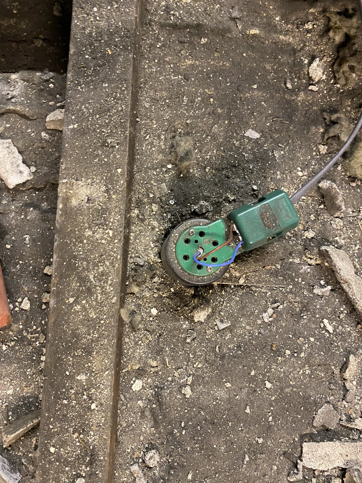

Do I need covers to go over LED downlights/spotlights that are in the loft, for the ceiling below.
I am insulating the loft with 100mm between the joists and 200mm across the joists
Is it also safe to cover cables with the insulation?

Fire-rated LED downlights are widely available and should be safe to cover over with insulation, but you might have heat dissapation issues that could shorten the life of the bulbs.
I would put covers over them. Better to be safe than sorry.

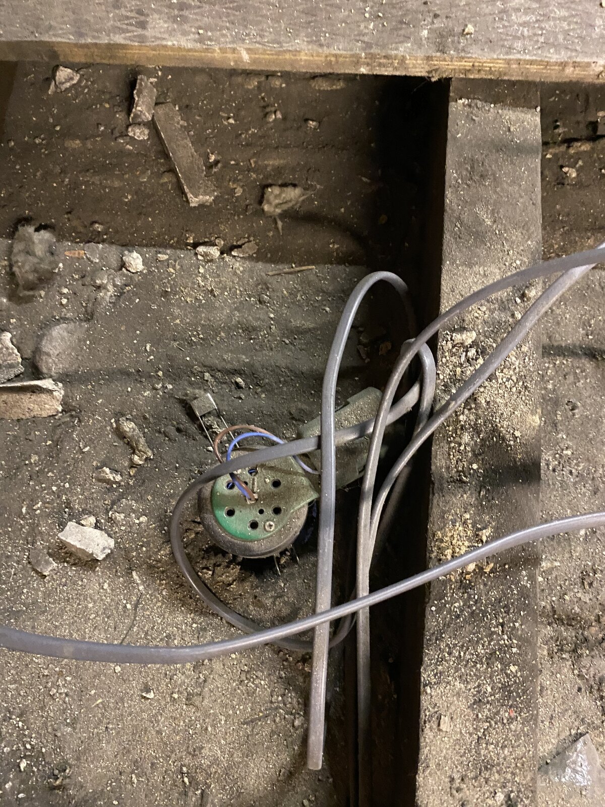

Now I’ve exposed them more, they’re too close to the joists to put protectors over them
What’s my choices? Just cover them with insulation and hope for the best?
The dimensions of the covers suggest otherwise? One of the lights is effectively touching the joist? (First pic)
You can make your own covers by making a lid and sides out of plasterboard, which is fireproof.
