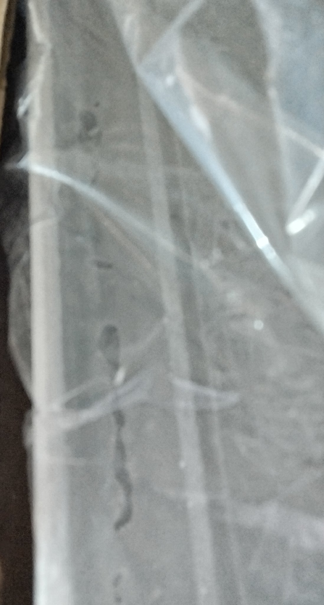

Hi I have an acrylic bath to fit. It's a cask acrylic one. I have fit the acrylic ones before with timbre around the baths lip and a cradle for the legs. This one has a metal plate that screws into the bottom of the bath for the legs, no cradle. Also there is no timber around the baths side lips. I was planning on fitting a batten to the wall to fix the bath to do i just do this so the external lip rests on the batten attached to the wall?
Thats what under the baths lip looks like
The baths I have done before have had a pre install timber batten under the bath lip. This then sat on the batten I had fixed to the wall. Has anyone fit acrylic ones that don't have any pre installed timber under the bath lip?
Yes, I’ve done it a few times before, including on metal baths.
Thanks apparently it's a more expensive bath then the ones with the timber built under the lip. It does feel solid. How does the panel usually attach to these? On the others I used to slide the top lip of the bath panel in between the front lip of the bath and the attached timber. Thanks
Sometimes a timber frame is required, or special clips come with the panel/bath.
Wonder if there are clips that come with the bath legs kit
But imagine they would have to screw into the under side of the lip which would only be 5mm ish
Just because there isn't a baton under the lip of the bath doesn't mean you can't add one, if needed and there's space, just use a bit of polymer adhesive and leave it 24hrs.
Thanks I think it will be ok rested up against the batten on the wall. Just unsure on fitting the panel
