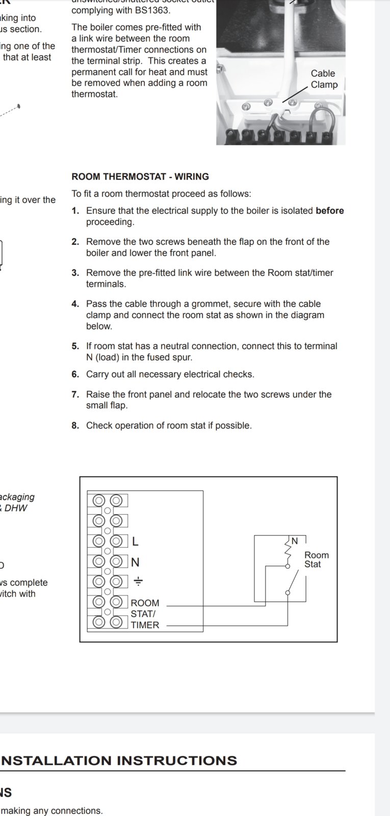

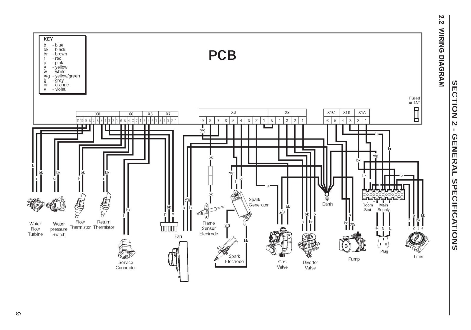

Hi, I would like to add a thermostat to my caravan boiler. The boiler is a morco gb24. It has connectivity for a thermostat but I'm not sure what wiring diagram from nest I should use. I think taking L and N from boiler to nest heatlink and then two wires from the boiler thermostat connection to the low voltage ports on the nest heatlink would be correct but I don't know, can anyone help? Images attached are from the boiler manual

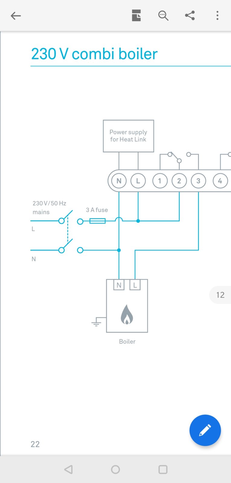

I think I need to use the 230v combi diagram as shown below.
To connect I think wiring would be: 4 core cable, l & n joined boiler to heatlink, link wire between live and
, wire from boiler port marked timer to heatlink normally open port 3
your boiler doesnt support OT so you would be better with the Nest E it is battery powered and only has 2 terminals No and com and the two wires at the thermostat connections on the boiler connect to these ports or a single channel hive if you want a mains powered heatlink, that nest you are suggesting can be used but not as easy as you think to wire it up and you want get any extra functions using that as opposed to the others

I know you dont have an existing thermostat, you just fit the receiver near the boiler and run a 2 core flex to it
Thanks very much, one final question, is there anyway to identify common and normally open?
yes they are clearly marked the nest e only has the two terminals and it doesnt matter which way round the wires go, it has two other terminals marked OT but your boiler doesnt support this so just forget they are there
So as there is no current stat, just two core flex from boiler to heat link and if it doesn't work switch the wires e.g. blue wire to co brown to no, if doesn't work then brown to co and blue to no?
yes exactly just two wires doesnt matter which way round it is just a switch, will work either way round, you will have to leave the timer on the boiler set to constantly on and let the Nest override it
