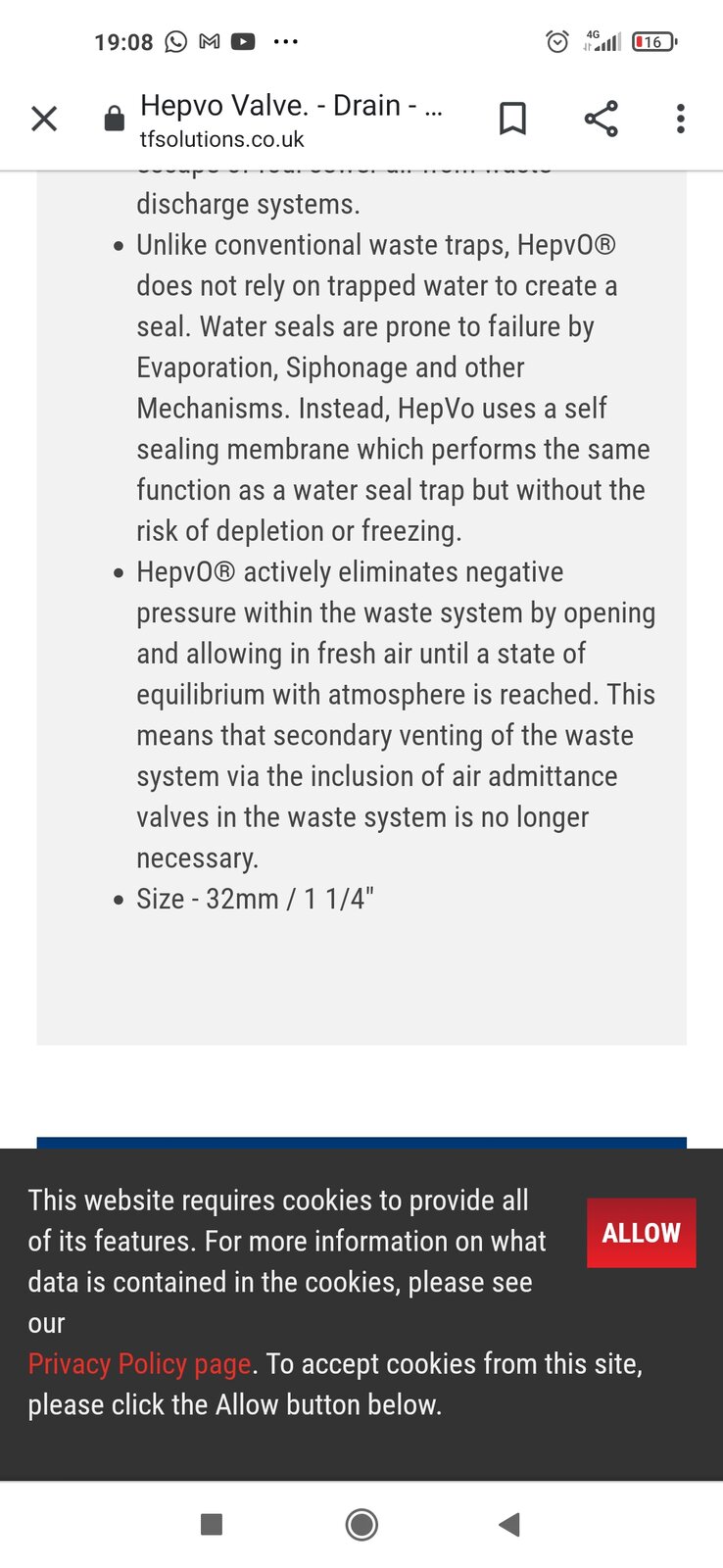

If adding a aav to a pipe run with a running trap/hepvo trap should the aav be before or after the trap in the pipe run. Thanks
Depends on what you are trying to achieve by adding an AAV into the line. Are you trying to stop the running trap being self syphon'd/pulled or are you venting a long run or trying to stop gurgling at outlets?
A HEpvO waterless trap shouldn't be affected either way.
Would be venting a long run to help it discharge. The run would have a waterless trap on it.
For water to discharge on a long run it needs to be able to draw air in to the system?
The reason for venting a long run would be to avoid any self syphoning or pulling on traps further downstream.
What is feeding into the waste run? You could use a anti vac trap if it's a basin/sink.
Would a long run not need a way of drawing air in when discharged? To aid in discharge?
But this suggest a waterless trap will allow air in when discharging?

Of course but in a domestic setting there would usually be an outlet that would feed into the run like a sink, basin, bath etc therefore there would be plenty of options to vent via the trap.
I take it you are talking about a commercial setting where the glasswasher needs to drain into a run? Ideally you want to minimise the length of run to below 4m on a 50mm waste pipe. That being said if you wish to empty a glasswasher into a waste run and are concerned that the output from the appliance will overwhelm the size of the waste pipe then you would vent at the head of the run.
Can I recommend that you avoid using a waterless trap in a commercial setting. Waterless traps suffer more from a lack of servicing than normal watersealed traps and do need cleaned periodically.
Ideally you want the waste pipe to be large enough/run not overly long, if not then I'd use a antivac running trap. Is the outflow from the glasswasher that large, they don't hold huge amount of water do they??
