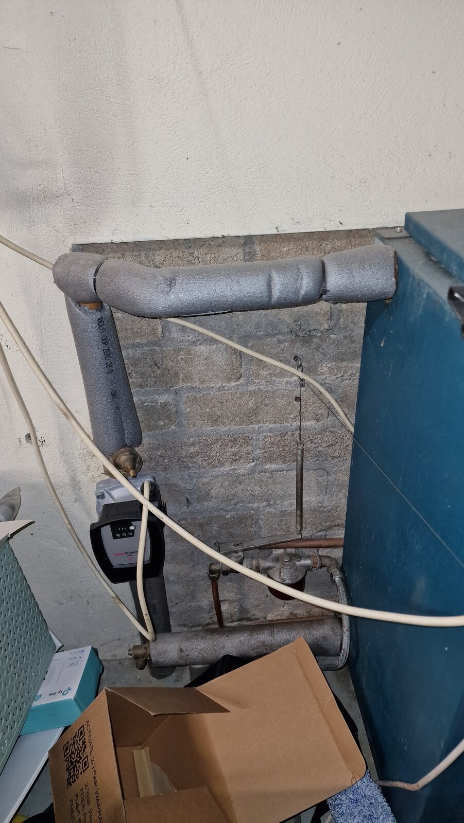

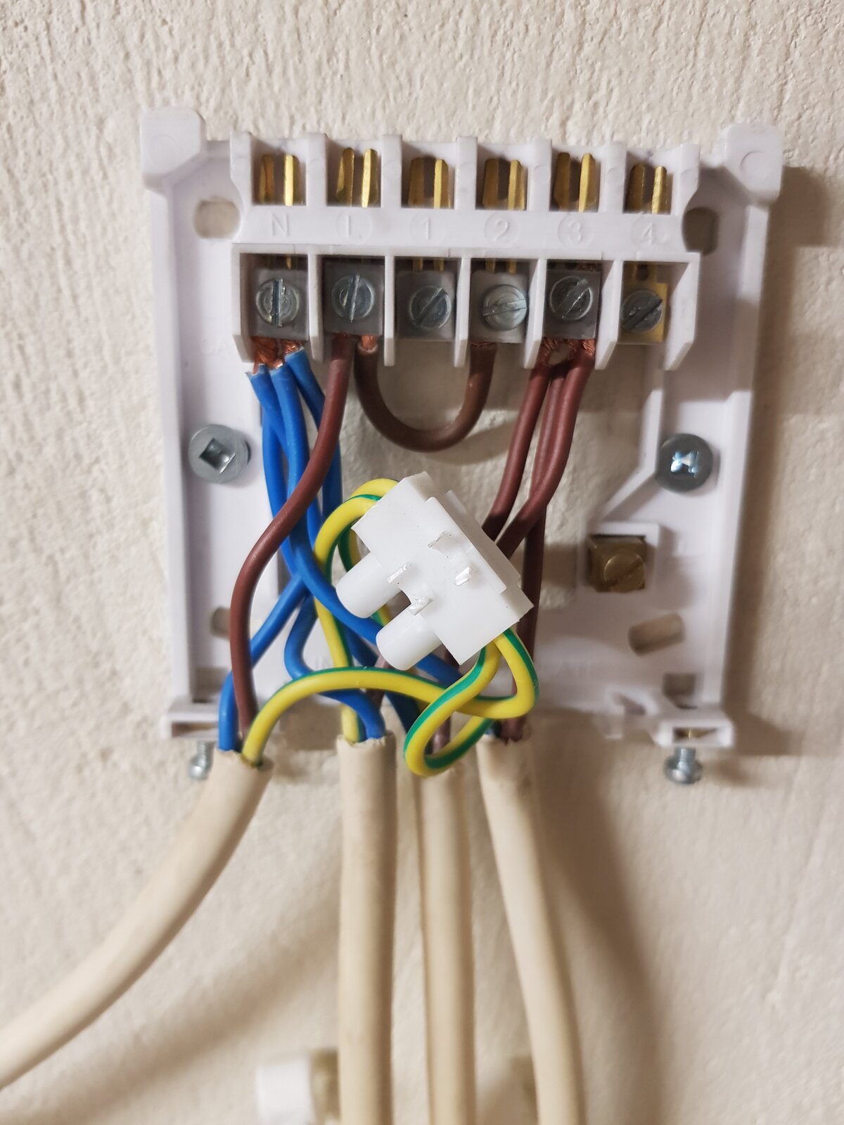

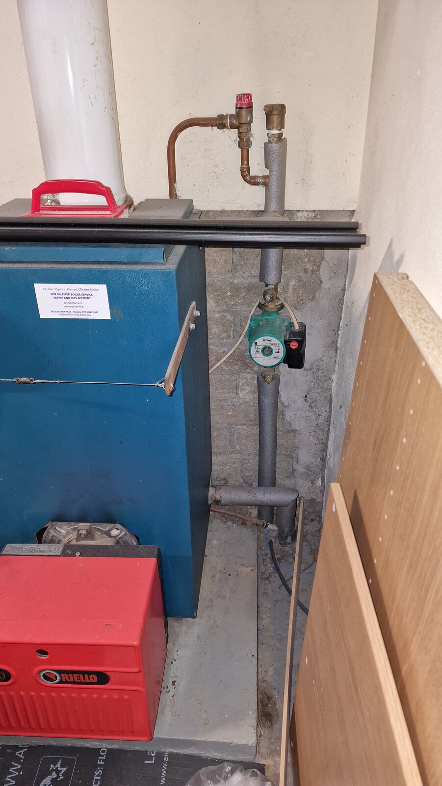

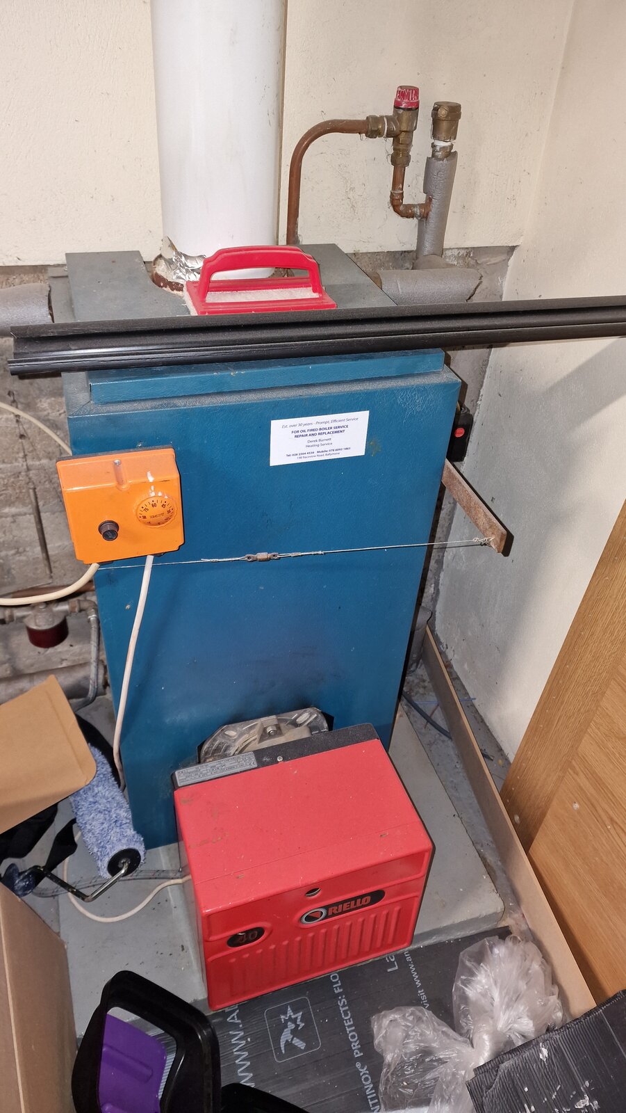

Hi all.
I've recently moved to a house built in mid 70s with OFCH and a warmflow boiler from the late 90s.
Im trying to figure out what plan my system is configured as. I don't have any motorised valves nor port valves anywhere that I can find.
There is also pump on each side of the boiler for radiators and hot water on separate circuits.

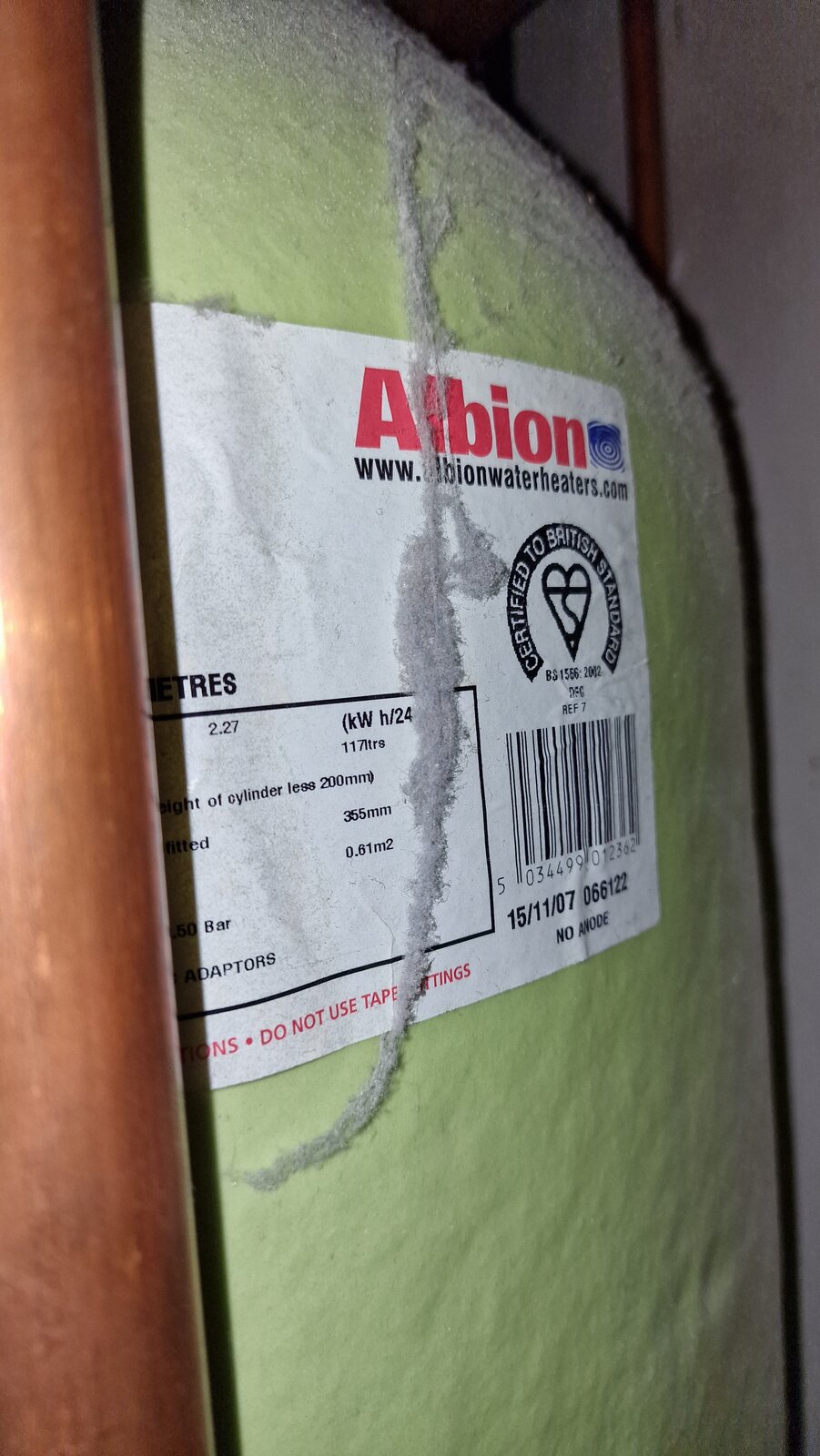

There is a fairly modern cylinder upstairs but it doesn't have a stat.
After recent electrical works my spark ran wiring from boiler to cylinder to allow for a stat to be fitted (not connected as yet) .
Question is does this just get wired directly into the programmer as I have no valves and then it turns boiler & HW pump on/off?
My old programmer recently gave up the ghost so also want to replace with 2 channel with wireless room stat.
First step for me is finding out if anyone know about this type of heating plan?
Thanks.

No problem to wire cylinder thermostat feed from terminal 3 on programmer to feed hot pump/boiler
If you don't have them already you will need relays to separate feeds to pumps /boiler.
