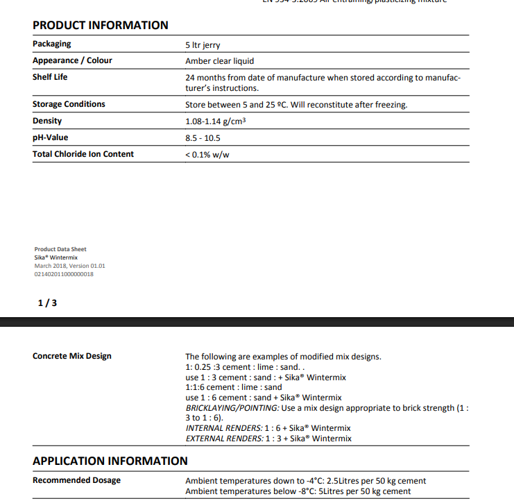

I need to replace e couple of fence posts and with it being cold at the moment (2C daytime and -3C night) I planned to add a bit of Sika Frostproofer to the postmix.
I have hanson postmix which requires two litres of water. I plan to quickly mix in a flexibucket then chuck it in the hole around the post.
But I cant quite work out how much frostproofer to use...
The directions have some calculations for concrete mixes. Then further down it says 1.25 - 2.5litres per 25kg of cement.
Assuming postcrete is a 123 mix, my 20kg bag would contain 3.3kg of cement.
at 1.25 litres per 25kg, this would work out at 170ml for 3.3 kg cement, so I roughly need to mix 1.8l water and 0.2l of frostproofer. Then add the postcrete.
Does that sound right?
I've just noticed it also says Do not use with high alumina cement :rolleyes:

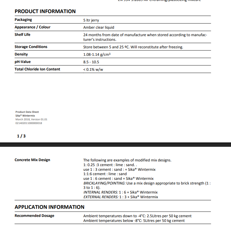

but Sika make another product called wintermix that doesn't have this limitation..
It has the same dosage rate so the question is still valid.
at 2.5 litres per 50kg, this would work out at 170ml for 3.3 kg cement, so I roughly need to mix 1.8l water and 0.2l of wintermix. Then add the postcrete.

I phoned Hanson and they told me they produce two types of postmix - fastset and postfix. Both go hard in under 10 mins.
fastset contains high alumina cement, postfix doesnt. I have the postmix which is fine to use with the frostproofer.
I added 250ml to the water, mixed in a flexibicket then chucked it in the hole.
This is probably overkill for fenceposts but cement is vulnerable to frost even when hard.
Although it feels solid after 10 mins it is very weak and there is still moisture present that can freeze, expand and crack the cement before it has reached full strength.
