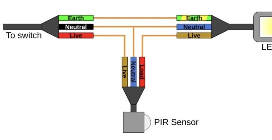

Hi all
I have standard outside light operated by hall switch & plan to add PIR between switch and light. Normal 2 core & earth out and into light.
PIR has Live, Neutral & Switched live. Would wiring be:
Out
Out Earth to light in Earth
Neutral to PIR Neutral
Live to PIR Live
Switched Live to light in Live
Similar to pic. Hope this makes sense.
