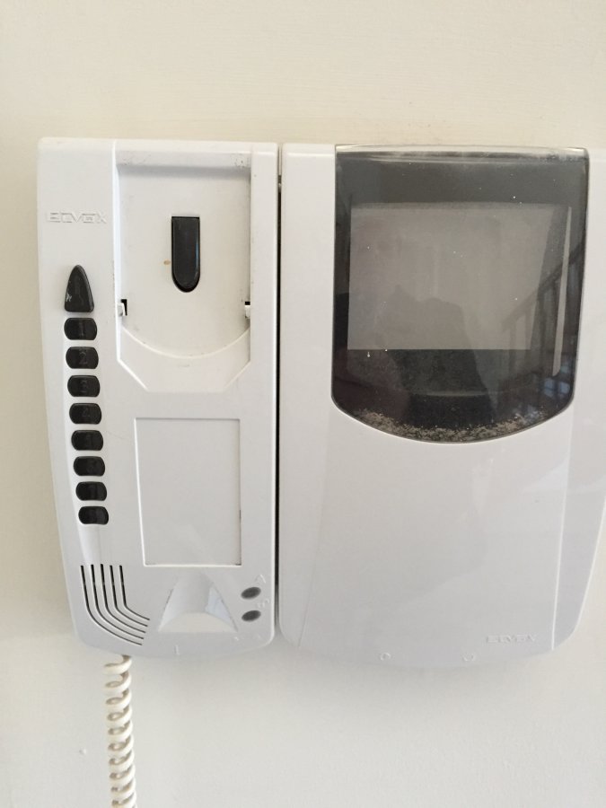

Just moved into a two floor flat where the existing entryphone point is on the lower floor, so I want to add a second entryphone on the upper floor.
The kit is an Elvox Petrarca - 6000/6200 series video entryphone, comprising two units linked by a ribbon cable and sitting on a steel plate. Coming into the phone part is a coax cable (for the video) and a number of thin cables (probably 5) which I believe supply the voice, power and door opener.
Question: can I add another unit in parallel to this without needing another power supply and any ideas which units might be compatible? For example, I've spotted an Elvox Giotto video and handset combined on eBay. Would it work with my existing system?

I think the video part is fairly standard, but the handset depends on which system you have (2-wire, digital bus, etc)
For the video, the video in connects to V2 terminals at the top of the video board. If your handset is end of the line there should be a resistor across the V1 terminals at the top of the video board; remove that and connect coax to those terminals and extend to the next monitor, and put the resistor at the new end of the line.
http://www.intercomsrus.com/handset pdf/Elvox 6200 Intercom Handset Data Sheet.pdf

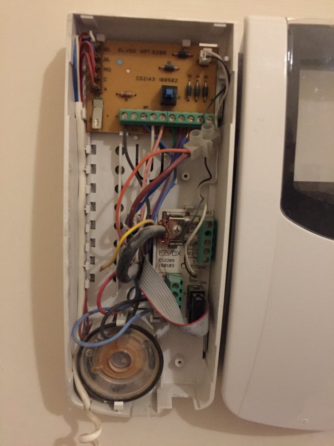

Well, here's the inside of the handset. It says it's model 6200. There seem to be a couple of additional boards further down which aren't shown on the handset identifier. What type of additional handset could I use and how easy would it be to connect up?

The top board is the audio board, with terminals 7 1 2 3 common to all handsets and the call wire for your flat on 6
The bottom board is the video board with the incoming video on coax with the core going to V2. Your extension video coax will fit under the same clamp with the core going to V1 at the top (and move the teminal resistor which should be there - I can't see it clearly - to the new extension handset). You also need to extend the power wires + and - from the lower terminal strip on the video board - I think they're blue and black?
Refer to the last page of the datasheet PDF
Thanks, brilliant. Will a 6300 handset fit the bill? Not sure if all the 6300 models are coax or a mixture. There's a model on eBay fo £90
Elvox Giotto 6300 (b/w) and 6303 (colour) are compatible with power supplies type 6680 or type 6580. Giotto 6300 coaxial or twisted pair video can be selected by internal switch
Elvox Giotto 6301 is compatible with power supply 6680 only. Type 6306 is compatible with power supply 6580 only and is not coaxial video.
Theremore I think that 6303 is most likely to be compatible; the call wire to existing terminal 6 may be 6E on the new handset. (Electronic call = Elvox "sound system" I think).
6303 may have been replaced with 6351 but it appears equivalent although some of the terminal numbering is different (call wire to 8 not 6 or 6E, 6 is used for one of the power wires, etc)
http://doorentrydirect.com/acrobat/elvox/data sheet/s6i_634_100_R03.35617.pdf
