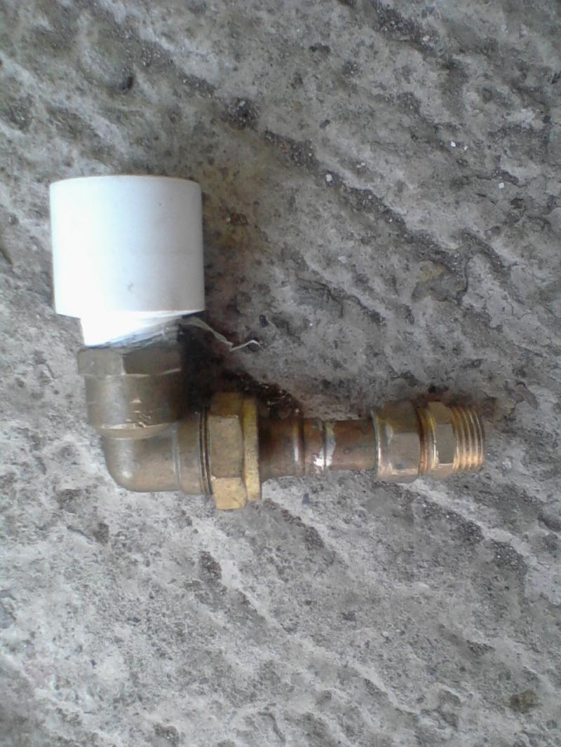

rather than buy a filler make one using a McAlpine washing machine spigot and something with 3/4" BSP female thread then reduce down to 15mm, i have used a straight coupling which i screw into the top of the rad.
