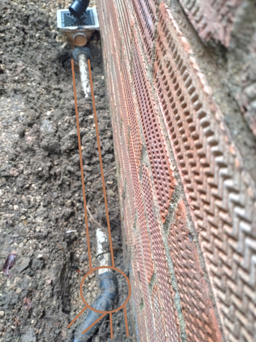

Hi, in the picture you can see I have a channel drain (black 40mm) which then goes through a 135 bend into the white pipe, which goes into the gully via a strap boss. I need to add a second channel drain (also a 40mm outlet). The 40mm pipe gets overwhelmed so I need to increase capacity.
I am thinking of the following and would like your advice:
1. Replace the gully top with a double socket tee like this.
2. Replace the white 40mm with 110mm.
3. Replace the 40mm 135 with either a 110mm 135 tee or with a mini inspection chamber and add in the new drainage.
Thoughts please? My main concern is that I may not have enough fall on the new double socket at the gully end, which means having to dig out and try to lower the whole gully?
