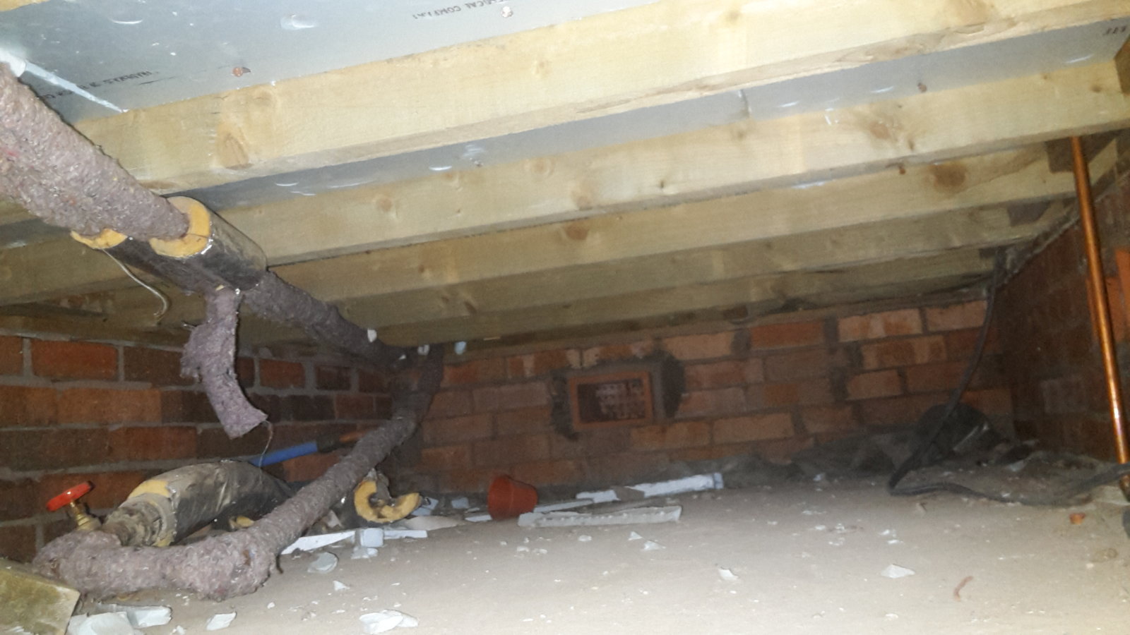

The kitchen of my house is an extension out the back of a 1900 cottage. The suspended timber floor in the cottage is fine, but the extension floor is painful to walk on when it's cold. If you're barefoot it's like walking on ice, it stings your feet after about 10 seconds standing on it.

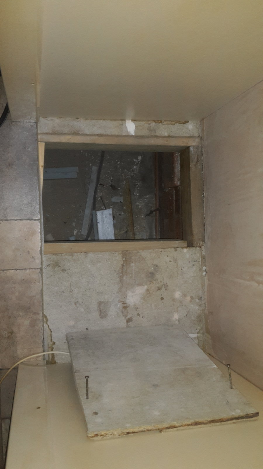

There is a composite tile floor on top of something like 30mm OSB. Between the two is 2mm of useless white insulation material. I dug a hole through under a cupboard to see what was underneath, hoping to find no insulation. What I found is shown in the photos. Is the blue stuff valid insualtion, or completely useless? Will ripping out out and putting something better in make a significant difference? One of the photos shows the hole I have to wriggle through to get under, so I'm a bit limited in what else I can fit through it as well. I'll also have to knock a few bricks out to get to the other side of the supporting wall.

Is the blue stuff valid insulation
Can you read any of the writing on it? I'm not sure what it is, but maybe it's extruded polystyrene (XPS).
It does seem to have been fitted from below. It might have been more effective if sealed to the joists to stop draughts.
Got any small children? (Semi-serious suggestion.)
Lag the rest of the pipes while you're down there.
Hi, thanks for your message. I agree that it appears to have been fitted from below. Couldn't see the writing on it, but I'll have another look and report back.
I can just about fit through the hole, but wouldn't be able to get any insulation boards through it unless in small pieces. If I had a child then they would be helping me for sure!
Yes, the pipes need lagging. This house seems to be one that has had a lot of care put into apperances, but as soon as you look behind the scenes then there's a lot to be desired...

Just to confirm a few things, the insulation is 50mm thick (Dow Wallmate), so it's normal XPS. It's held in place with nails and there are definitely gaps that would benefit from filler/tape.

I got under the floor and added pipe lagging to the heating pipes. Much needed! I suspect there's none in the rest of the house, so might need to do that as well.
Also went around and taped every joint between insualtion and joists, and where insualtion boards butted up against each other. Thanks for the suggestions to tape - it worked.

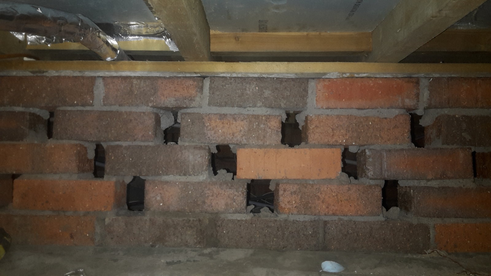

Standing around barefoot on the floor before doing this, I was slightly suspicous that one half of the room was colder than the other, but wasn't really sure. Now I've taped the joints, I'm certain of it. And just to make sure, I had a look through the sleeper wall gaps, and guess what - no insulation on that side of the room! At least whoever was in the house before was consistent in their lack of attention to detail!
So the next stage will be to get through the sleeper wall and put some boards up on that side, and more pipe insulation. The photo shows the middle of the wall. Above this is an island in the kitchen so no one walks over the top of the wall. I'm sure that a few missing bricks there will be ok until I get around to putting them back in. Any recommendations for how to knock out the bricks (I have grinders, chisels, lump hammers, etc), and which/how many bricks to knock out? I'll need 4 bricks out (horizontal length), and as many rows as possible for me to squeeze through. Is that safe? Do I need to prop it up once I've got the bricks out?
Thanks.
Work out where the centre of the island is, and take the bricks out below that. Hopefully, it'll be above just one joist, and with a bit of luck, it'll be above the joist shown in the centre of the picture. Now if that's the case, then after you've got through, I'd be inclined to just put in a piece of 4x3 or 4x4 to span the gape you've created, rather than trying to put the bricks back in.
Thanks, sounds similar to my plan. I was going to knock some wooden uprights in after instead of replacing the bricks. Sounds like you're suggesting a horizontal bridge/lintel of wood, so I'll do that an add some uprights too. Will also add some under the washing machine as it's a bit wobbly...
As for knocking the bricks out, would a hammer and chisel be the best approach?
