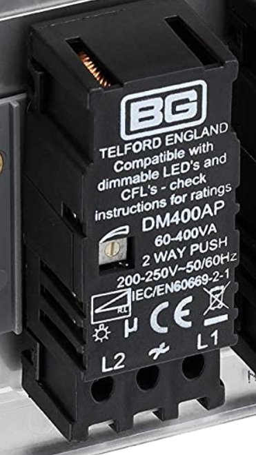

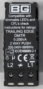

I have bought a BG 3-gang dimmer and wanted to get 2 of the switches to act as normal switches (as they control non-dimmable lights).
I have previously bought one where there were dials that made this very easy as per the the picture of the back of the switch in the link below:
However, the one I have just bought on line doesn't have these dials and looks like the one shown in the link below:
I have not yet opened the switch as I want to return it if it is not possible to achieve my aim. It looks like the backs may clip off. If they do, is there easy access that can control the dimming range within?
The full product name is BG NBS83.
Thanks in advance for any help with this.

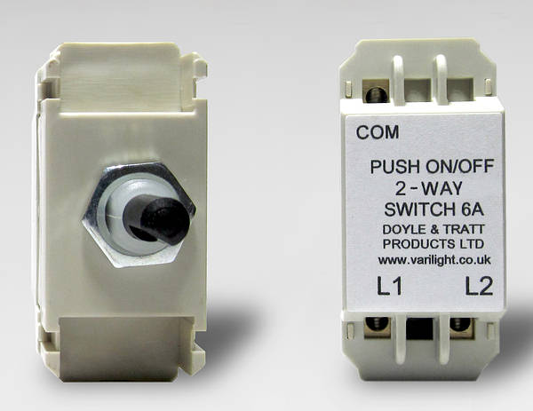

I think I can see what you are talking about one (5-400 VA) has an adjustment 1682411199071.png the other (5-200 VA) does not 1682411263420.png however although the adjustment will set the minimum dimming not sure should be used with non dimming bulbs? These 1682411785665.png are designed to be used for non dimming lights, a simple on/off switch

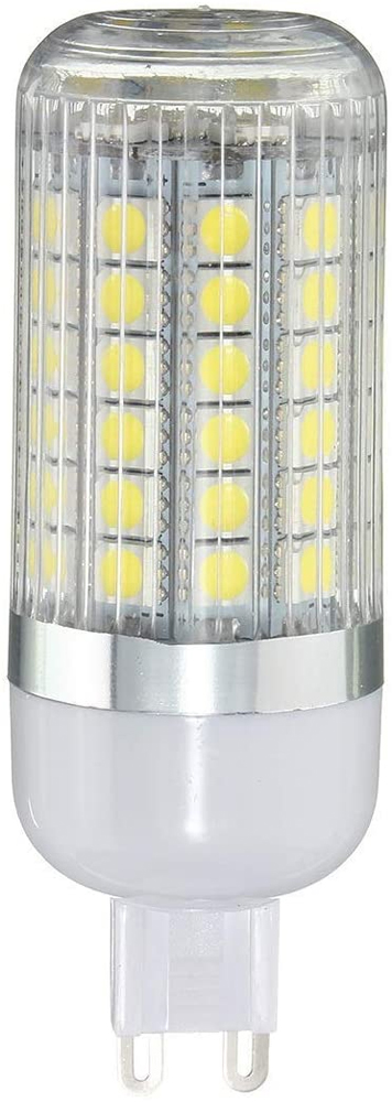

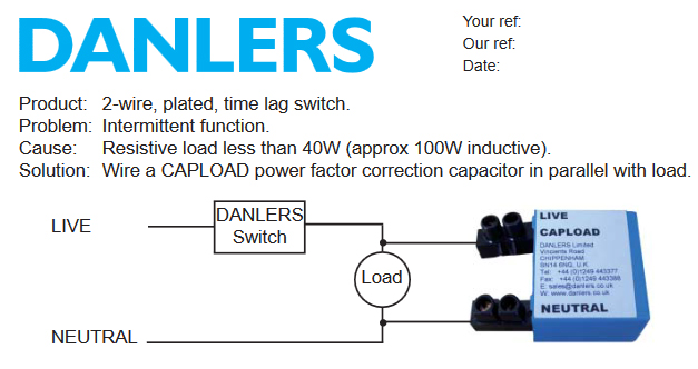

Using a standard BA22d 15 watt LED is no problem, it was a small problem using three 5 watt GU10 LED's but swapping bulbs around did cure it, however the G9 bulbs caused a problem I seemed at first to be unable to solve. The lamp came with five of these bulbs G9-small.jpgI tried fitting a load capacitor load-capacitor.jpgwhich did stop them staying on dim, but the shimmer was a real problem, fit one quartz halogen bulb and the shimmer stopped, but whole idea was to stop using quartz bulbs, tried different make of bulbs, using the compatibility chart but only one bulb listed, a Philips 2.3 watt which is smaller than 5 watt anyway, but still the shimmer.
My wife who uses internet more than me got five of these G9-big.jpgwhich are too big to fit the covers which were required with quartz lamps, so I had not thought she would accept them, they break the rules, as no wattage or lumen marked on the bulb, but no flicker, within a day one had failed so sent for four more, when they arrived I opened the failed bulb to see what was inside it, there was a capacitor to limit current, a full wave rectifier, across the output was a large electrolyte capacitor clearly reason why no flicker nearly as big as the smaller bulb, and a leak resistor.
I would guess around 6 watt each, and when I opened the failed one found a dry joint which I fixed reassembled it, and put it back into service, now been running at least two years, and not used any of the four spares.
