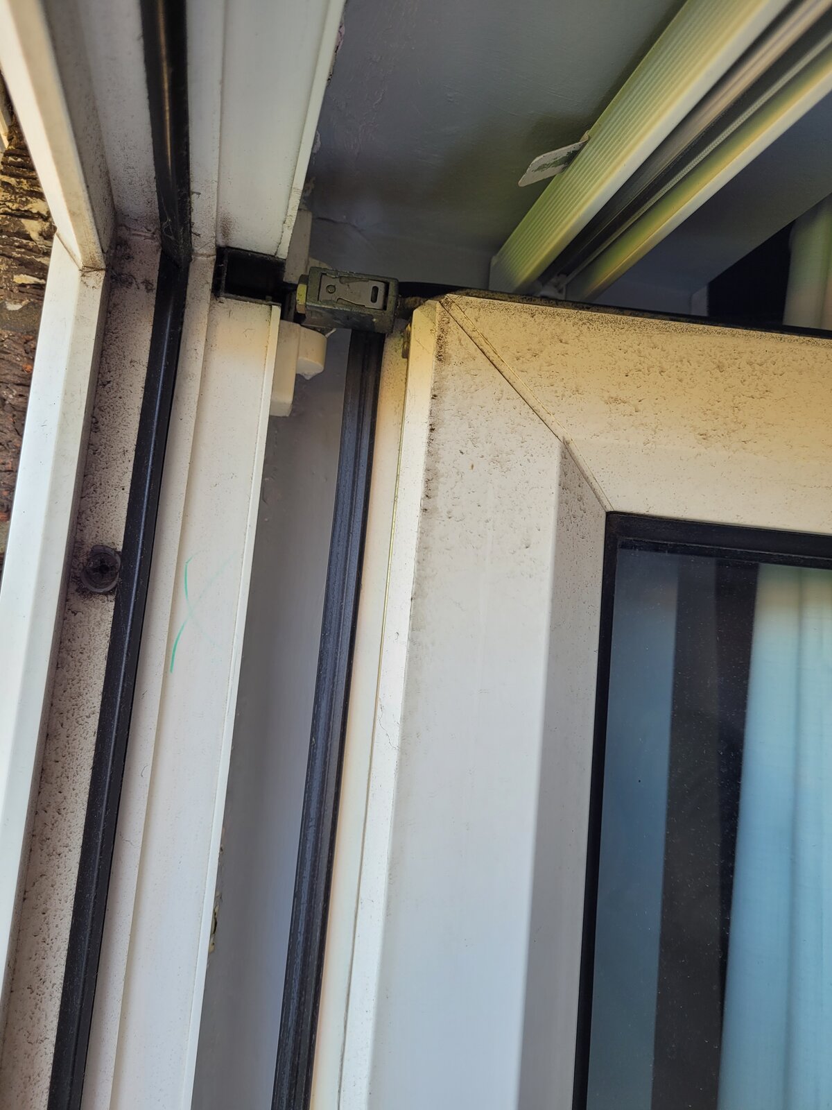

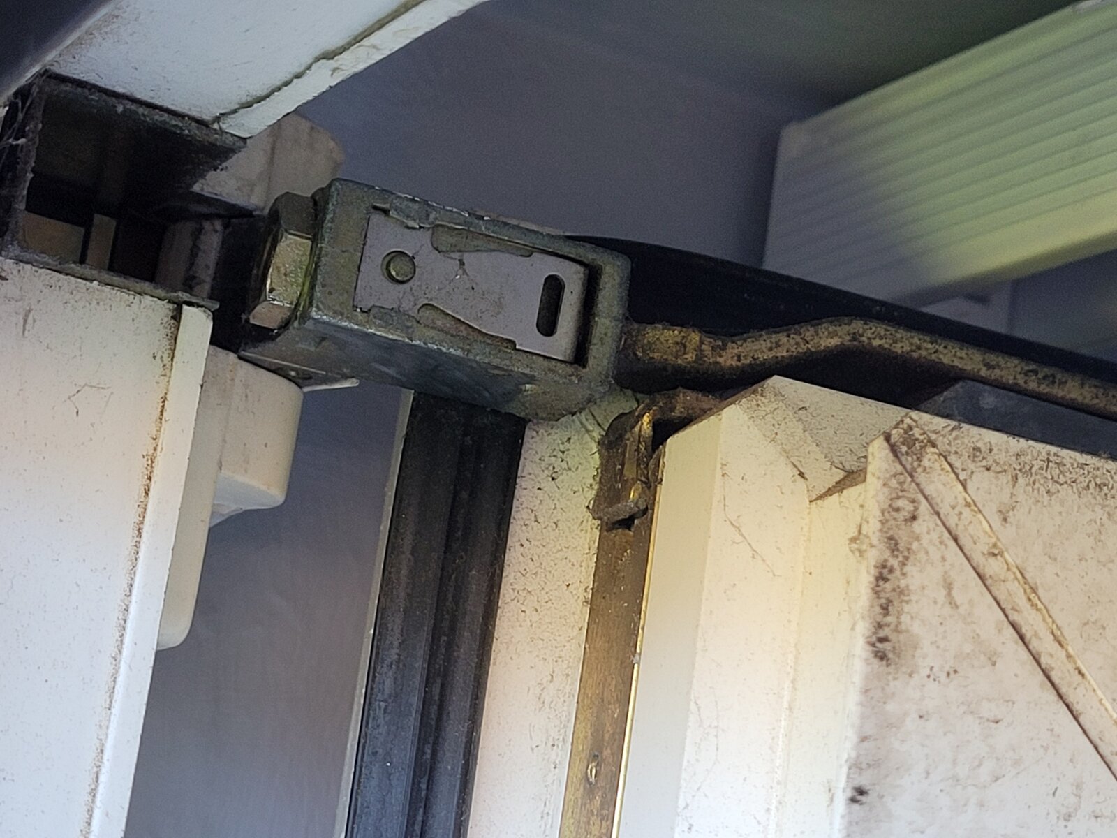

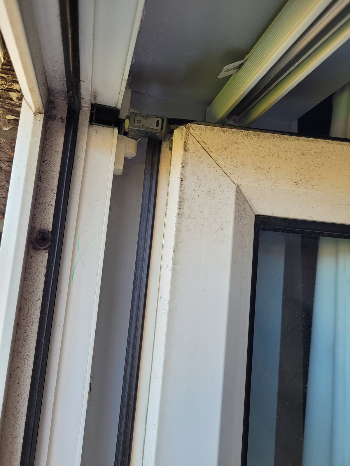

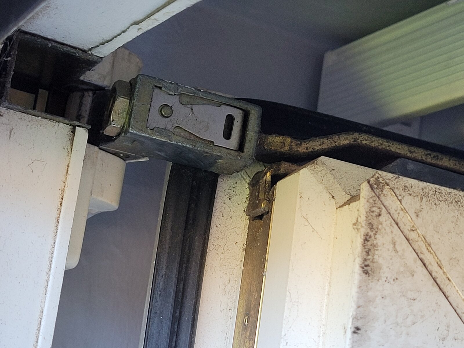

Hi I need the window moving closer to the frame in the photo. Am I correct in thinking I turn the nut on the end of the hinge ?
Hi,
From what I have seen on YouTube; yes, I believe you are right!
If you can, score a mark on the nut and the bracket and make small adjustments. You can always reset it to the mark if it it all goes awry! :)
... and probably a clockwise turn of the nut, to pull that edge closer to the frame!
