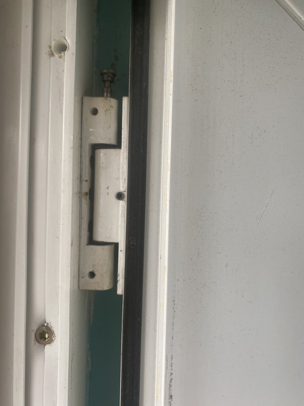

Look underneath, could be an allen bolt, tighten it and it should push a plug up and lift the door, old hinges though and there won't be much adjustment, possibly may need to toe and heel the door instead
