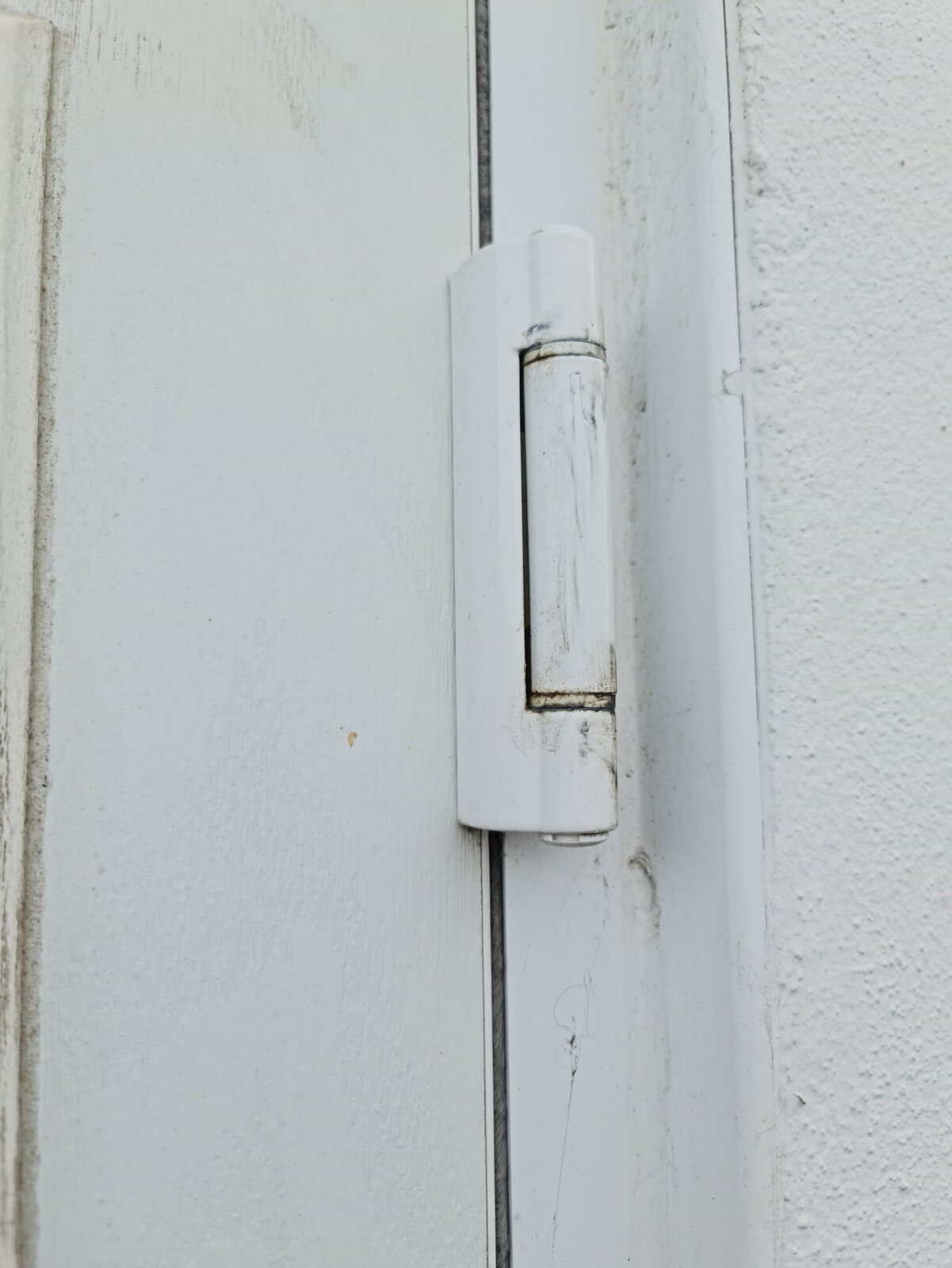

Our uPVC back door is about 4(?) years old.
After a year or two the rubber seal at the bottom started to fray because the bottom (side opposite the butt hinges) was rubbing against it. Someone used some allen keys to lift the door upwards and the seal was pulled out of the bottom tray.
Now, when you close the door, the top left hand side slightly hits the door frame (it still closes though).
I can see no way of adjusting the hinges sideway (in the frame as you look at it from the outside).

Does that mean that ValueDoors (continue to knowingly) use "older" hinges? Or am I missing something? I cannot see any covers that will allow left/right adjustment.
Advice will be gratefully received.
The new door replaced a timber door and frame. There is a 3.5(?)m concrete lintel above that has been there since the extension was built approximately 20 years ago. I haven't used a roofing square to see if things are off square yet. The multipoint locking is currently fine.

It's a Trojan 3d hinge, remove the long cylindrical cover in the middle and you should see a 4mm Allen bolt, if you undo that you should be able to lever the door over, then lock it off
Many thanks @crank39
Do I literally lever it off? As things stand, the door is only able to about 95 degrees, is that going to make things any more difficult.
Cheers
Yeah I think its just thin plastic, just pulls off, I have one of those box spanners but if you haven't then you can use a hex bit holder
Check all the screws in the hinge are tight too, the screws have a habit of coming loose in these hinges

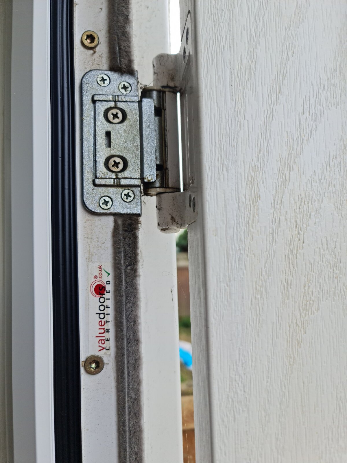

Hi all I know this is a old post, but can I just clarify that the concealed adjustment hinge controls control the up down movement as well as moving the door towards or away from the hinge/lock jambs. The hinge with the 3 marks upon it is for compressing the door against the frame
