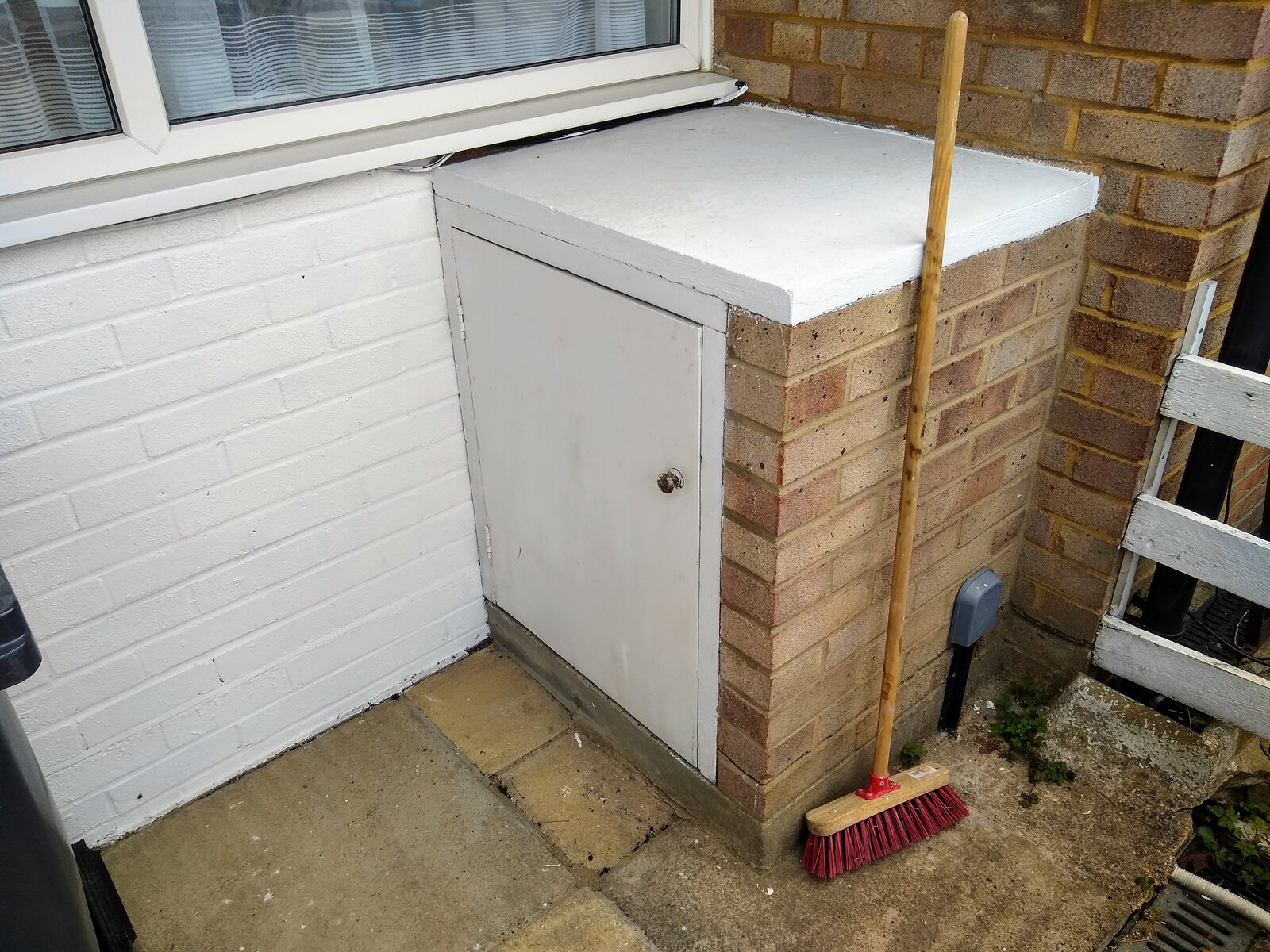

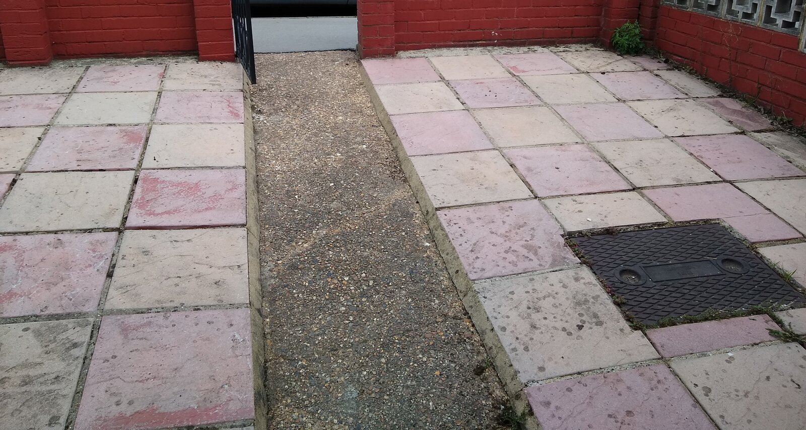

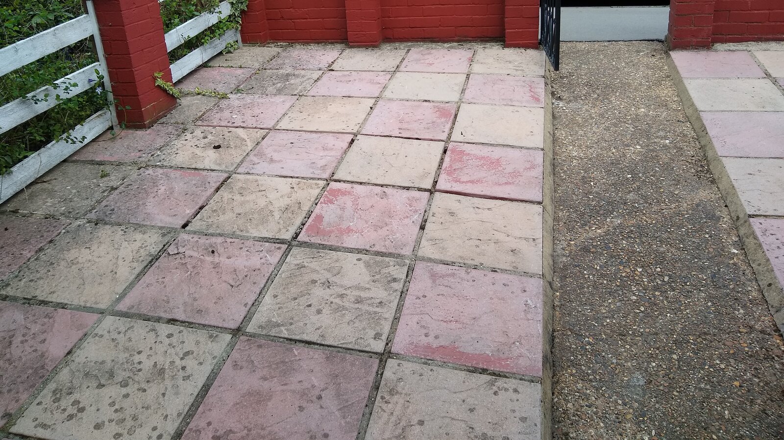

I want to get my drive paved and I want to know what the common pitfalls are that result in a bad job or defects down the line? And what needs to be done to avoid this?
Currently, my outdoor area slopes downwards towards the house..
There is a french drain towards the house which I would like to keep
Are there any preferable patterns that have more strength than others
I don't need an expensive drive, just something in grey and modern looking would suffice
Where is is the best place to find reputable tradesmen? None of my friends or family have any recommendations

It's all in the prep. Proper sub grade, sub base, capping, bedding is critical to the end result. What constitutes proper though really depends on your ground.

I am a newbie when it comes to block paving.. All i know is that a good job would mean
1. Proper prep (like @EddieM suggested
2. The finish of the block paving would ideally be at the same or similar height of the existing floor height, to prevent the possibility of internal damp issues
