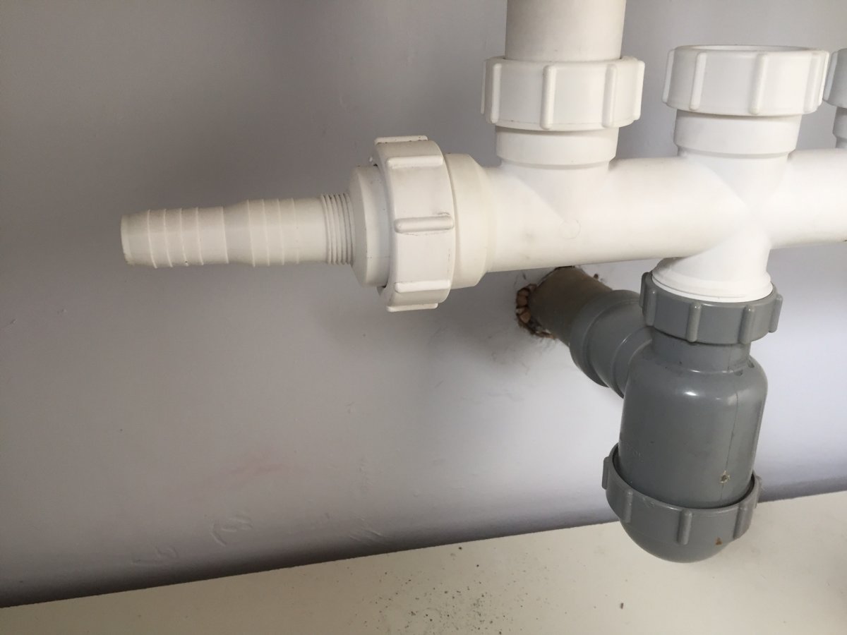

Advice how to connect Washing Machine into existing sink U bend
23 Jul 2017
3
Hi I am after some advice on how to connect the drain on a Samsung ECO Bubble washing machine into my kitchen sink U Bend, There has never been a washing machine fitted before so i will be starting from scratch but to my untrained eye it looks as simple as connecting the pipe to the existing fitting already under the sink with a Jubilee clip.....surely it can't be that simple?
It can be and it is.
But check the appliance waste connection on the trap, does not have cap on/in it first, as that would need removing.
Yep. As pbd says above... just make sure that spigot isn't bunged up with a cap and you may have to cut the end off the spigot to suit the circumference of the drain hose (which may have a rubber boot on the end).

Make sure you loop the washing machine drain hose up, from where it attaches to the waste, to prevent backflow from the sinks(s) running into the washing machine.
Can't see from pic but if you have room above swap the hose nozzle round with the blanked off one.
