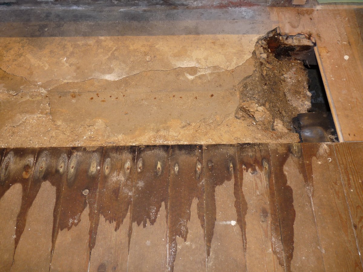

Here are some pics looking from above, im not able to get under the floor until the weekend to fully inspect and take more pics.
Front of hearth showing dampness on floorboards

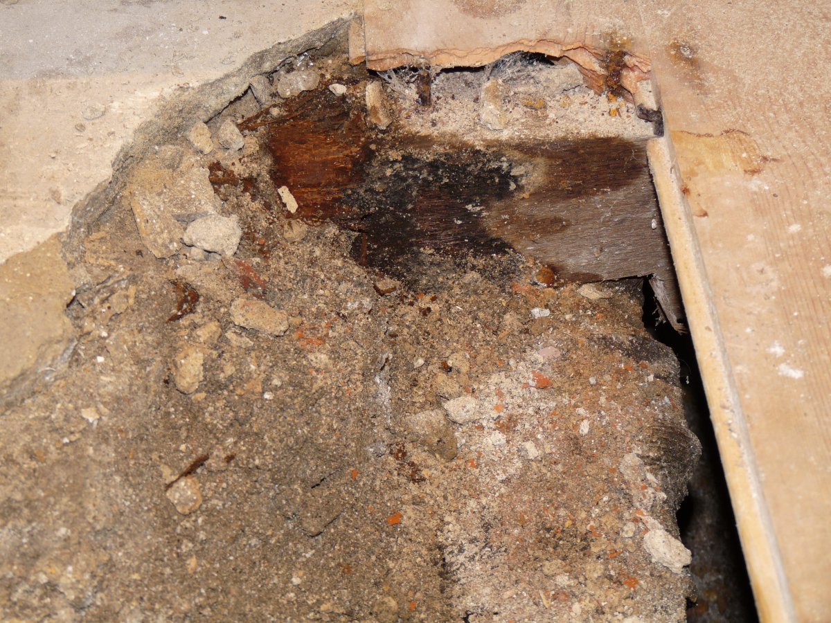

Showing damp and rotten end of joist resting on back of the hearth

Thanks for the photos.

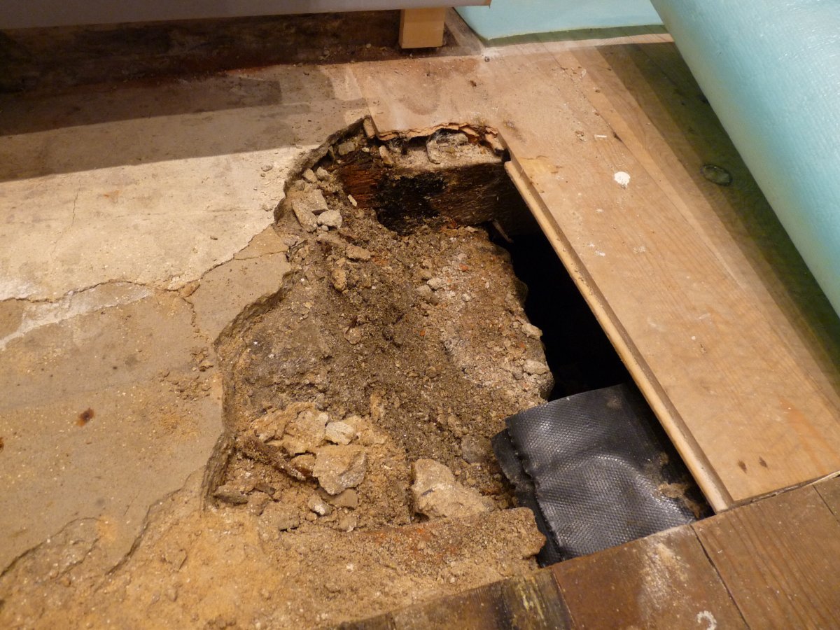

Photos of the full chimney breast and the room context of the c/b and hearth would also help - pull back all floor coverings etc.
Carefully examine all the way around the c/b and the wall that backs on to it - probe the skirting and flooring.
Best practice would be to at least crack out the concrete hearth, and dig out to below the fender wall level.
It might be that the bricked up fire opening will need opening up and the back hearth removed & dug out.
There has been previous remedial work to the timber - but it was obviously slip-shod & ineffective.
Its probable that some flooring and joisting will have to be cut out & replaced by treated & protected wood.
The nail heads visible in the "new" T&G boards are showing signs of rust from the damp joists below.

Was any of this on the mortgage surveyor's report?
The fact that there is a piece of DPM underneath the floorboards, the previous owners where aware of the problem, and have just covered it back up.
The hearth is drawing up moisture from somewhere, so this first needs sorting out, and then you need to put in new joist ends, and floorboards. You need to lift the floorboards around the hearth to find the extent of the problem. You've very likely going to have to dig the hearth out, rebuild it to the where the joist are going to sit, place a dpm down and then, having cut out the rotted joist ends, add new joist ends to the old joist with bolts, then fill in the rest of the hearth, and then refit new floorboards.
Or get rid of the hearth if it's no longer needed.
It's definitely a competent DIY job, and shouldn't take more than a couple of days.
