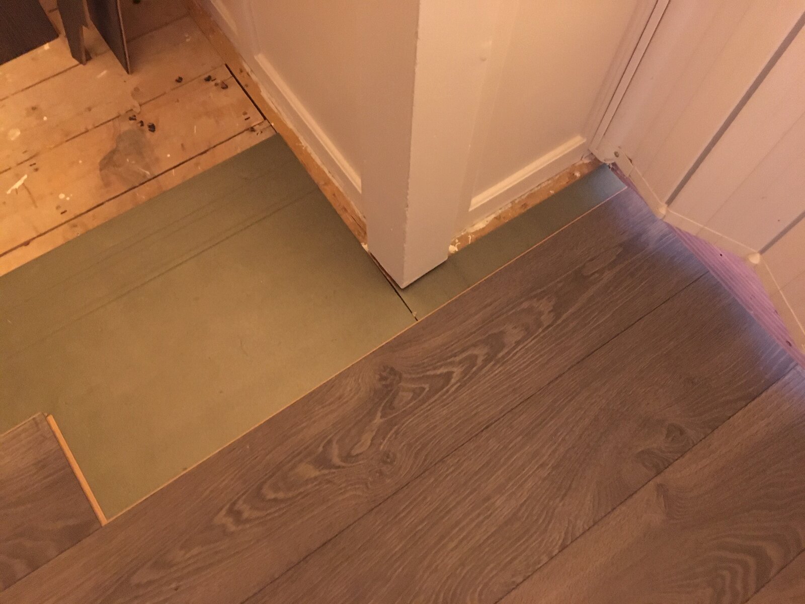

Attached is a picture showing the space for the end of row laminate plank and the stair post with two returns. I've undercut the post by about 20mm to hide the laminate under but cannot figure out how to cut the plank.
Any help would be really appreciated.

Easy answer would be to use PVA glue on the joints for this. Similar to
Use a scribe, a pencil and a length of scrap wood will do. A hand saw cuts on the down stroke so no need to transfer the markings underneath.
If unsure about accuracy do a/several test cuts on spare laminate board first, you can use that as a template.

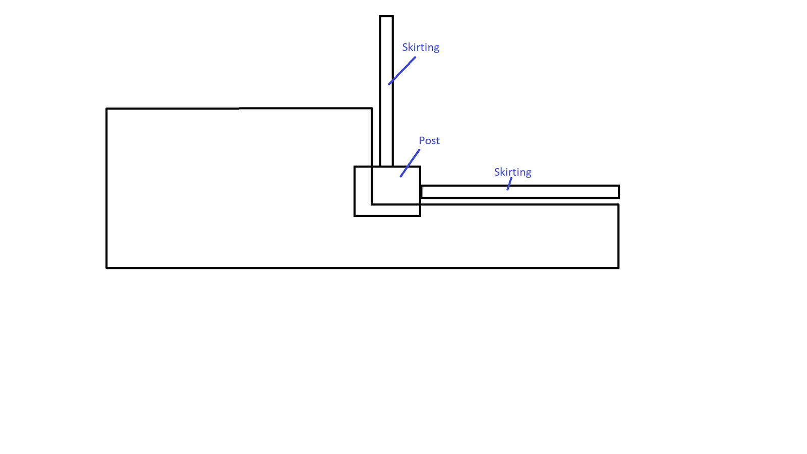

Thanks for the replies. I've drawn a sketch (not to scale) of how this plank should look but am unsure, even if I manage to make it, how I'd physically get it in! What do you guys think?

If you have undercut then why is it not a simple right angle to go under? Perhaps you should undercut a bit more?
