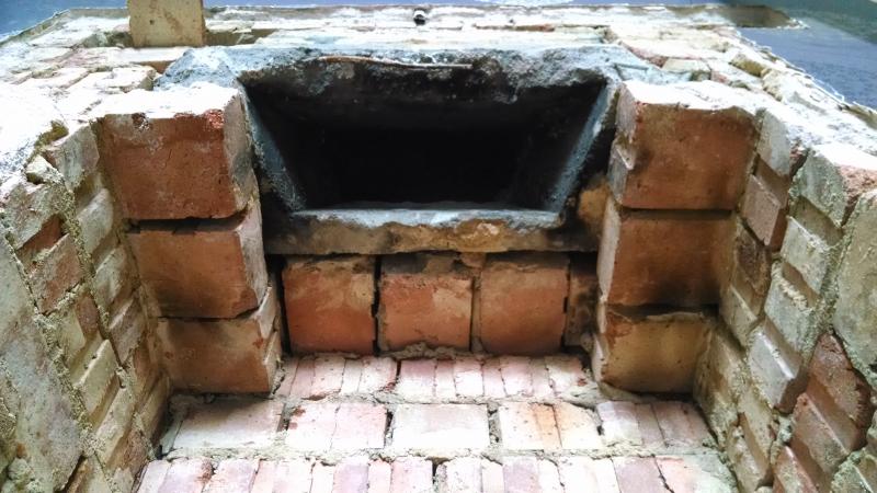

Hi,
I'm trying to figure out if I can open up my fireplace to fit a stove and have reached a point I don't know if I can pass.

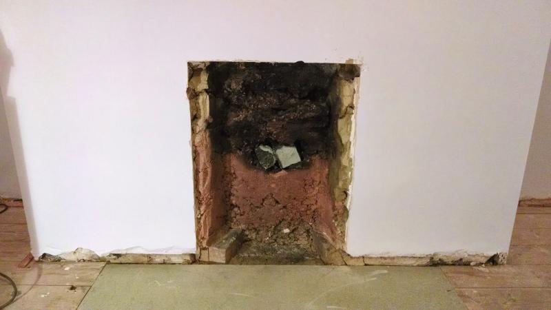

This is my first house and it requires updating. It was built sometime between 1956 and 1962. The fireplace when I bought it was a horrible gas monster, which has been taken out and the gas capped.
Look at that rubbish fire back!
I'm liking the idea of a wood burning stove, and have opened up the fireplace to what I think is the builders opening/recess.

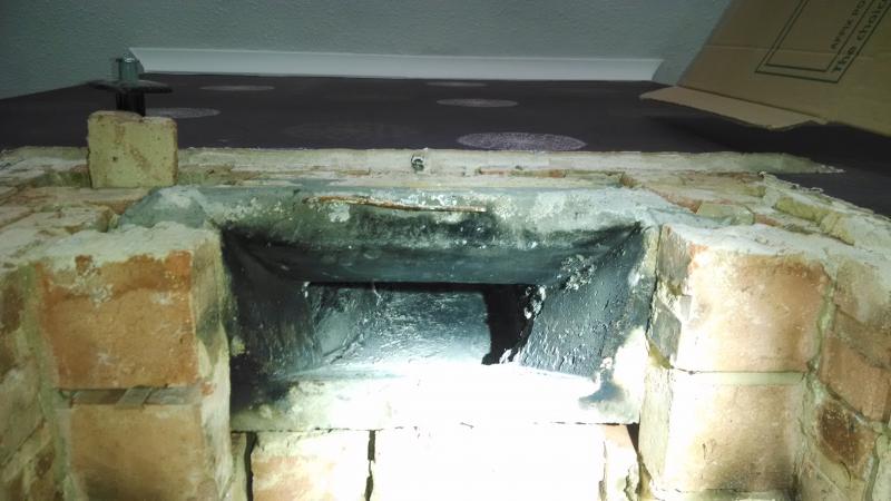

At the top of the image, you can see what I think is a massive precast throated lintel crossed with the top of a fireback sitting on a brick gather.
To fit a stove, I'm probably going to have to remove this thing as I will be wanting to fit a liner suitable for the stove and it won't fit through this opening and I will need the additional height for above the stove to get everything connected. Putting in a lintel in line with the top of this "cast lintel throat thing" gives me three courses worth of height.
My questions are:
1- do you think I can remove this thing without a load of flue falling down?
2- what is this thing called? I'm struggling to research this problem as I don't know what it is!
3- what can I do with the brick gathers beneath it (3 deep but the cast only sits on the front one - not sure what's above the other two brick gathers)? Ideally I don't want them protruding into the opening beneath the lintel. There's also gathers behind the side gathers coming out of the back wall, one course higher which seems to be supporting a sculpted part of the flue.
Thank you for your help - I'm new to this game!

In that case you can happily take out the shaped lintel without upsetting your neighbours and fit in a new one higher up (if there isn't already one in there. You need to do some more plaster removal to find out. A couple of strongboy wall supports fitted in above where you want the new lintel and before you remove the existing lintel should hold things up.

Cut the bricks below the throated "lintel" ( i think its called a Flue Gather) and you should be able to lower the whole thing down.
The brickwork in the chimney breast above the "lintel" will be sound, and wont come tumbling down.
Typically, unless there is obviously loose brickwork above the opening, then no Strongboy or Acrows are needed.
But as suggested above, before doing any knocking about, sort out your finished opening dimensions (stove Mfr's) and work to them - perhaps you can insert the new lintel above the Flue Gather, and then drop the Flue Gather?

Lift the board/sheet(?) from the floor, and see whats under it as regards front hearth possibilities.

Under the sheets is a structural concrete heart. I've been under the boards and it goes to the ground. Used to have a hideous white flaked marble hearth on top of it. I'm going to slate tile it.

ree, the bar would be removed later. If you look at the pic the precast gather is holding up the liners. In older flues mortar should be around the flues which would hold them in place. Modern ones have insulation.
However I have worked with bricklayers who didn't flush up the flues, meaning there could be a chance of movement when the gather was removed.
Well yes, but there's no indication that the OP's c/breast and flue match your diagram. From what i can make out from the information given, the flue is a conventionally brick built flue ie the flue is part of the c/breast, so there would be nothing to drop or come down.
I dont know what "flush up the flue" means - unless you are referring to parging the brickwork of the flue. Or, if clay flue tiles have been badly plumbed?
Or something else?

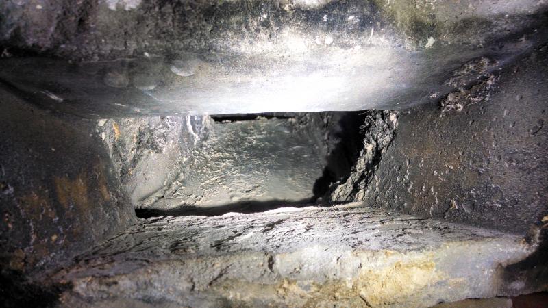

There may be flue liners sitting on top of the precast gather. It could also have no liners and have a parged brick flue. I can't really tell from the photo.
Up to the mid 60's most flues were built in brickwork and parged. After the introduction of the 65 Building Regs flues were required to be lined.
Liners were built on top of each other with mortar joints, and the brickwork was built round them. The gap between the liner and the brickwork was filled or flushed up with mortar. This held the flue in place.
Some bricklayers didn't do this as the flushing up could push out the brickwork if it was a bit wet, and it made plumbing up the stack a bit harder.
Nowadays you use a mix of vermiculite and cement in between the flue and brickwork.
If it helps identify it - the flue is square in appearance through the cross section and not circular like I would imagine a clay flue liner would be. I can make out what looks like a horizontal layer of mortar every 20cm or so, which confuses me a bit. I'll check again tomorrow and get exact measurements and try for a photo.
