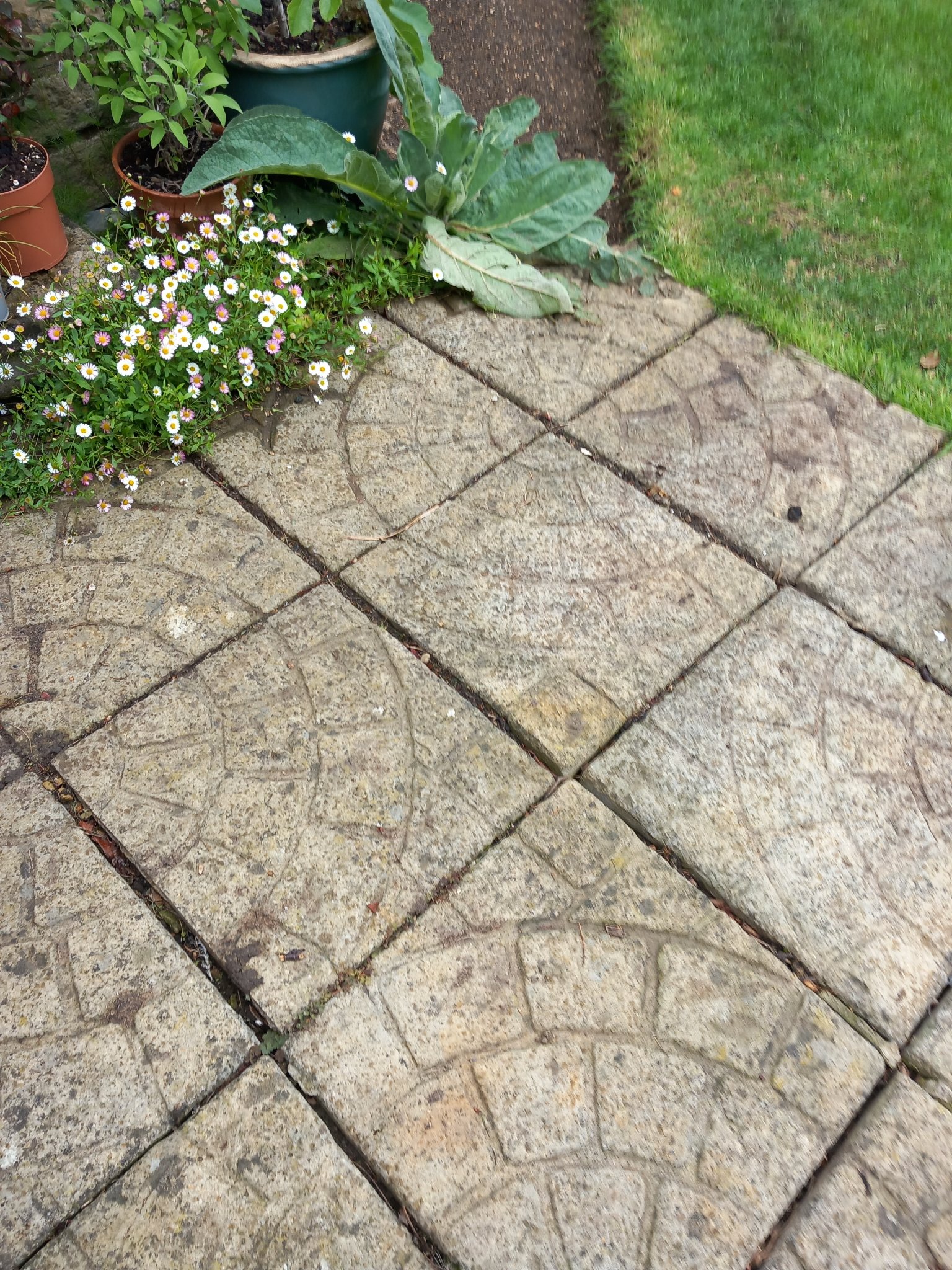

Our property is adjacent to a railway line and subject to vibrations. The existing patio slabs have shifted and joints opened up over the years. Research has suggested putting down paver grids. Has anyone experience of installing these? Are they the same as gravel grids ie sitting on top of a fully compacted sub-base and then you sit the pavers on top or, are they made to the exact size of the slab which then slots into each 'pocket' in the grid, the grid being locked together?

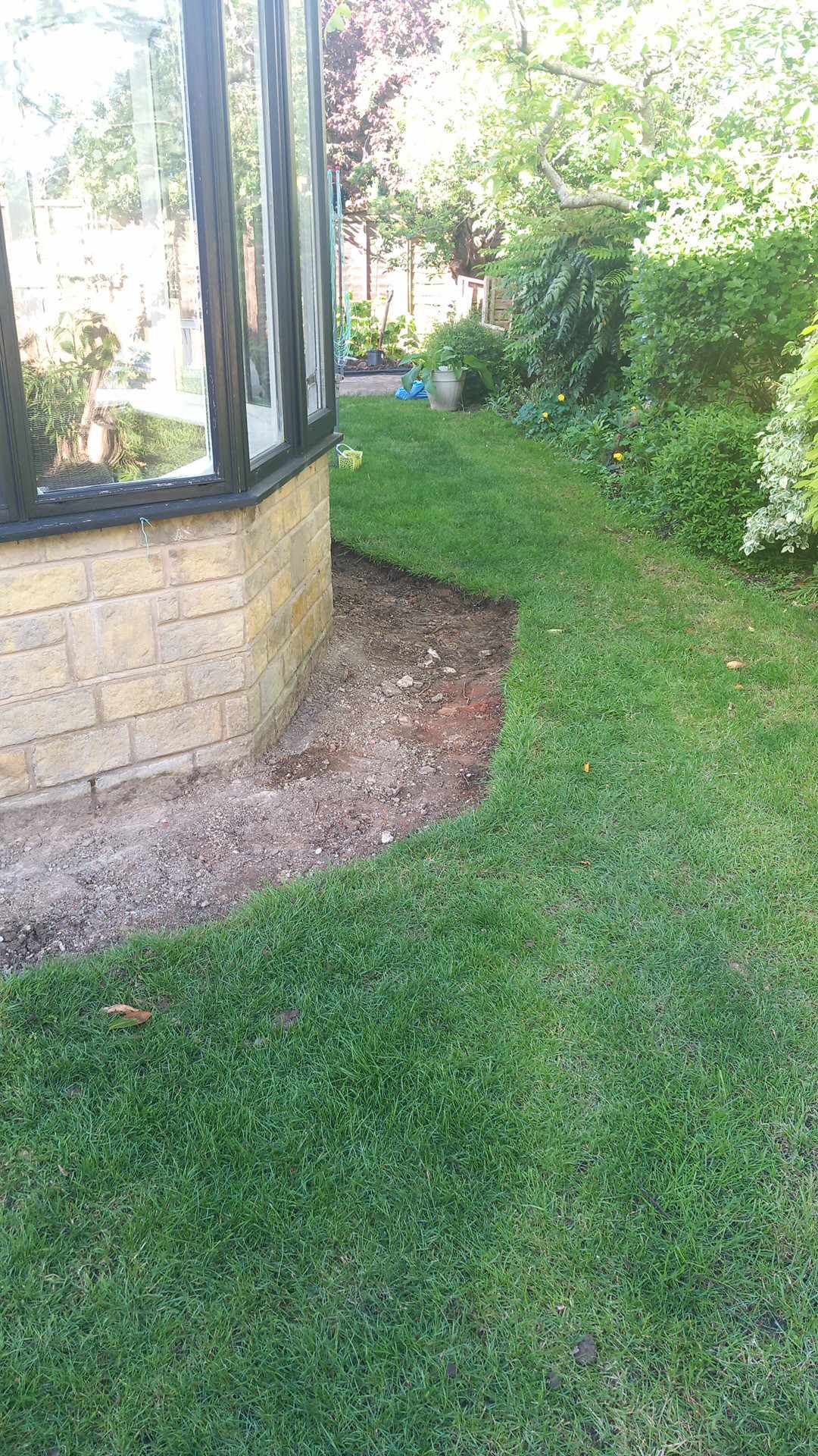

Pic shows where slabs and sub-base have been removed. Approx 800 wide

There is no norm for the size of gravel, you choose whatever appeals to you visually. Why do you think it needs to be in a grid or glued down? Have you considered corten steel edging between the grass and the gravel?

From a construction perspective, is it a requirement to have the gravel edging or is it just for aesthetics? In other words, could the turf simply butt up to the wall face?
With regards putting it in grids, it is really to stop the whole lot from shifting about. We're planning to do the same with the slabs. We get a lot of vibration from the railway and all of the joints in our current patio have opened up.
Would the gravel edging (say 6 inches wide) need to be put onto a compacted sub-base as one would do with placing slabs or can I just turf up to the wall then cut it back and place a weed membrane with steel edging?
Gravel edging is usually put against walls to reduce splash up the wall from rainfall [vs a flat surface]. I am not sure if it achieves this by stopping puddles forming, or because of the rounded surface.
You compact the base to make it flatter and more stable. It will give you a more even finish.
You should consider using a plastic strip or a metal one along the edge of your path to ensure the grass doesn't get into the gaps and ensure stability. A small gap won't hurt, though, and a line of moss in the gap is aesthetically pleasing.
