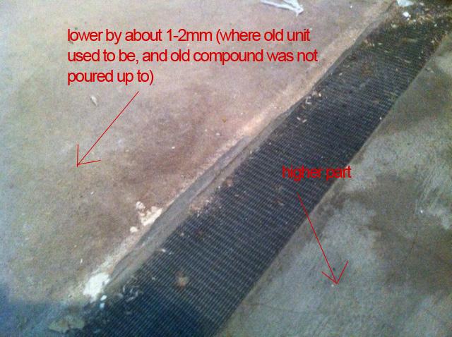

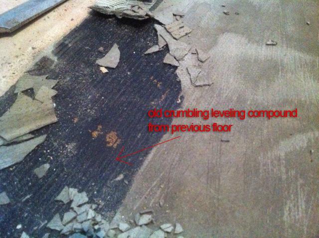

Hi all,
Re-doing our kitchen floor and its the first time I am tackling this type. The old flooring was vinyl sheet, and I am going to lay vinyl plank down in its place.
After removing the vinyl sheet, I found that self leveling compound was previously used. Another issue is that kitchen units have been moved around and the layout of the kitchen changed, so there are some areas that are lower now where the old kitchen units used to be placed (the compound was not poured in these places, so they are 1 or 2mm lower).
I have two questions:
1. Can I pour new self leveling compound over the existing (few years old) self leveling compound?
2. Should I rather just fill the gaps where the old units used to be with new compound to get them as close to the level of the existing stuff?
Couple of things I noticed: the old compound is crumbling a bit on the edges, and there is sticky tape/adhesive where the old vinyl flooring was held down - how should I handle these?
Here are some pics to illustrate the slightly lower part where old unit was placed, and the crumbling edges...
Good pictures them.
As long as the screed that's down is well bonded then you be better to
Scrape up any loose screed.
Prime the areas that aren't screeded
Screed the areas which have screed missing.
Prime the whole floor
Screed the floor.

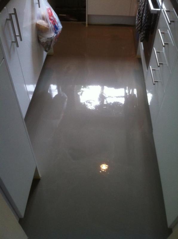

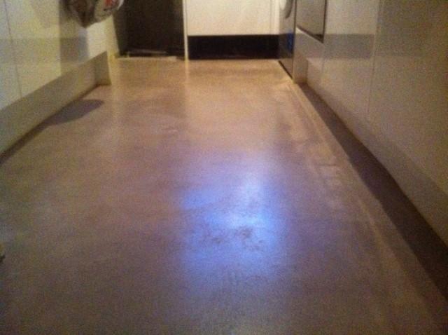

Progress...
Just put down the screed after having primed beneath. I went up to the edges of the plinth's after first masking the bottom of the plinth along all edges, and filling the gap between plinth and floor with silicone - so that none of the plinth soaked in any moisture from the new screed.
After a couple of hours it is looking dry, but I'll wait the full 24 hours before using the "Gerflor" primer that I got with the Gerflor vinyl planking on the surface of the new screed.
The levelling compound/screed I used is F-ball Stopgap 1200 Pro. Used a full 20KG bag along with the 5L liquid mix, bought a mixing paddle for my corded B&D drill from Screwfix to mix it all up for a 4 or 5 minutes, then poured it all down started at the back of the room, then moving back as I went. I had a plastering trowel to help spread it a bit, but I didn't need to use it a lot. No spiked roller unfortunately, but its looking smooth enough!
My idea is that the plinth helped me form a border so that I didn't run out of screed, and after this has dried I'll remove the plinth, and lay the vinyl plank flooring down so that it bleeds out under the plinth area by a couple of inches. Obviously it'll drop down a few mm's after it goes over the edge of the new screed, but that is fine, as the plinth will be covering that, but by doing this, it should look neat, and not be cut off right where the plinth starts, but rather flowing underneath the plinth. Does this sound like an OK plan ? :)

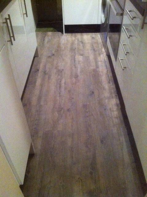

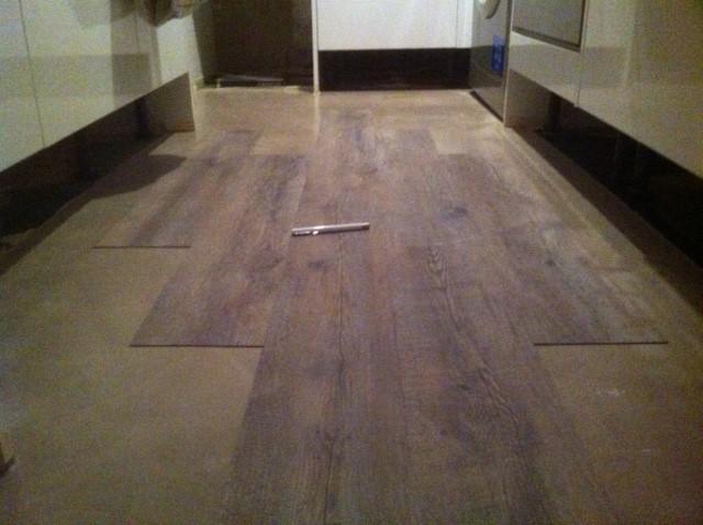

Well, I spent the whole of this evening after work putting down the vinyl planking. (Last night I put down the gerflor primer on top of the screed which had been down for about 30 hours prior).
Managed to finish everything. Just need to put the dishwasher back in place, and then sort out the plinth pieces. Here are the pics!
Primed with gerfloor primer:
Vinyl planking1:
Finished:
