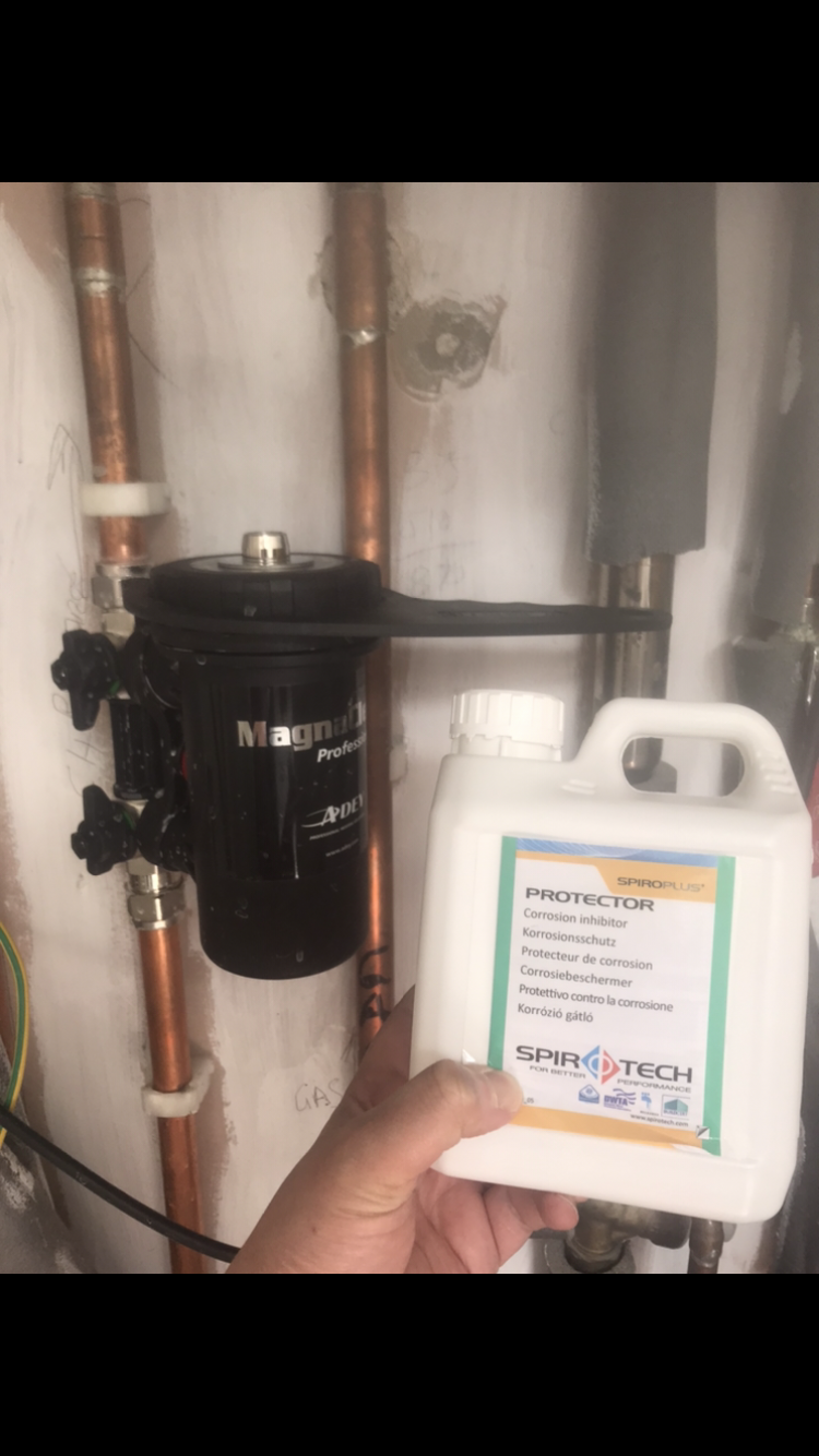

So I finally got it sorted after 2 weeks of no hot water and intermittent heating.
Had a power flush done at a cost of £470 for 13 radiators / towel rails. Each rad flushed individually whilst all the others were closed off (and the whole system rebalanced at the end obviously) with whatever chemical cleaner was used (Spirotech brand) and then the whole thing filled with 1.5 litres of Spiroplus corrosion inhibitor (half a litre left with me to top after we we have a new towel radiator fitted in a new weeks). He told me not to use F1 from Ferox as its cancerous.....not sure if I believe that otherwise they wouldnt be selling it, so will return to amazon whatever unused bottles I purchased.
He was a member of the powerflush association. Husband and wife team. Seems like many foreigners are getting in on this game as its good money for them. Used some big brand machine to power flush the system together with his own own pipe device system made up with valves on there to reverse the flow of mains water pressure into and out of the system and boiler which he isolated throughout until the very end when he flushed the boiler heat exchanger and plate heat exchanger.
After a lot of water consumed in the flushing and some 7 hours at the property, we now have a boiler operating properly without any error codes and water and heating very hot. He used a FLIR thermal camera to check all the radiators whilst balancing the system and installed an Aladdin auto vent valve for free on the highest radiator in the house (which is also the coldest double radiator in my loft room).
I paid an extra £150 for the supply and fit of a Magnaclear Professional 2 magnetic filter to the central heating return valve and replace that gold piece of **it which I thought was doing something but no, as others have said, it's not a magnetic filter. I'm annoyed that my gas safe engineer who fitted my expensive 34kw boiler only in 2018 fitted this spirotrap. My powerflush guy said they stopped making them in 2012 and are probably cheap cost that's way it was fitted. Cant believe for an extra £30 or whatever he could have installed something proper at the time.
Anyway, will be more cautious going forward about cleaning the filter regularly myself and now topping up the inhibitor once a year through the magnaclean filter.
