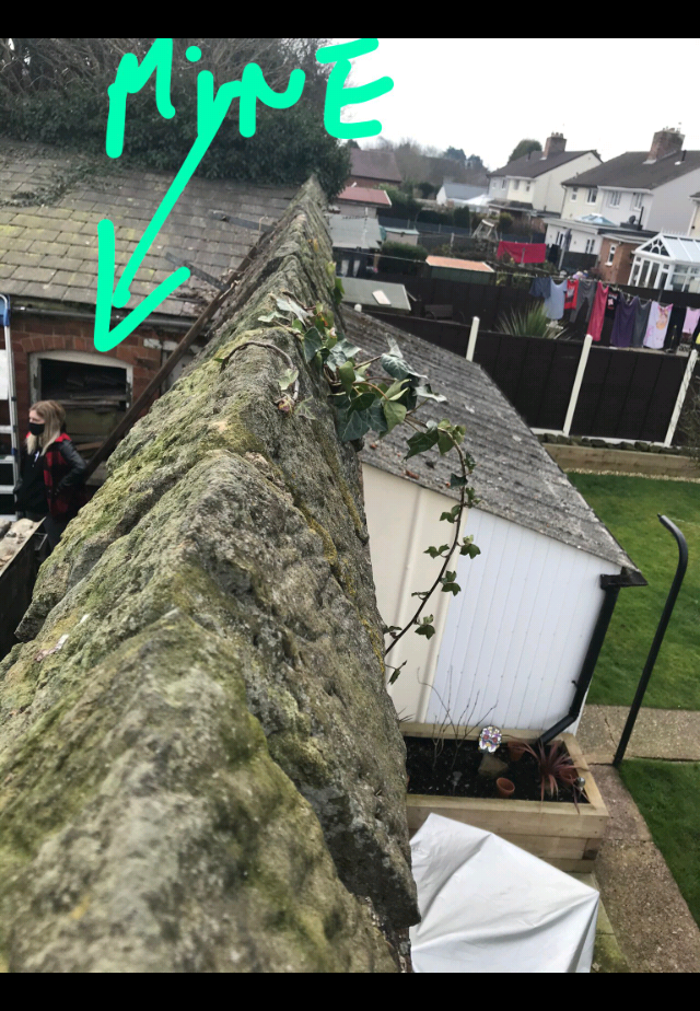

Also the neighbour has built a building and fixed it to my brother's wall

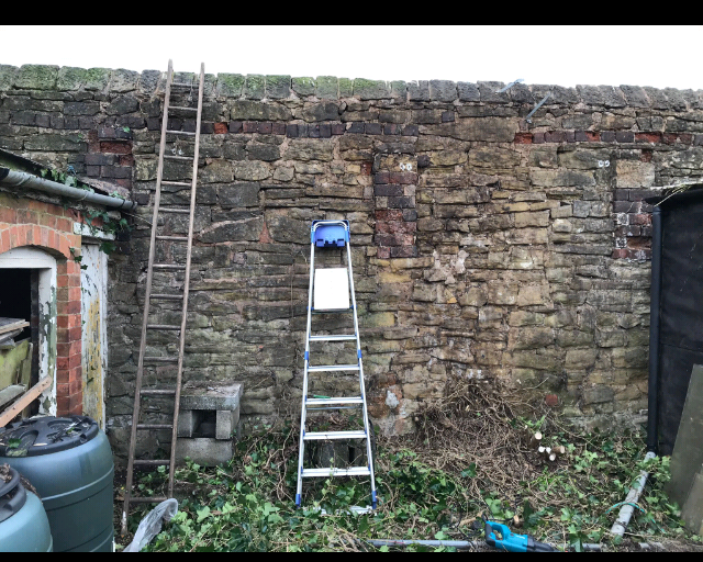

We sent a builder around and the builder said it needs a few replacement bricks and repointing some brick faces have shalled and it's.lime mortar
As a few bits of the mortar has dropped out.
Neighbour would like a pristine replacement wall
And won't allow us to repair as a good will gesture
He sent a so called structural engineer around who did not show any Id or company details and the neighbour accompanied him on the visit who did not take photos and came armed with a spirit level

And is around 11ft and made of stone 26 inches thick with a second brick skin on the complainants side. He has also fixed a building to the wall with a.
Lean to roof and channelled lead flashing into it.

Obviously if it was unsafe he would do something about it but he really thinks the neighbour just wants a nice new wall to match his nice garden.

When did this attached build happen- if before his purchase he's a little stuck, if after why did he permit it?
I have some.more information below
The structure was deemed safe , he just now wants to reduce the wall in height by 600mm with a builder of his choice and we pay half , which will affect our future planning permission . Also this will expose our current building as it reaches the top , his building is just a small 10x8 asbestos sheet shed which conveniently he wants the wall lowered to his roofline

Your brother should, if need be counterclaim for the trespass of the extension.
