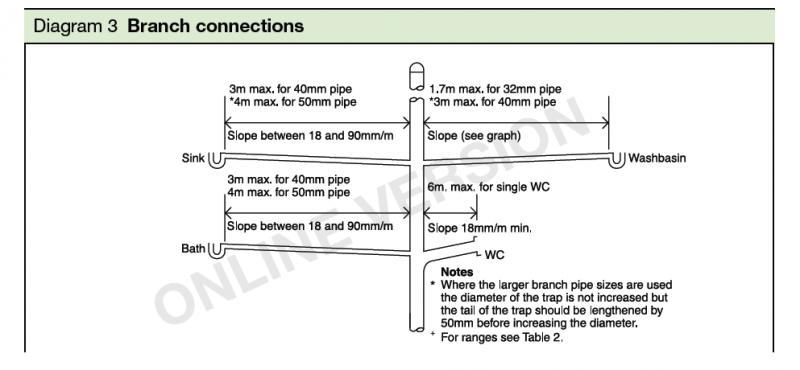

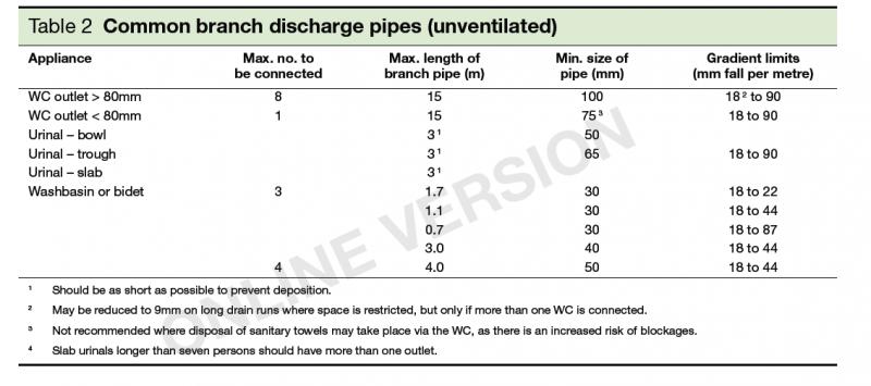

Hi, I'm confused now! I've had a look at section H and I don't understand it. On page 9, Table 2 seems to me to suggest that the maximum length of unventilated branch pipe is 15m, however Diagram 3 on the same page says it's 6m as Freddy said.
Please can somebody explain this to me?

I've attached pictures of Table 2 and Diagram 3.

That diagram is for a "single stack" setup - as is the large radius bend @ the bottom of the stack - another old chestnut ;) . A good rule of thumb is - get the vent into open air , AAV`s are for penny pinching New Build boxes
Its a one way valve that lets air into the head of the svp, without it, as you flush away an almighty turd and the 8 litres of water with it, can drag away the water traps in other services on the drain run.

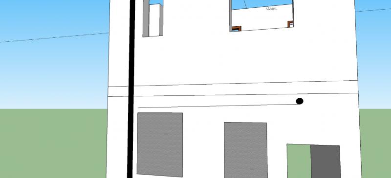

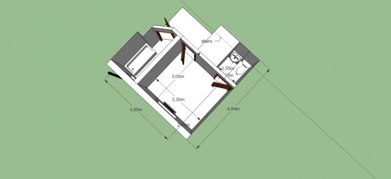

I assume mine is a 'single stack' setup. I've posted a couple of pictures of what I hope to do!
Ideally you need to get a vent behind or close to the WC - that`s a L-o-n-g run ;) you could reduce the vent to 3 inch ( I would ) but really you need to ask Build control ( they might OK an AAV ) I don`t do B.C on my houses - in fact I hate all bureaucrats :mrgreen: . Freddy is right although just the water flowing has the same effect ;)
