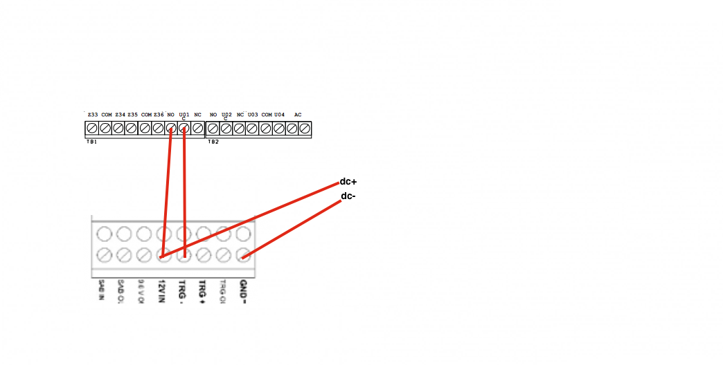

So like this then(ignoring the tamper for now):
1) Buy a separate 12V dc adapter.
2) + 12V DC adapter -> 12V in Inferno
3) - 12V DC adapter -> GND Inferno
4) TRG - Inferno -> U01C I/O expander
5) 12V in Inferno -> N.O I/O expander
Don’t I also need to connect TRG- with GND-?
1 power supply 12v will power both units ! Boxed with battery back up or it will not work in a power cut ! Plus the diagram is wrong you are putting 12+ Via the relay to trigger a 0v input ! Use either a 0v or connect to the + trigger input !

I'm still lost on the wiring unfortunately :-/ - It's almost greek to me, which it shouldn't be since I had an electronics class in the university(centuries ago). So I'm currently crawling the walk of shame.
In this image - I guess the inferno is the circle with X.
Basically I guess I should connect like this then:
For charging(not denoted in the picture I guess):
GND Inferno -> the negative AC on I/O (I'll have to find it using a multimeter right?)
postive AC on I/O -> 12V in on the inferno
For triggering:
TRG- on inferno -> N.O on Agility
UOC on Agility -> ??? on inferno - (Maybe also TRG- so the short circuit on closed, is that it?)

First thing .... If the risco I/Oncomes with a plug in power supply get rid and buy a boxed psu with a battery back up this will be 13.8v as most alarms run on this voltage the I/O will be fine and the inferno will be fine on this voltage. You will need minimum 1 x 6 core from your inferno to the I/O and 1 x 2 core from your psu
Do I need that for security reasons or because the plug-in psu won't cut it? What does 1x6 and 1x2 core mean?
