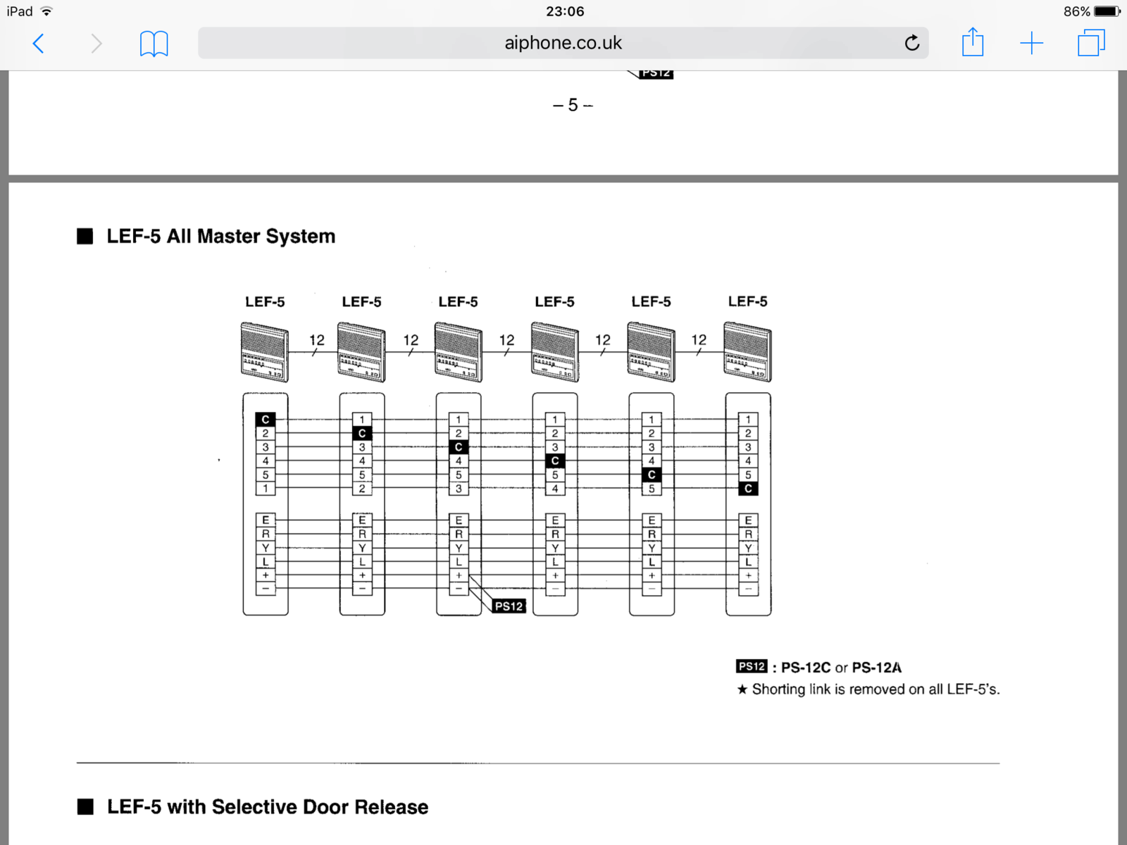

We have a LEF 5 with 5 units and want to add one. Desperatly looking for guidance or if someone can point is to an installer in London.
What are you wanting to add ? , been fitting aiphone equipment for years ( pretty bulletproof ) most stuff is pretty straightforword and manuals available online
Got a LEF 5C.
Doorbell + 4 units with latch release.
Now want to add another master to our extension.
I understand that these are daisychained.
I have located the unit with only one set of cable so that must be the last one.
My questions:
Is it correct that I need to run a cable from there to new location?
What cable should I run? How many cores? Would cat5 work?
What do I need to connect in the other units so that they recognise new device?

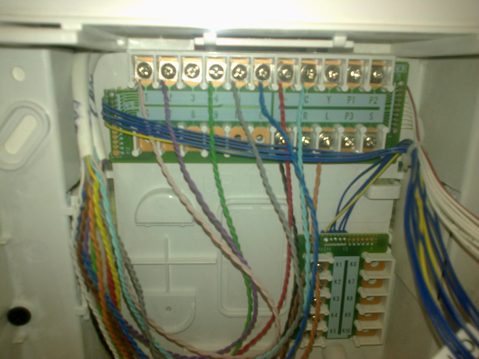

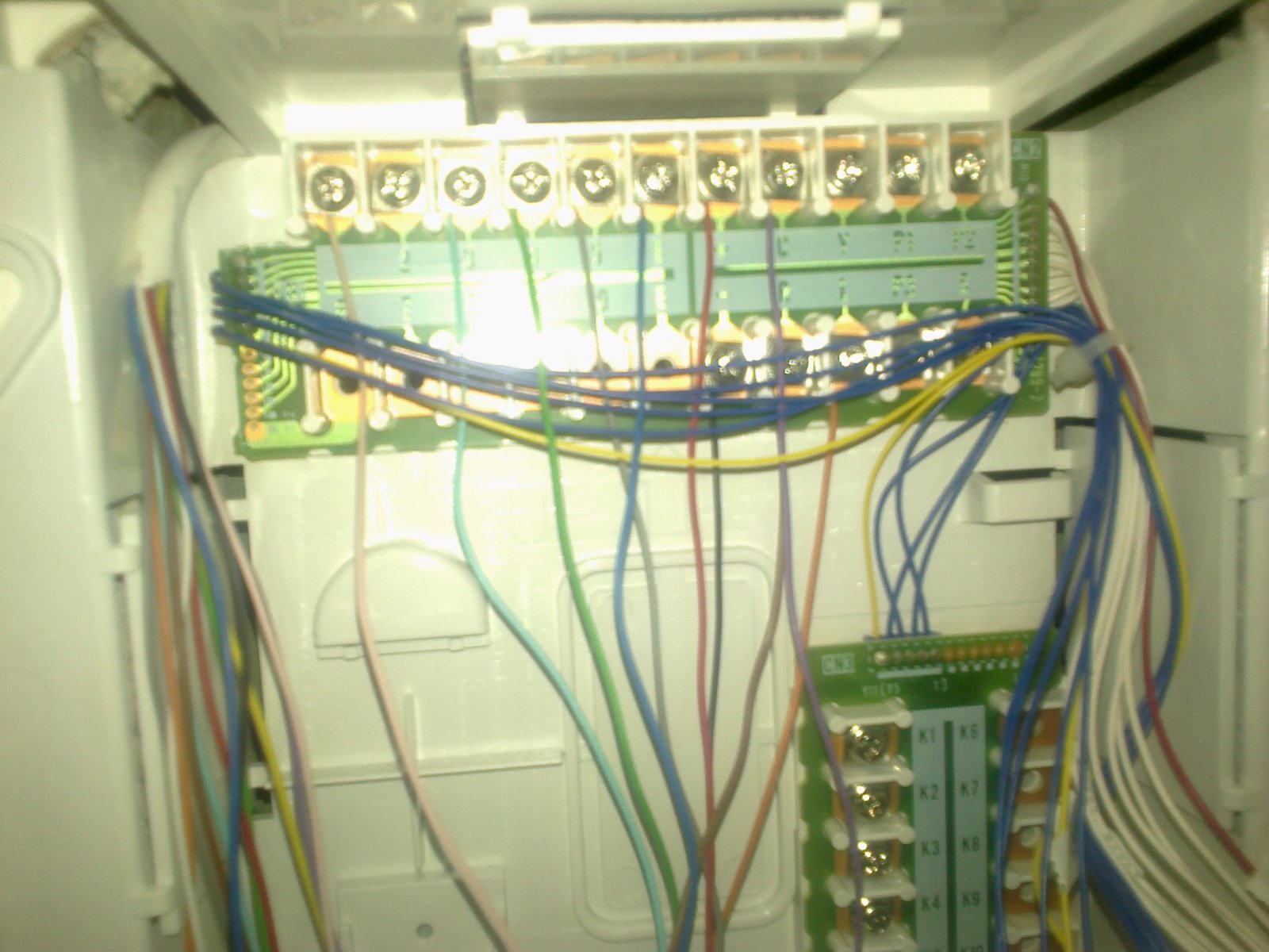

Picture below of unit 3 and what I assume to be last unit as no doubled over cables

Am I correct in assuming that the unit with just one set of cables is the last one in the series and I should be running the cable for next one from there? (It is actually number 2 but if I have understood correctly, the wiring is the thing that determines which is last unit - not the connector number).
So what I would do is:
Run cable from last unit
Find an unused colour of the 12 cores (white)
Connect it to new unit C
In source unit twist its white with incoming white and connect to its empty connector which is available as it is that units own number and so on to all units?
You would wire daisy chain as above or they use to do a joint box where you could wire all the units in a star configuration, the wiring determines the unit number !
I undertand, but if I have a unit wired as in picture 2, would that mean that it is the final unit on the daisy chain and I should/could wire from there?
It would actually suit me better to wire star config. I originally thought the the system worked on a star configetration from under the stairs because installer had 2 junction blocks there - and I ran a CAT 5 from there.
The reason I made this assumption is because I believe doorbell and unit 1 join up in a junction box under stairs and that is where the power is. Could I add the sixth unit by just starring out from there?
Would CAT5 cable work?
3 issues ....need more cores , it will get confusing swopping colours , I think the install manual says avoid using twisted pairs !
Thanks so much. Managed to wire as per your advice in star from junction box and all working.
