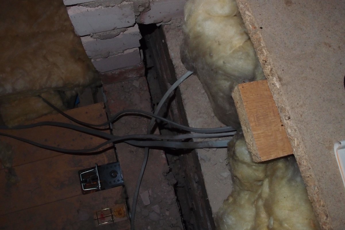

My house has been extended and one original cavity outside wall is now an internal wall. The pitched roof has also been extended.
In the attic the top of the cavity on this wall is now exposed and open, see photo, should I close the cavity in the attic, if so how?
The reasons for asking, keeping the house warmer and we have a mouse problem in the attic. I think that mice are getting into the cavity, possibly through the air bricks and up through the wall to the attic.
