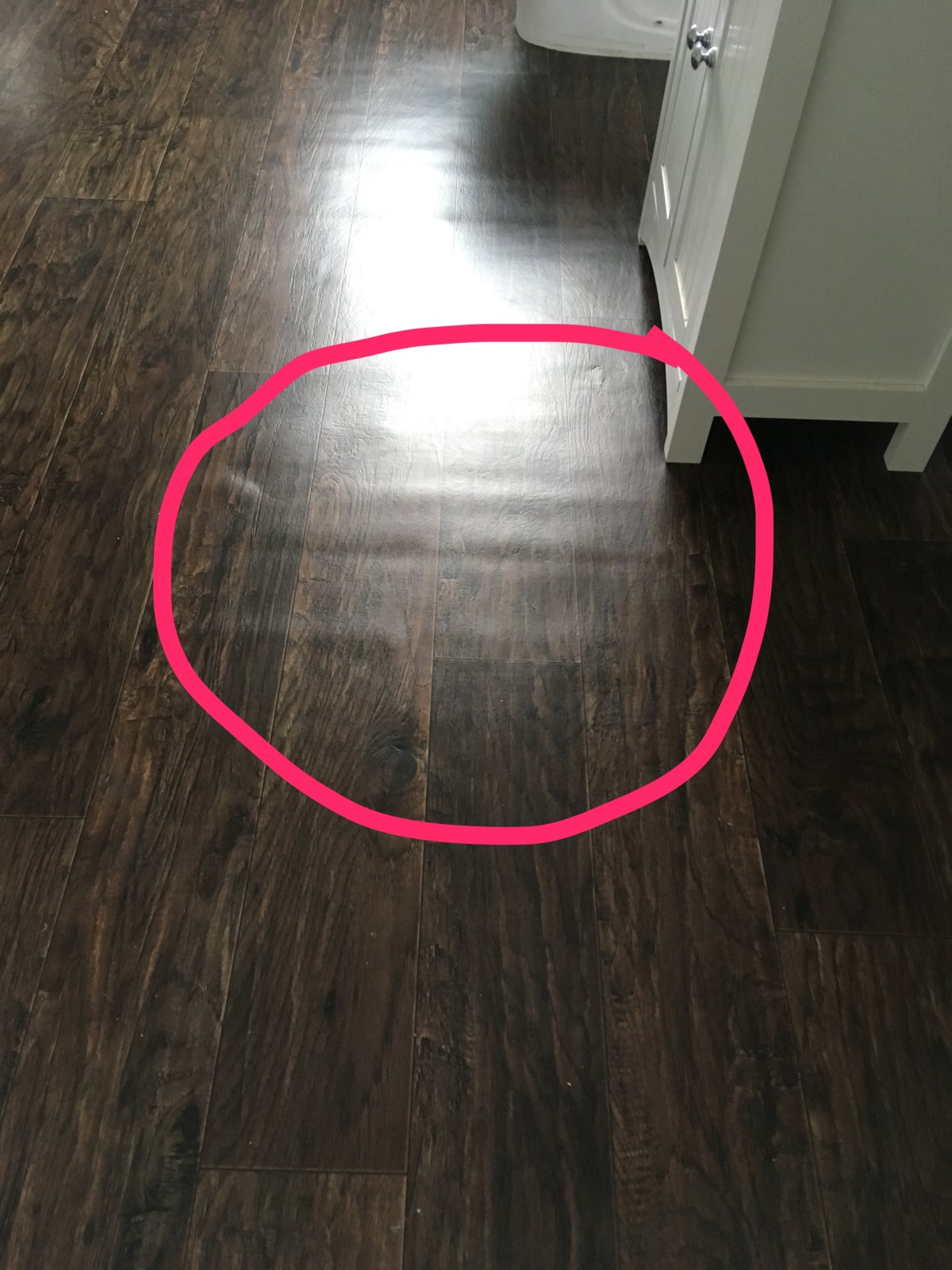

Just had some Lino laid in the bathroom. It was the most expensive stuff and pretty thick. Guys have just left but there seems to be air pockets. Will this go down over time or is there a way to fix it. It's kind of annoying me.
Those lines look very regular; how flat was the floor before they laid it, and did you have hardboard or plywood put down first. If they are air pockets, then I'd get the fitters back, and if it was laid direct onto floorboards, then I'd get them to lift it, and lay some first before it goes back down.
Hi I put plywood down and it was flat. I can move the air pockets about with my hands
Then how come all the regular lines that look like floorboards. If you can move the air pockets around, then they haven't laid the lino properly, or it's faulty as it should lay flat as it goes.
