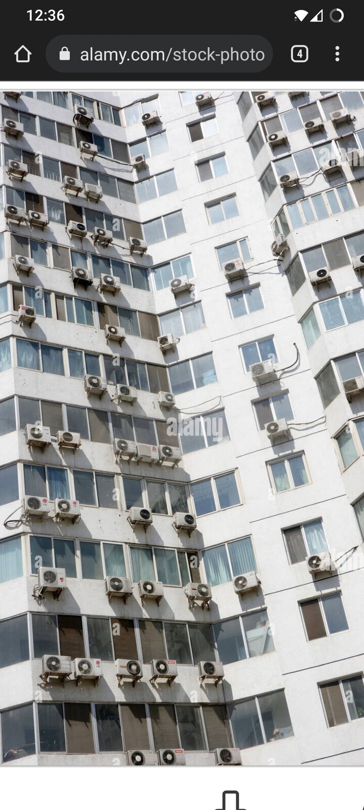

Assuming there is a suitable location for the evaporator ( out door unit ). There is of course the possibility of the evaporator being inside the property and ducts to link it to the air outside the house. For many flat dwellers this would be the only option if retro fitting an ASHP.
Welcome to the future.
To be honest for high rises like that, I'd not recommend individual air source, a building like that would be far better suited to a communal/district heating system with one commercial plant area and heat metered hot water feeds to the individual buildings.
There are blocks where the ASPHs are fitted on the roof and fed down into the flats which works well as far as keeping them out of sight, access, and maintenance costs, the ones pictured there are likely air to air units which domestically we rarely use in this country.
