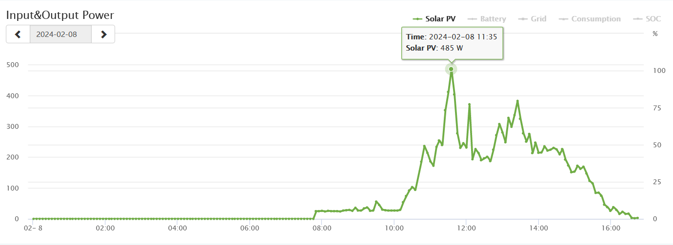

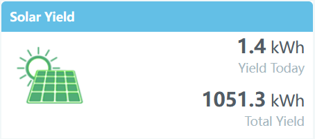

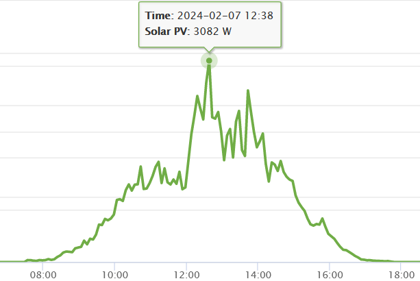

Today I have 6 kW of solar panels, and a 3.2 kW battery, so with a power cut I stand a chance of keeping the central heating running, however today this 1707410922331.png is my solar PV, and 485 Watt will not even keep back ground stuff running, never mind a heat pump. Here is total 1707411063574.png for the day, yesterday was good day for solar, it peaked far higher 1707411194429.png but still unlikely to power a heat pump for long. My battery will charge at 2 kW and discharge at 3 kW this is enough to span the peaks and troughs, but to store on good days and use on poor it would need to be 10 times that size, the idea is once a battery and solar are fitted, one can buy electric at a cheaper rate over night, so the battery can be topped up over night, and you can export during the day, so battery does not really need to be that big, it is a tick the box exercise.

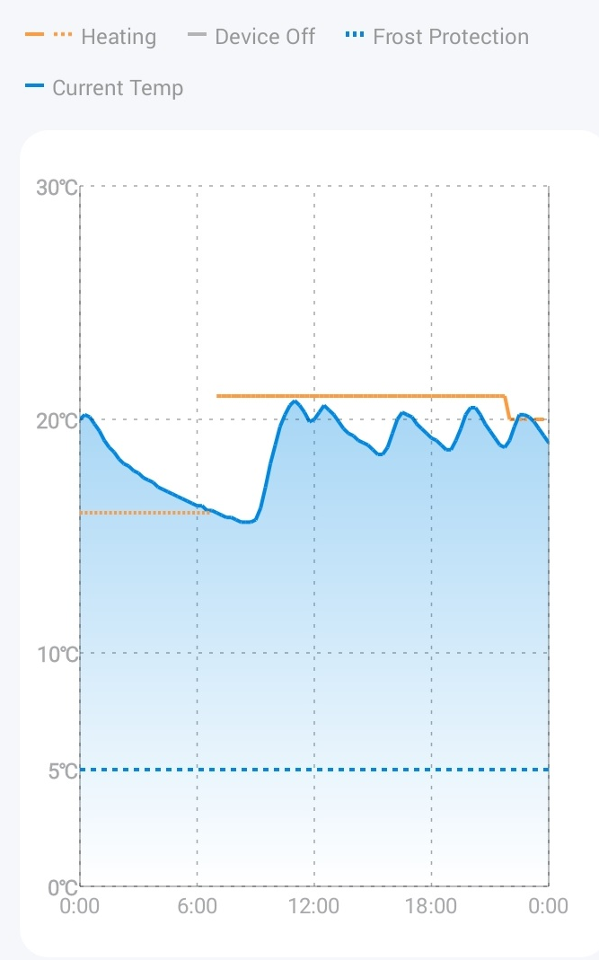

So over night my heating goes off at 15 minutes past midnight and comes on again at 8 am, the TRV in the living room actually records the temperature as a graph, so I have this 1707412770978.png report, it was 11 am before the room had recovered, and one can see it cooled to around 15ºC. And one can also see how the hotter it was, the quicker the temperature decayed. So even if you only drop the temperature by a few degrees, you can save a lot of energy, I am not an early riser, so 11 am for me is fine. But using a heat pump it would double the recovery time so 2 pm before recovered, that is simply too long. However if I reduced losses by half then it would be a faster recovery, but so would the oil fired boiler, so could set it to start at 9:30 am instead of 8 am so I would save even more.
