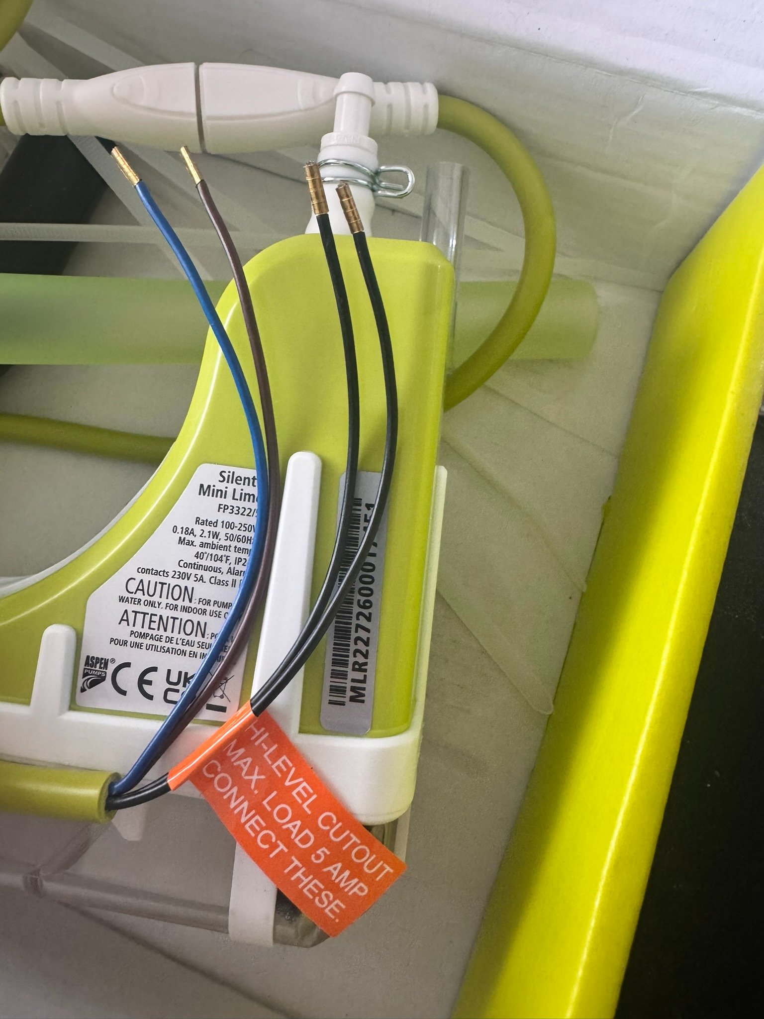

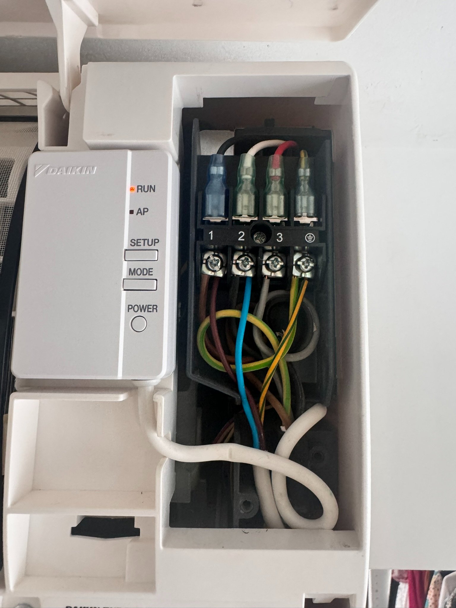

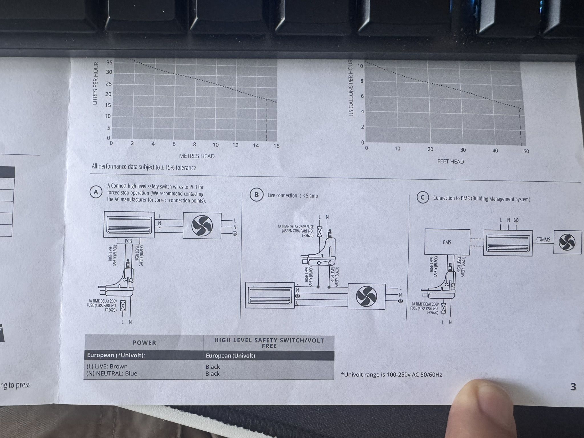

I have an aspen mini pump for an AC unit to remove condensing water (travels up into the ceiling). Anyone have a clue how i should wire this into a daikin ac unit.
I think i need to
pump brown to terminal 1 AC
pump blue to terminal 2 AC
disconnect terminal 3 AC grey - connect to pump black with terminal block.
2nd pump black - connect to terminal 3 AC
