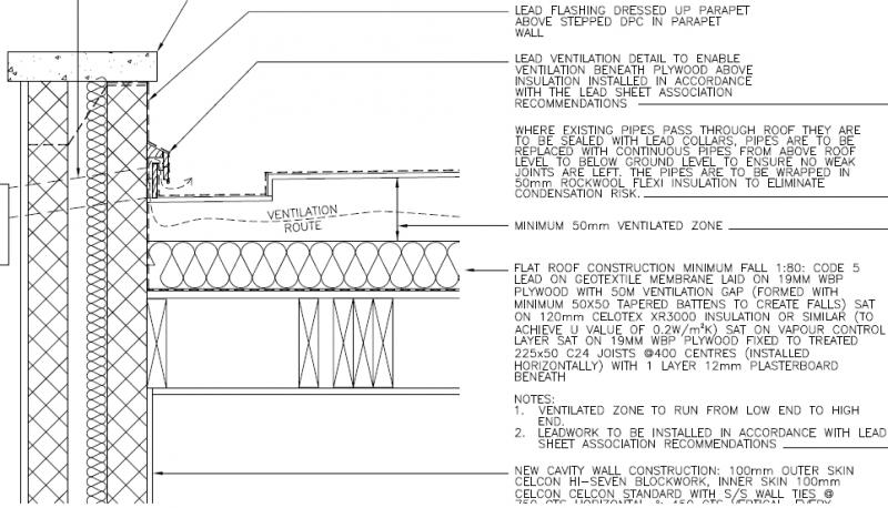

All lead flat roof?
Indy,
Saw your post few days ago, but recently seem to get more bad days than good days, so am only just answering.
Regard your question. The breather membrane is a secondary line pf defence for water shedding. The 50mm air gap is for possible interstitial condensation leading to oxidisation and deterioration of lead cap..
Agree, if you have deep pockets lead cap is the best, and will last you a life time, providing that you sleep on it every night and buy a lion with big mane on running chain for day time protection, that is providing your trouble and strife likes big cats.
Due to lack of detail, can not comment any further Indy with regard to insulation. Construction, etc, except, construction is lot more complicated than straight forward felt or EPDM deck and with snow load, you are pitting fair weight up there even with code 5.
If it was mine Indy, I would go with EPDM, as it is only the birds that will see it and it will be half the price.
If you still want lead cap,
Regards oldun
Just noticed you have mentioned VCB. Yes, you need it, but there are various ways of doing it depending on cap and how much you want to spend.[wiki][/wiki]

The lead association does recommend the 50mm ventilation as did another lead specialist I contacted. So on balance given how much the lead costs and how little work the ventilation takes it would seem sensible just to vent.
@FMT,
I read up on your old post regarding the need for ventilation directly under the lead, even when adopting a warm roof.
When you asked the lead people why it needed venting, and what difference it was to a conventional warm roof, their reply was:
'because it's lead and impermeable'.
This struck me as odd. Logic dictates that you could equally well say that about bituminous felt, or asphalt, or EPDM, or whatever. Just seems strange that if you have a vapour barrier below the insulant, that lead is the only material that seems to need this additional ventilation above the insulant as well.
If it's to stop corrosion of the lead, as the experienced plumber in that thread said, then it makes you wonder just how durable this material is in warm-roof situations.
Just thinking aloud!
I recall from when I was posting in that thread that condensation gathering on unventilated lead (ie underneath) causes corrosion because the condensation is effectively pure water and it lacks the carbon dioxide content of rainwater and so the process whereby the natural protection builds up on the exposed surface (exposed to the elements) cannot occur on the underside and is thus more vulnerable to corrosion, unless it is ventilated of course.
Generally a vapour barrier is not 100% resistant to vapour passing through it with all the joints and fixings penetrating it so without venting there will be a possibility of condensation occurring on its underside. Above a bathroom or kitchen and maybe with some downlighters the problem is exacerbated further.
But bituminous felt, or asphalt, or EPDM are nothing like £200/m² and you would not expect them to have anything like the lifespan of lead. The same principle (ie a vent under the surface) is engaged on a zinc roof.
This is still a warm roof (just detailed correctly), its just that there's a ventilated gap above the insulation.
If you put lead on a warm roof without venting it then I think the temperature would fluctuate to much causing it to fail earlier, the gap would help to stabilise that effect.

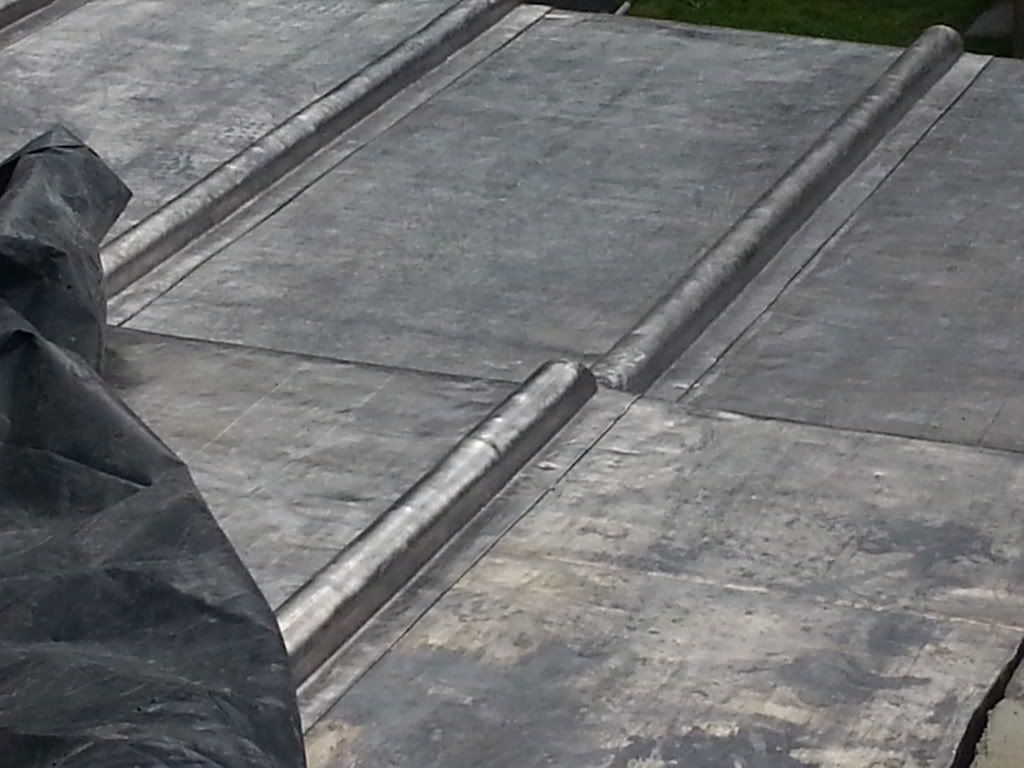

Quick update. I did go for the all lead roof and though not finished yet it looks gorgeous!
Thanks for the advice and especially to Xenon for the recommendation.
