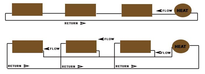

Yep, he has not kept the flow and return pipes he has just plumbed in one end of the flow into the bathroom and then run it out to the next rad.
You had the bottom one now you the top one, shut off the first rad and with trv's on the other rads the system has to run in reverse..........you could just run the bathroom one all the time and the rest would work as normal.
I've just had a talk with him. He claims they didn't touch any of it, but believes that one of the guys may have accidentally swapped the flow pipes on the boiler side after they finished moving the radiator. That... would explain a lot, especially if that one and the three cold ones are on a separate circuit. Let's see.

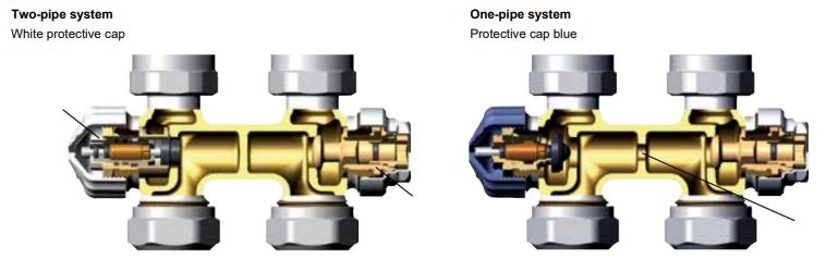

So, turns out the actual problem was the 2-pipe valve which lacked a bypass that would allow the hot water to flow to the other radiators with the TRV closed.
