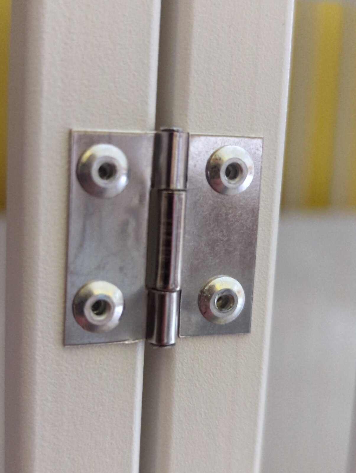

What do I need to detach this hinge? Triedy smallest and second smallest Allan keys but they were too small and too big respectively
I'm not even sure an AK is the right thing for them.
Can anyone advise?
Cheers in advance!

They look like pop rivets so, you can either drill the heads off them or, file the hinge pin flat at the top or bottom and then punch it out.
It all depends on why you want the door off.

Metal dog crate door
Trying to reverse the door so it opens on the other side
Then I agree with Stivino.
If you use a conical drill, like a countersinker, it will self centre and take the head off. Stop the moment the head starts to spin.
It looks like you could reassemble with small nuts and bolts. A DIY pop riveter will not do such a neat job.
