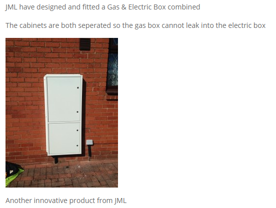

I was reading a post where some one asked the question of distance between gas and electric meter boxes in a house wall, there were a lot of sarcastic answers like 2 meters and depends of size of gas meter etc, but one guy did post a link, it does seem there is some debate, and the link came up with so many options it was near unreadable, but it did seem there is a limit of 2 foot, but then further reading and it becomes unclear who has come up with the distance and I really don't know the answer.

I know nothing of the gas regulations but, for what it's worth, the infamous OSG says that (without either meter being in any sort of enclosure) "electricity supply equipment, e.g. metering equipment, ..." should be at least 150mm from a gas meter - and I see no real reason why it would require greater separation than that if the meters were on an exterior wall, and in separate cabinets!
Having said that, I wonder if/how your thinking about 'separation of meter boxes' might be influenced by ...
Kind Regards, John

As I said, for what it's worth the OSG says that an electricity meter (or cutout, CU or main isolation switche) should be at least 150mm from a gas meter, but that's all.
