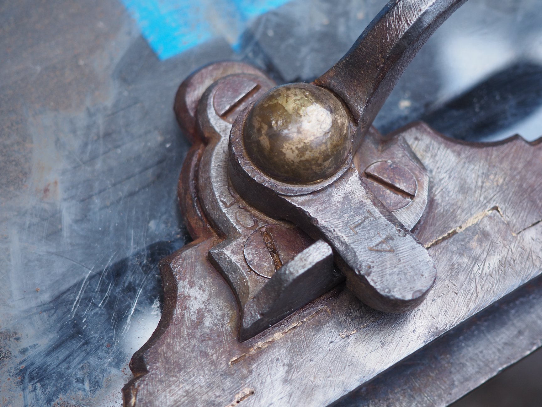

Hello,
I am in the process of refurbishing the first of many metal windows in my house. I'm using this first one as a kind of experiment to find the best way of going about it. So far I've:
  • Removed the casement/opener.
  • Had it dipped to remove the paint.
  • Primed it with Rustoleum 1085 Hard Hat Galva Zinc Cold Galvanising paint.
  • Read that the top coat should be a "non-saponifiable coating". Ignored that, because apparently nobody knows what non-saponifiable means, and plan to overcoat it with a bog-standard external satin white for wood & metal (I've painted one of the edges, and it doesn't go on very nicely, but I'm hoping a couple of coats will do the job).
I need to replace some of the putty, and wondered if using a 2-part wood filler would do the job? I assume it'd be stronger than putty, and I wouldn't have to wait a week+ for it to cure before painting. Is that a crazy idea? Or should I just get some proper putty for metal windows like this: https://www.reddiseals.com/product/rapid-set-putty/ and be more patient before painting? That putty claims to last for 10 years, which doesn't seem very long. I assume a 2-part filler (eg. that Ronseal stuff) would last longer?
I was tempted to use some Owatrol oil (https://www.owatroldirect.co.uk/product/owatrol-oil/) and keep the unpainted rusty steampunk look, but it wouldn't be in keeping with the style of the house. I'm keeping the brassy bit unpainted though - I think it's gorgeous!
