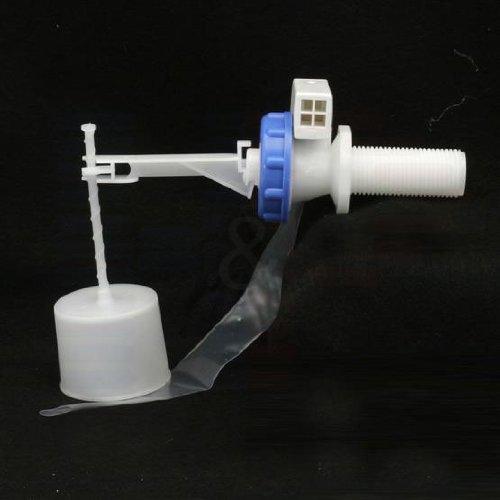

I took the advice above and was looking on Amazon for Torbeck-Opella products and came across (hopefully) the image below.
There seems to be a flexible tube of some sort attached to the inlet tap. This appears to my untrained eye to be the sort of thing i am seeking for my cold water system.
Is this the actual purpose of it and is it legal under water regs. I realise this particular product is for toilet cisterns but if I'm on the right track I will keep going re Cold Water tank.

Good choice Alan, you are now the proud owner of a non compliant ballvalve. :LOL: or have they changed the water regs.
Joyously I'm not the owner ... Amazon.co.UK is. Haven't bought anything yet.
And in relation to Regs, that was one of the points namely, will it work and is it legal. I keep reading about rigid tubes, but this is flexible?
Al
as myself & DIA have already said that's not suitable for a roof tank

It wasn't this valve I was considering (clearly not suitable) it was the particular flexible attachment tube and its usefulness / legality.
