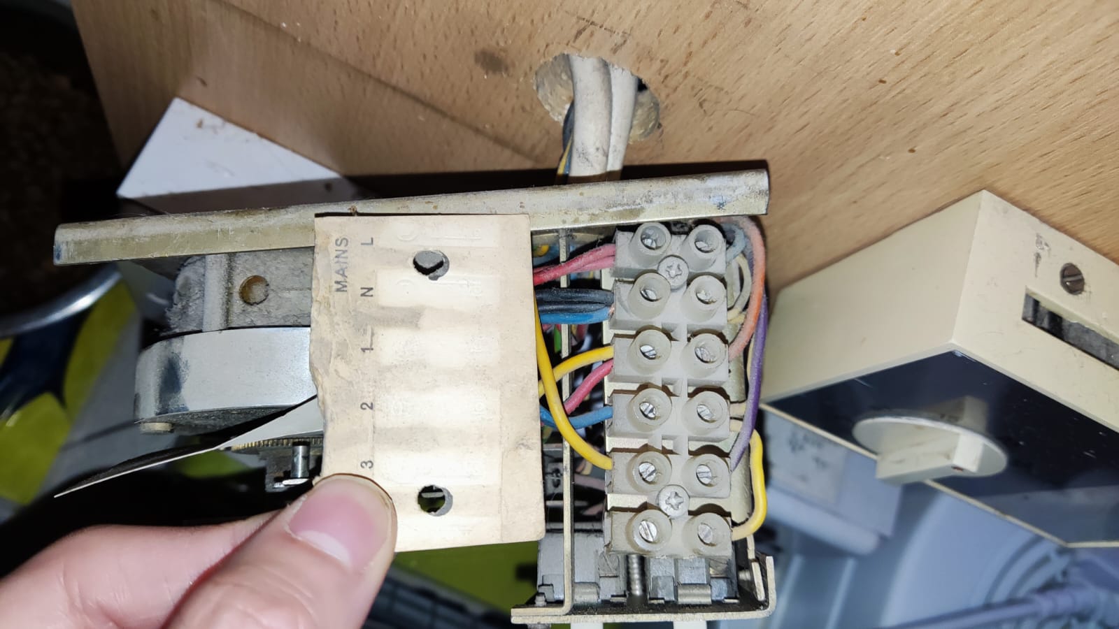

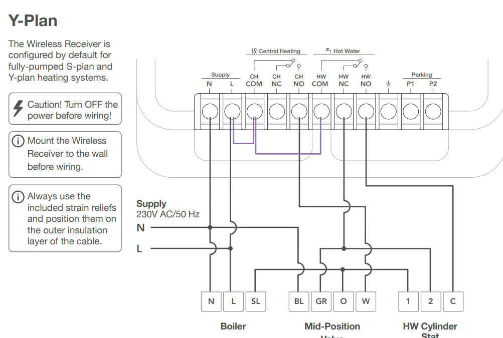

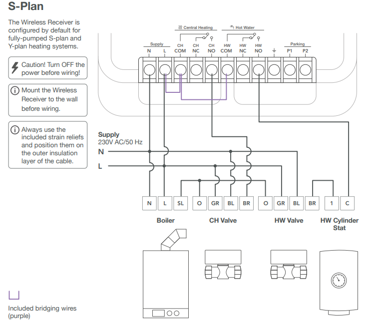

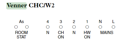

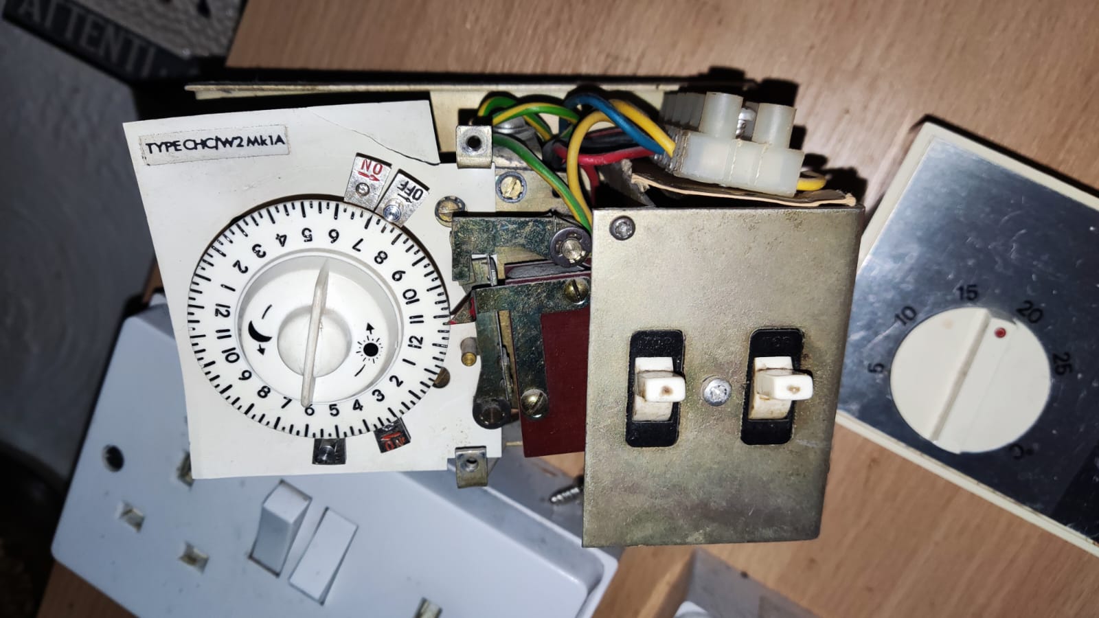

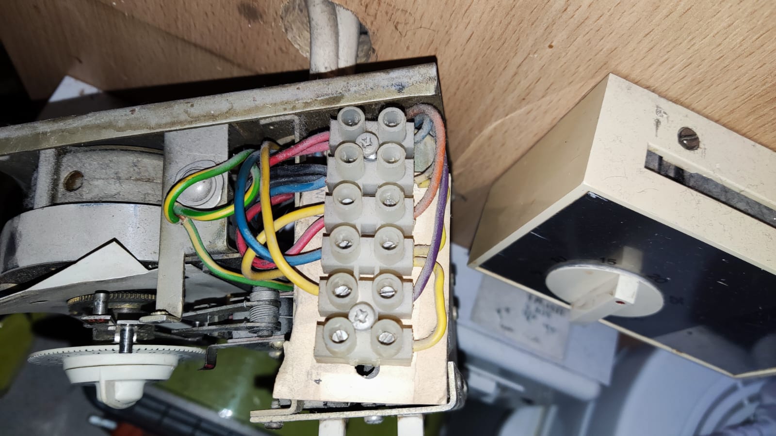

I've recently bought a Tado thermostat with Hot water to replace a very old (90s) AMF Venner CHC/W2 programmer. Problem is I cannot fathom the wiring and thought if I put all of what I know together, someone with the knowledge would be able to help me!
I can't seem to find a wiring diagram for the programmer, but I was able to find replacement programmer diagrams from Danfoss, which may be able to help work out the wires.
