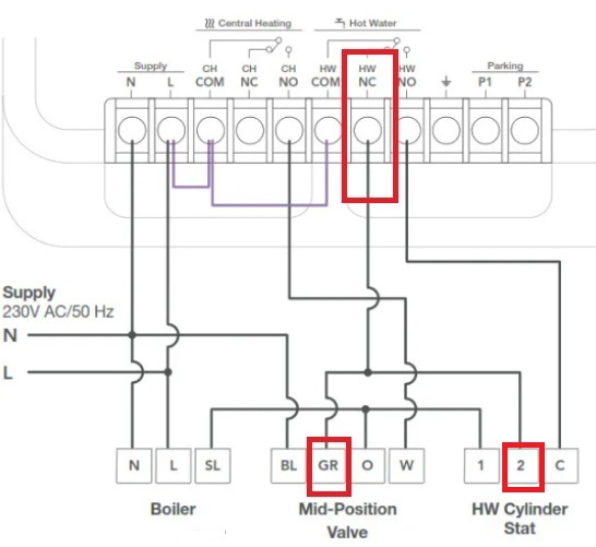

First of all the ESi has two heating zones plus hot water. the Tado only has one heating zone plus hot water, so I assume that you are presently only using one of the heating zones of the ESi. If you are using both central heating zones of the ESi then something is not right. A 3-Port valve will not work with a 2 zone heating system.
If you do have a Y-Plan and only one heating zone, then:

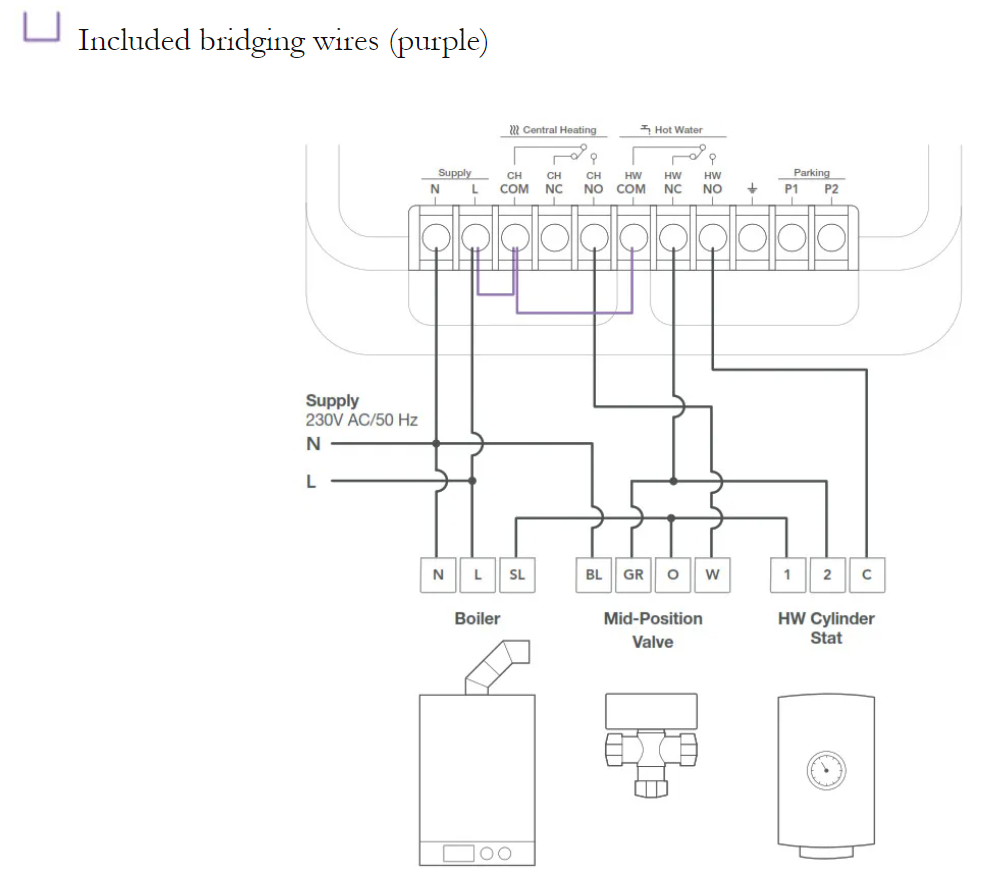

The Tado replaces the 3 channel programmer. If your existing programmer is as below, you should have wires in the ESi programmer terminals N, L, 1, 3, & 4.
If so, these wires would the move over to the Tado terminals that have the same function as follows:
ESi N = Tado N
ESi L = Tado L
ESi 1 Hot Water Off = Tado HW NC
ESi 3 Hot Water On = Tado HW NO
ESi 4 CH 1 On = Tado CH NO
Add the purple bridging links between L and the Com terminals

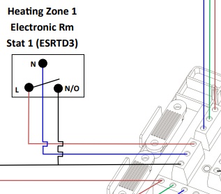

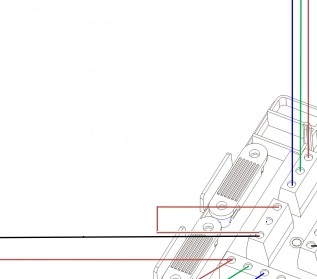

The existing room thermostat can be left in place and set to maximum to prevent it interfering with the Tado, or you can remove it and insert a link to join the terminals on the control PCB where the two live switching wires have been removed from.
so:
Becomes:
The black wire shown above in the same terminal as one side of the link may not be present if you don't have a frost thermostat fitted.

For a Mid-Position valve to work you need a 'Hot Water Off' connection which would be from terminal 1. This is why I questioned if that's what you have. Mid Position valves don't work properly without a Hot Water off connection from both the programmer and the HW Stat to its grey wire. This is shown in the Tado diagram
However, an S-Plan system with two x 2-Port valves would only use the 4 terminals that you mention. N , L , 3 and 4
Do i still need to insert a link as you have previously mentioned once the old wired thermostat is removed as part of the install of the Tado?
You can't have two thermostats trying to control the same heating, they will fight with each other, so either remove the old thermostat as per the drawing and insert the link, or leave it in place and set it to maximum.
If you were just to remove the old thermostat the wiring would be left 'open circuit' and wouldn't work with the Tado, hence the link
