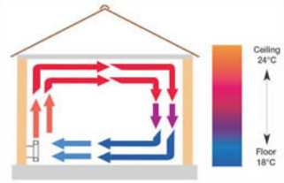

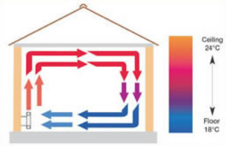

The circulation.jpg picture shows the circulation of warm air in the room, and the TRV is in about the best place to monitor the return air temperature, it could be on wall opposite to radiator, and it may mean the TRV is set a little lower to what you would set the wall thermostat, but question one has to be, is there some where on the wall opposite where the thermostat can be mounted?

The View attachment 362114 picture shows the circulation of warm air in the room, and the TRV is in about the best place to monitor the return air temperature, it could be on wall opposite to radiator, and it may mean the TRV is set a little lower to what you would set the wall thermostat, but question one has to be, is there some where on the wall opposite where the thermostat can be mounted?

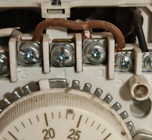

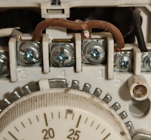

The reason that I think that it's the thermostat unit is because the light on it was flickering on and off a lot when I was turning the dial the other day. Then the light just went off and hasn't come back on. You could still make a case for it being something else but I'm not sure how I would check. Is there a way of by passing the thermostat and checking if the heating still works?
That does sound like the thermostat. The easiest test is to connect the thermostat's live and switched live wires together. That takes the thermostat out of the circuit and if the heating comes on then then it will confirm there is a problem with the thermostat.
With regard to your photo of the thermostat wiring, the live will be the brown wire in terminal 1 and the switched live the grey in terminal 3.

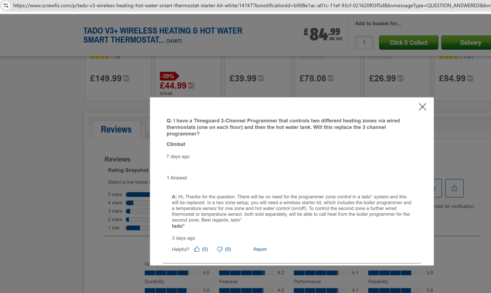

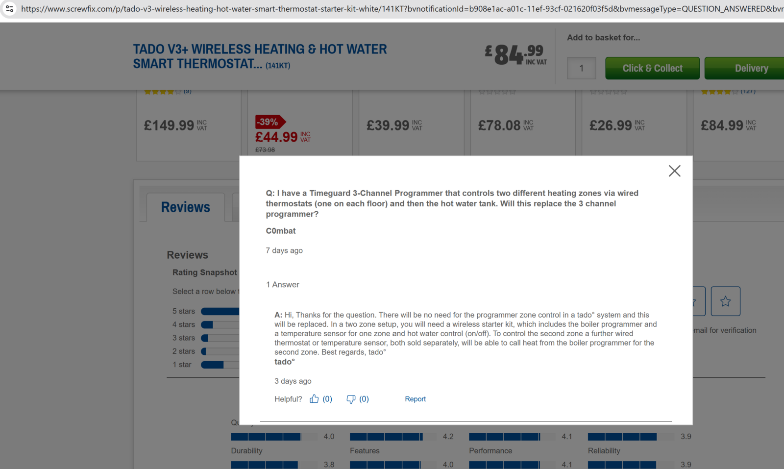

Further to the above, I posted the attached question to the screwfix website last week, prior to purchasing the V3+ wireless kit. I'm now trying to install the kit and when I search for the existing programmer model in the app it's telling me that the Timeguard TRT038 is not compatible. So Tado lied to me. Not only have I wasted £84.99 at screwfix but I've also spent a further £60 on an additional wired thermostat on eBay, like they told me to. I had my doubts about this from the start but what can I do when the actual manufacturer feeds you lies?
Unless the app is wrong and there is a way of choosing a 3 channel programmer alternative in the app to get the right instructions?
Not sure of the relevance of that. The Timeguard would be removed when the Tado is installed, so it doesn't need to be compatible. :unsure:
From the information you've given the advice from Tado sounds correct to me.
You're saying that the brown going in to terminal 1 is live and the grey in terminal 3 is switched live?
Yes. There should be a wiring diagram inside the thermostat cover showing this.
Do I just throw away the brown wire that is connecting 3 to 5? And what is the black wire then? Neutral?
They are there to operate the little light that shows when the thermostat is calling for heat, and not required for the test I suggested.
And there's no Earth? I'm confused and worried about misunderstanding which wire is which and blowing something up lol.
Appliances that are double insulated, do not have an earth connection.
