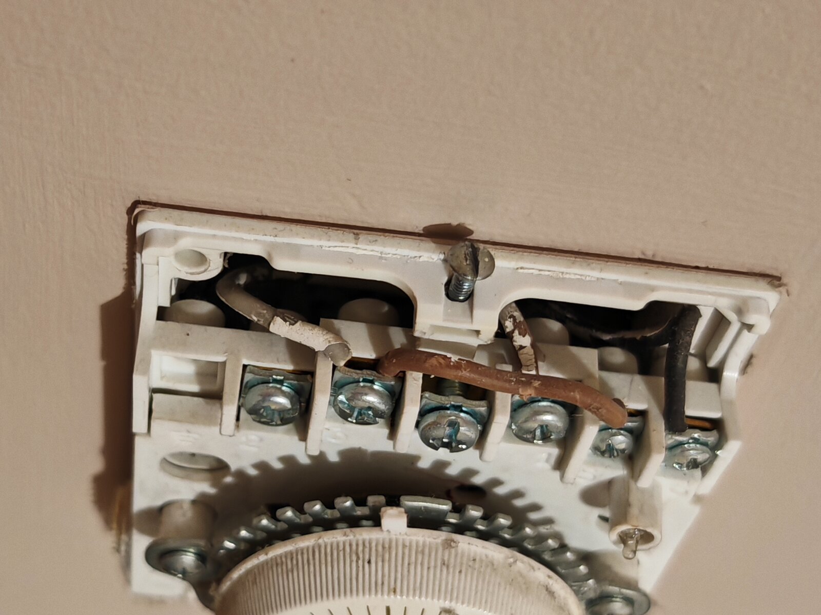

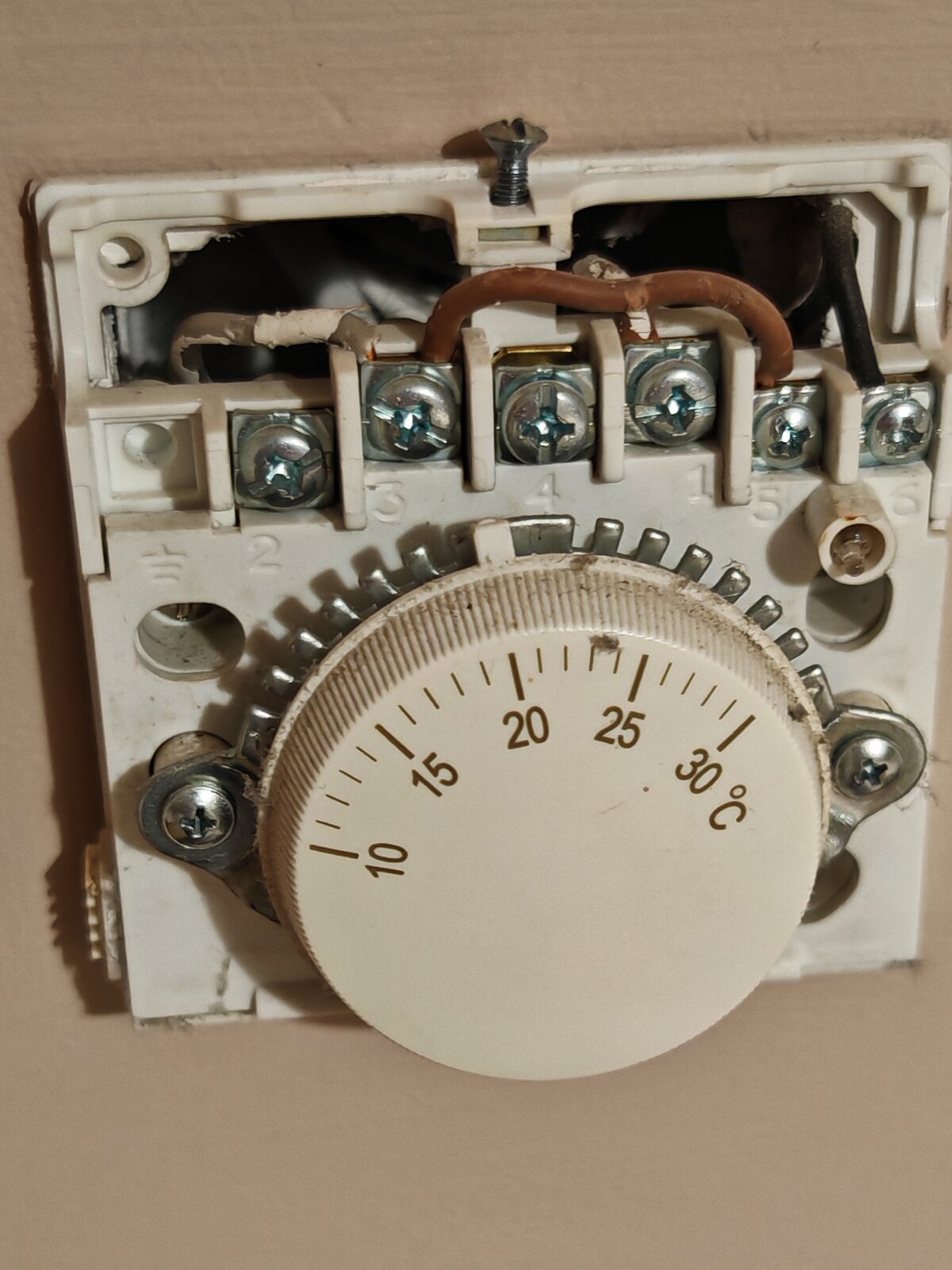

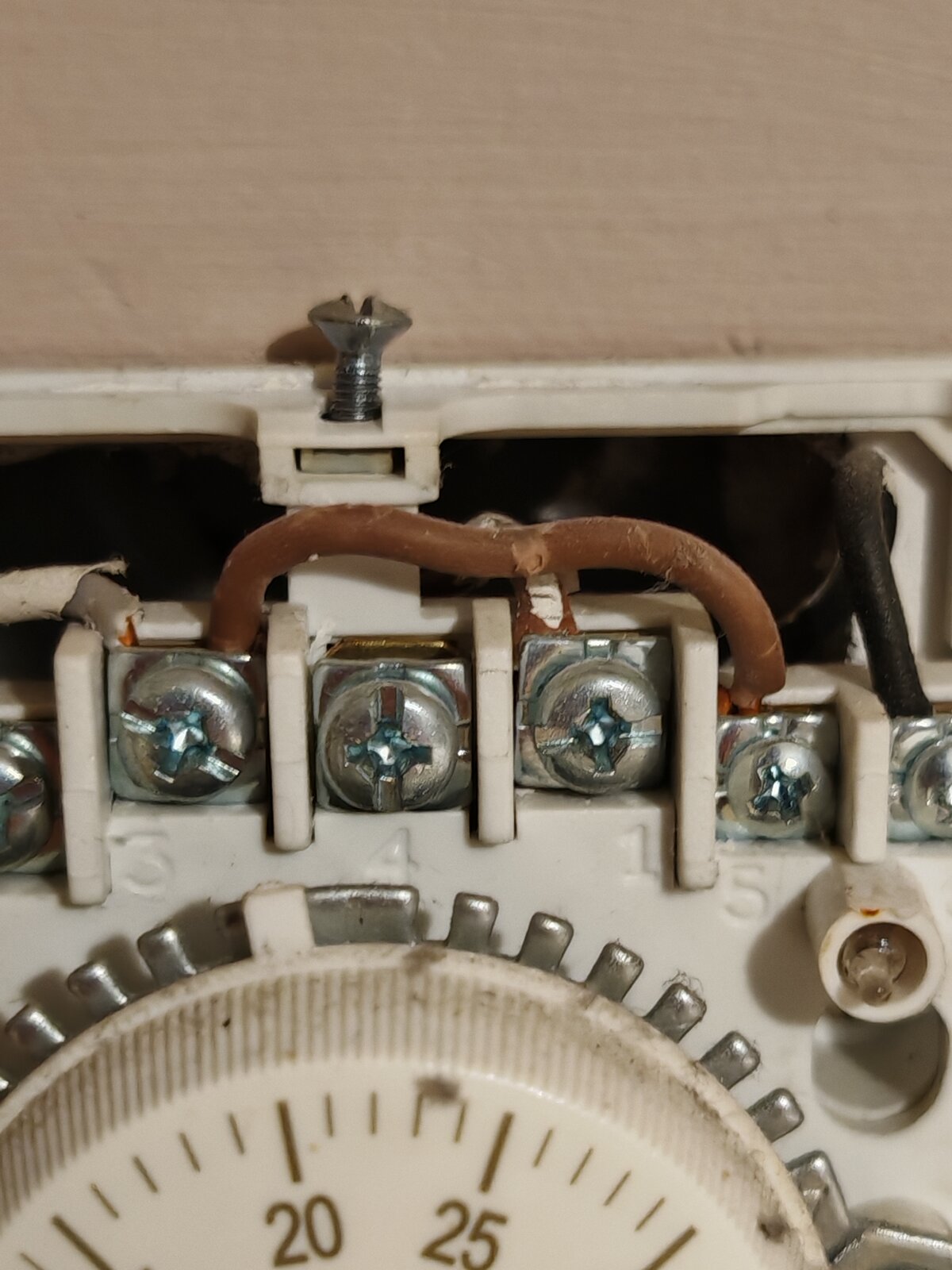

I didn't get around to doing this but it then turned out that one of the thermostats seems to have malfunctioned and given up the ghost this week. What's annoying about that is that it's preventing the heating from coming on at all on the second floor where I work so I do now need a solution.
Screwfix have the Tado V3+ Wireless Heating & Hot Water Smart Thermostat Starter Kit on offer for £85 so I'm wondering whether I can do what you suggested and replace the Timeguard programmer with the receiver that you get with this kit. Then you get one temperature sensor that would do the job of the wired thermostat (I'd need to buy another one separately to replace the second thermostat on the first floor).
What's not clear is whether the Tado receiver can handle three channels (two heating zones and the hot water) in the same way the Timeguard does. And then if it does, is it an issue if I still have the old thermostats wired in? Will the Tado receiver/programmer just bypass them and communicate only with the wireless temperature sensors?
I've attached photos of the existing thermostats. This is the one that has given up the ghost. It's got three wires: white, black and brown.
