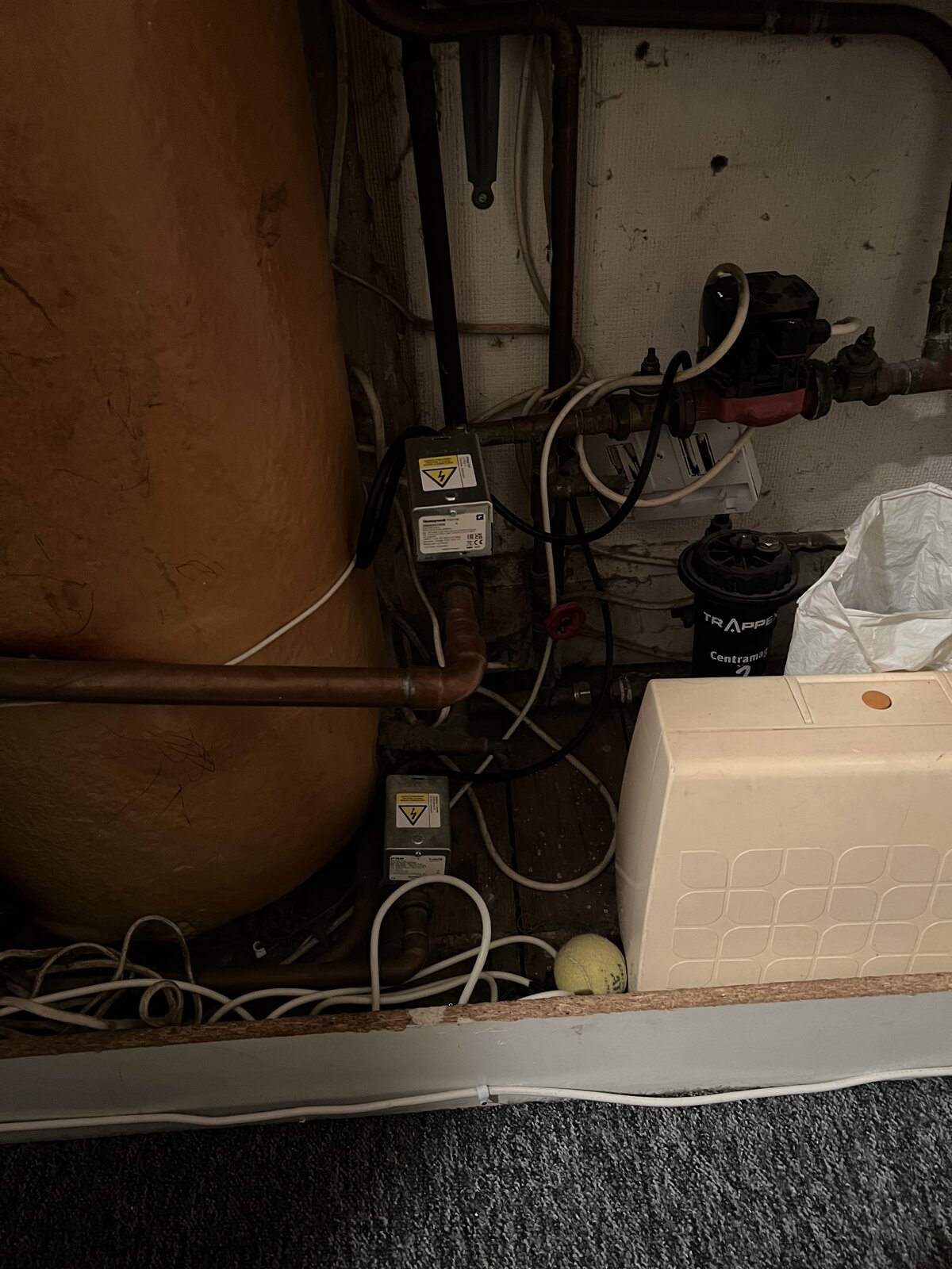

In my 3-bedroom semi-detached house, I currently have a conventional central heating system comprising of a:
- MAIN HE Condensing boiler (located in lounge)
- Honeywell programmer ST9400C (located in lounge beside boiler)
- Honeywell HCW80 (Y6630D1007) Battery Powered Wireless Room Thermostat (located in hallway)
- Honeywell relay/receiver HC60NG/R6660D (located in a bedroom cupboard beside the hot water tank, zone valves, and pump)
- a wiring box (located in the same bedroom cupboard where the hot water tank is)

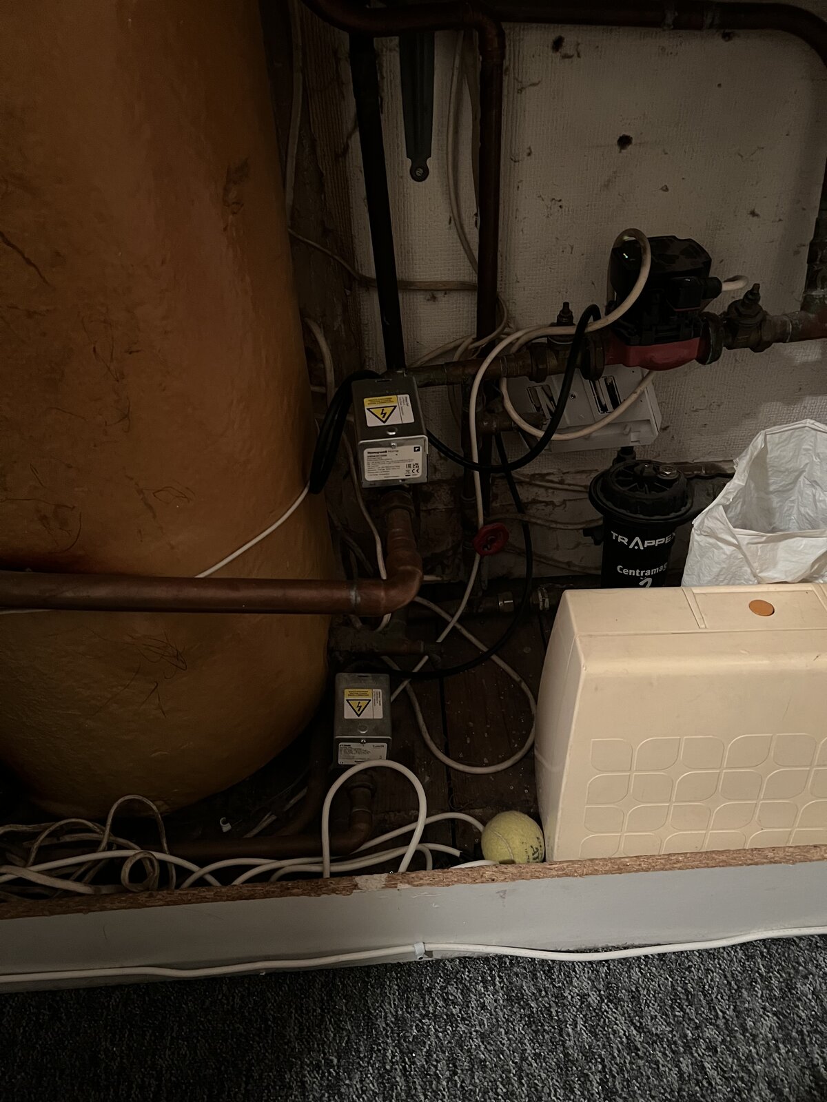

- I believe I have a S-Plan setup with 2 x 2-port motorised valves controlled by the room thermostat and hot water cylinder thermostat (photo attached)
I am looking to replace this with the Tado Wireless Smart Thermostat Starter Kit V3+ with Hot Water Control, or an alternative smart system so that I can control the central heating and hot water remotely.
Assuming the Tado Wireless Thermostat Starter Kit V3+ is compatible, is it fairly straight forward to remove the Honeywell set-up and replace it with the Tado system? I would like to do it myself but there are a fair amount of wires.

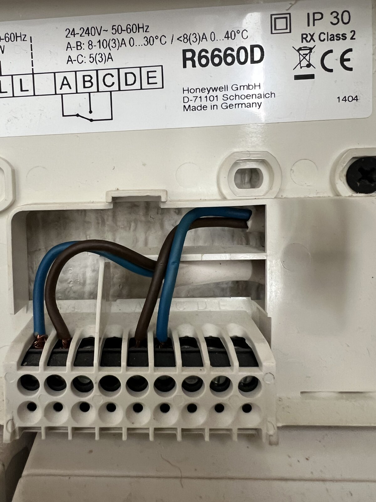

Yes, often it just replaces the programmer (ST9400C) and then you need to decommission the thermostat or set to maximum, but in your case for complete easiness, you could join the 2 switch wires in the receiver. If you wanted it out altogether we can help with that too.
thanks @Stuckinarut. From what I have researched, I think I need to:
  1. follow the instructions from the Tado app on how to wire the Tado v3+ wireless receiver using the wiring currently going to the Honeywell ST9400C programmer
  2. from the wire going to the Honeywell wireless receiver, to join the wire going to terminal A with the wire going to terminal B using a Wago connector, which is what I think you are stating where you say "join the 2 switch wires in the receiver"
Does that seem about right?

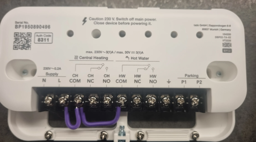

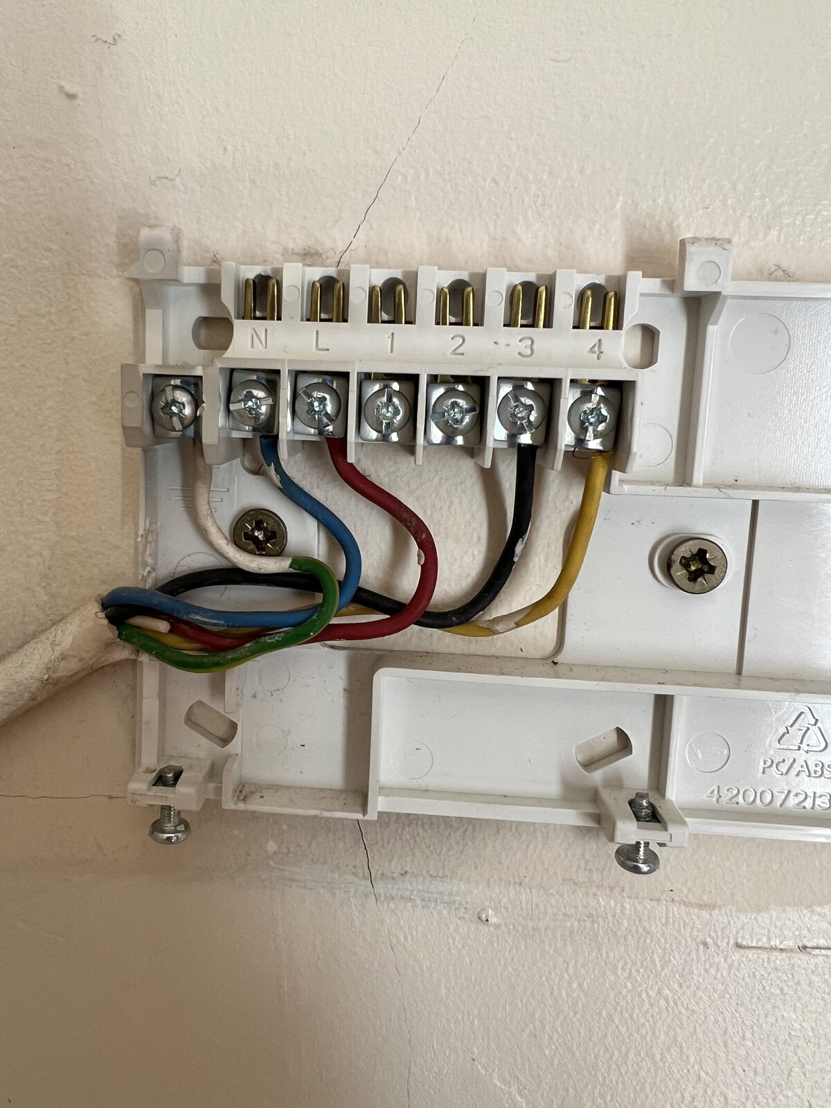

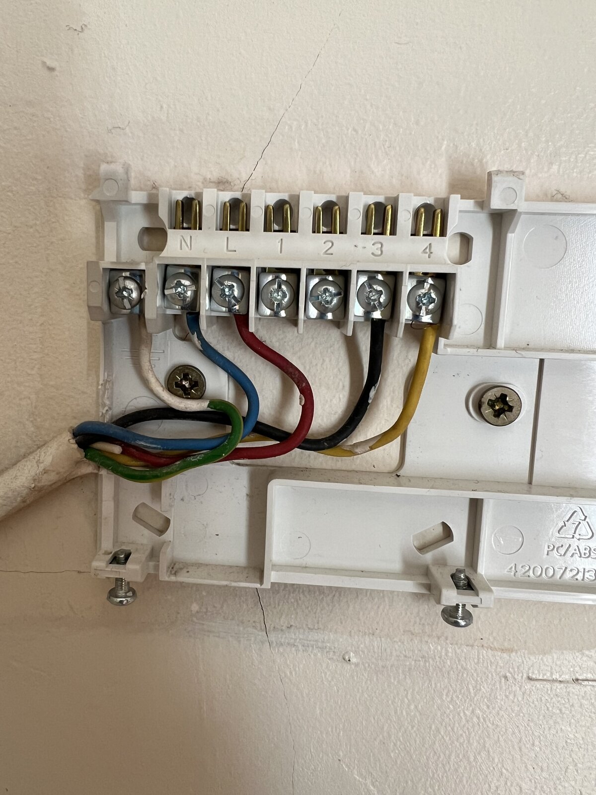

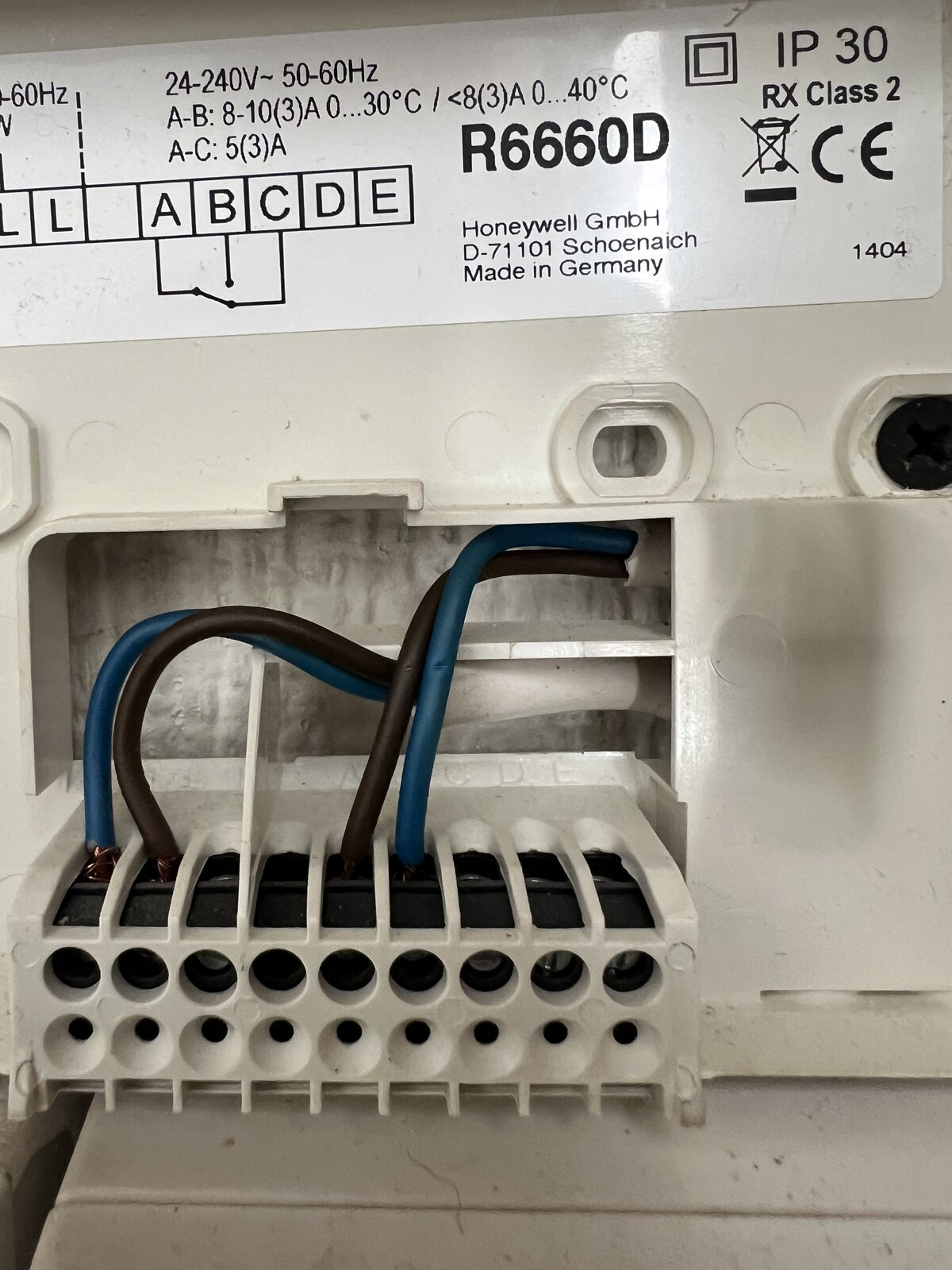

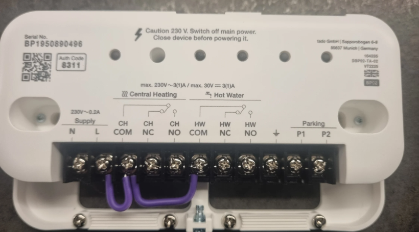

Just to follow up on this to ensure my wiring thoughts will work!
I have ordered the Tado Smart Wireless Thermostat V3+ Starter Kit so just wiating for it to arrive. This is to replace my existing Honeywell programmer ST9400C, Honeywell HCW80 (Y6630D1007) Battery Powered Wireless Room Thermostat, and Honeywell receiver HC60NG/R6660D.
I have removed the covers off the Honeywell Programmer ST9400C and the Honeywell receiver just so that I can see how these device are currently wired. I have attached photos of the wiring of these two devices. I have also attached a photo of the Tado extension kit which I found on google.
To correctly wire the Tado extension kit, am I right in the following:
  1. move N (blue wire on ST9400C) to N on Tado ?
  2. move L (red wire on ST9400C) to L on Tado ?
  3. move black wire on location 3 on ST9400C to HW NO on Tado ?
  4. move yellow wire on location 4 on ST9400C to CH NO on Tado ?
  5. move green/yellow (with a bit of white paint on tip of wire) from first location on ST9400C to the Tado ground point (between HW NO and Parking P1) ?
  6. The Tado extension kit photo already shows two purple link cables between L and CH COM, and between CH COM and HW COM - I assume I will need to make sure these links are in place when the extension kit arrives ?
On the Honeywell receiver, the photo shows the 4 wires. Do I:
  • disconnect the brown wire in A and the blue wire in B, and join them together with a Wago connector ?
  • do I leave the L and N wires as they are in the Honeywell receiver ?
