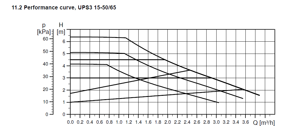

Since being the cupboard.... I was wondering what the correct setting is for my Grundfos ups3 15-50/65.
Looked up manual, currently on setting 3, there are other settings such as Proportional-pressure mode I, II Constant-pressure mode, I, II ?

You certainlt shouldn't need the default setting of CC 3 which is over 6M, I would try CC 1 which at over 4M will satisfy most requirements even with 8mm rad tails as long as the mains are 22MM, PP2 might work but unfortunately, as with most Grundfos pumps the head is on the low side especially with such a high capacity pump.

On a setting of CC3 (constant curve), the pump will circulate at a flow rate of 1.15m3/h (19.2LPM) at a pressure (head) of over 6M (6.4M) or if you prefer, 0.6bar, the pressure/head will then start falling with increasing demand or based on your pipe sizing, no of rads etc. CC1 only delivers these flow rates at a lower head of ~ 4M (4.1M).

Correct, it should more correctly be called the generated or differential head, its the difference in head between the pump discharge and suction, on a sealed system the expansion vessel is/should be installed close to the pump suction, if the expansion vessel is say at 1.5bar pressure then the above pump discharge pressure will be 1.5+0.6, 2.1bar but the generated head is still only, 2.1-1.5, 0.6bar, 6M.
