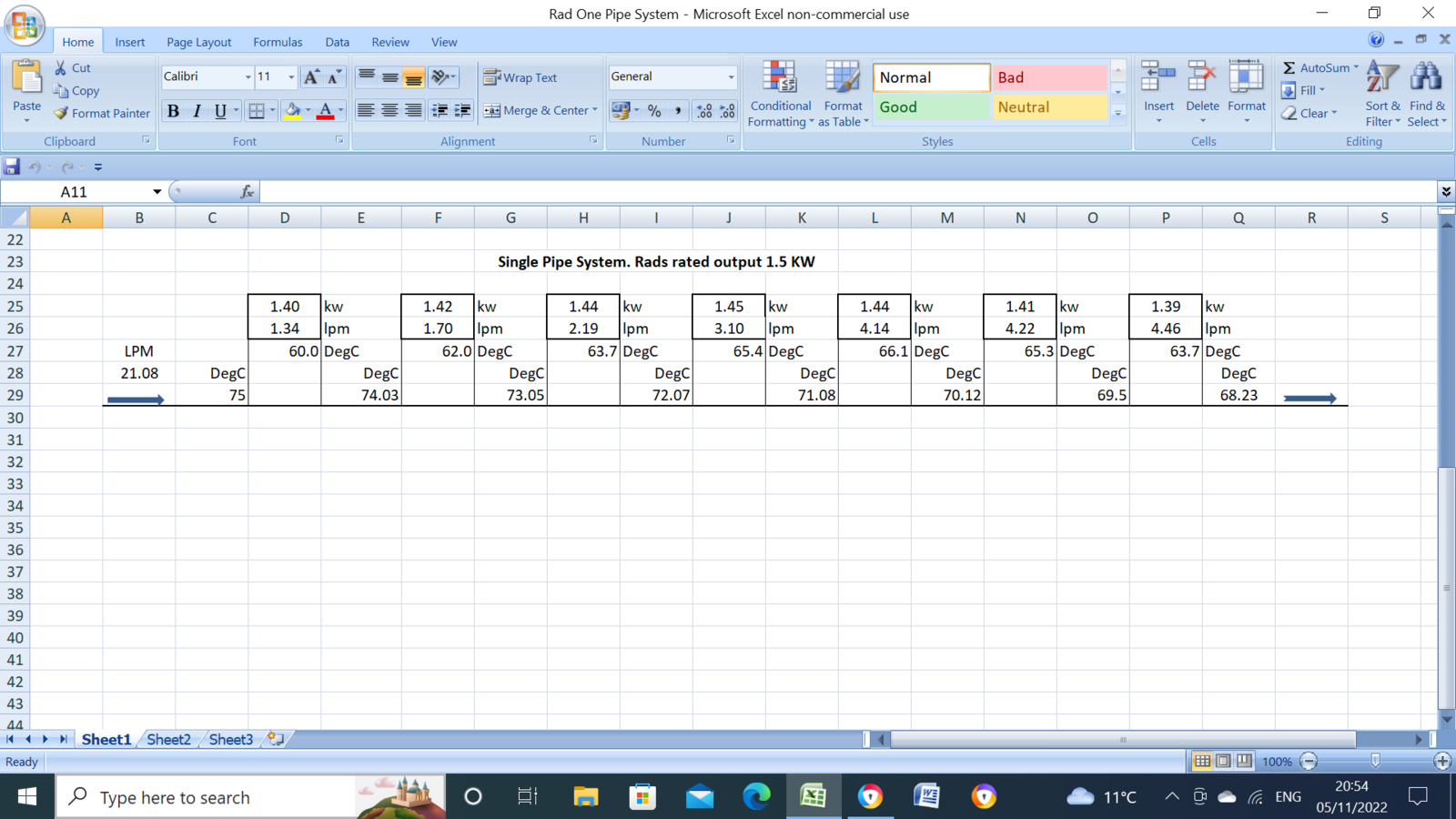

Your hybrid system will require much higher flowrates for the 7 one pipe rads but for the moment assume the whole 11 are 2 pipe and say the 11rads output is 16.5kw total (1.5kw/rad), a flow rate of 1LPM/kw will give a dT of 15C, so total flowrate required 16.5LPM or almost 1.0m3/hr. PP2 will circulate that at a pump head of 2.4M which I doubt very much will be sufficient except you have very large flow/return piping,
I would suggest CP1 at the very least (3M pump head) but would think that CP2 at 4.5M head would be a good choice and will work perfectly well with 2 pipe radiator systems.
Just came across some calcs I did years ago but not as far back as the last one pipe system I encountered which was in "college" over 60 years ago, I can't remember how hot the cast iron rads were but the one pipe(s) were certainly roasting.
Your system might look something like below, let us know how you get on after balancing them.
Interesting chart, and I suspect that's representative in my case. I can tell that last two radiators on the one pipe loop (Hall & Dining Room) aren't quite as hot as the earlier ones, and they are also the biggest but they still heat up their respective areas well enough. It's a 1960's house with a ground and first floor, and the ceilings are quite low, so not a big head.
All in all, the system actually works fine. I had intended to replumb it as a two pipe when I moved in 25 years ago but after using it for the first winter I found it worked well, so apart from replacing the boiler ( Baxi Solo III, non condensing) and converting it to a fully pumped system with a motorised valve and adding TRV's it has stayed as it was.
With regard to balancing, all of the lockshields on the one pipe rads are actually fully open, which I did because the pumped flow through the one pipe loop is constant all of the way around the loop. The two pipe radiators were added with an extension in 2006 and their lockshields are just open slightly, not sure how much, as it's 16 years since it was set up and I've never had a reason to readjust them, but I seem to remember they are all about the same with the excpetion of the downstairs loo which is just cracked open as little as possible as it's just a small towel rail and only needs a tiny flow to heat it up.
