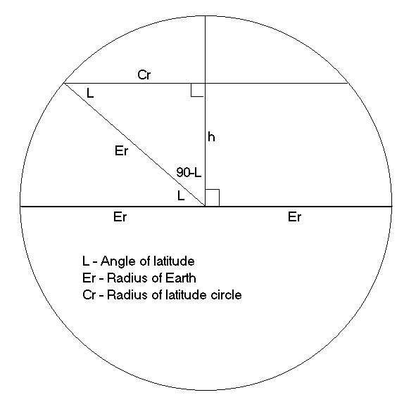

Perhaps you can find it from this:

Have you not got that the wrong way round?
The latitude lines are always the same distance apart (ignoring the oblateness of the Earth), that is one degree is 1/360 of the circumference of the Earth; it is the longtidude lines which vary in distance apart depending on the latitude of your postion.
Taking the circumference of the Earth at the equator as 40,075km. (40,008 around the poles) then one degree of latitude is 111.32km. This is the same as one degree of latitude at the equator but which reduces to zero at the poles.
To determine the distance apart of one degree of latitude at a given latitude you multiply that distance, 111.32km by the Cosine of the latitude angle.
This can be seen from my diagram above, where Cr is always Er x Cosine of L. (I called it C because it is a Chord of the circle)
Therefore the same applies to the circumferences of the two.
