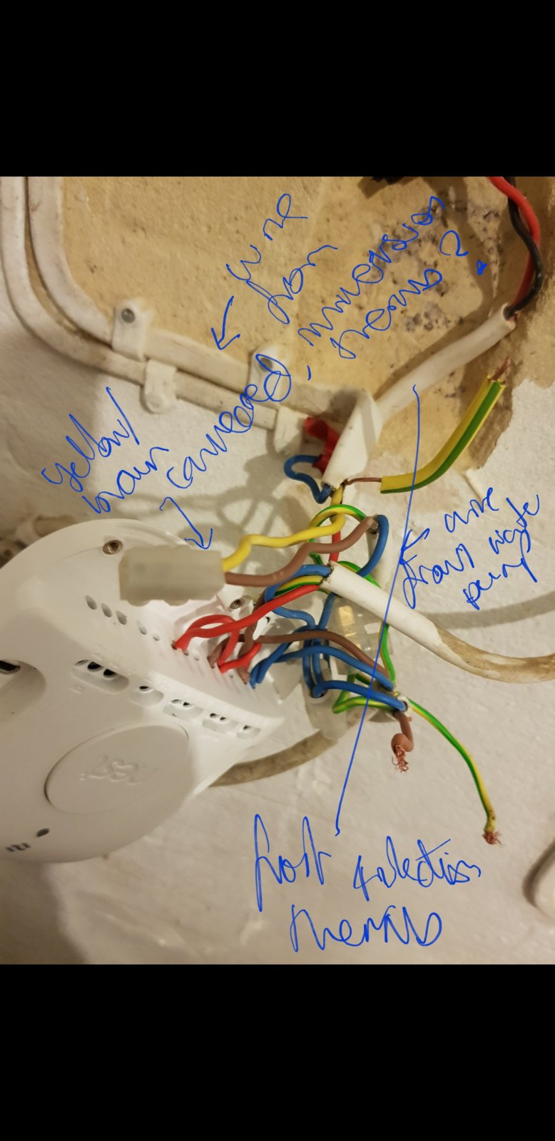

Equipment: grant 50/70 boiler was attached to a horstmann h21xl switch. No room thermostat. Timed on/off. Could only have heating on with water on.
Moved in six months ago and thought I'd update to a smart thermometer, because I'm a bit of a geek and like new shiny things, if if they aren't particularly useful.
So, swapped the horstmann over for a nest 3rd gen today. Used the old wiring diagram and the nest instructions to try to do the job.
Only didn't go to well. Strangely the central heating side now appears to be working independently to the water heating side. But the water heater does not work:the boiler does not fire up.

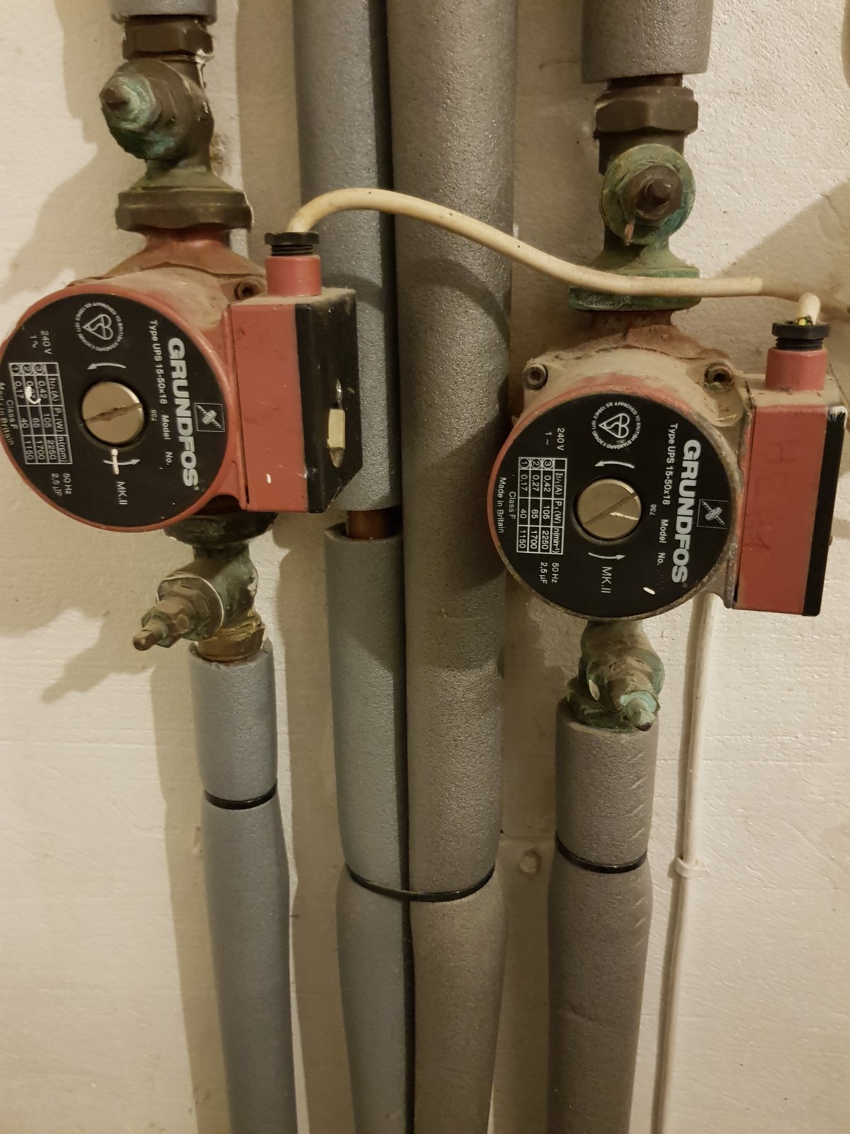

I appear to have pumps for both sides of the system. There is an immersion heater upstairs, with a thermostat. This seems to feed into the wiring from the water side pump (please see photo). The yellow wire from the immersion thermostat is it seems attached to the brown wire from the water pump. The red wire from upstairs is then fed into 6, call for hot water.
Forgive the state of the wiring-this off course will be tidied up once the system appears to be working properly.
Can anyone give me advice as to why my water heating system is not working. I also presume I have to remove in any case this immersion heater thermostat?

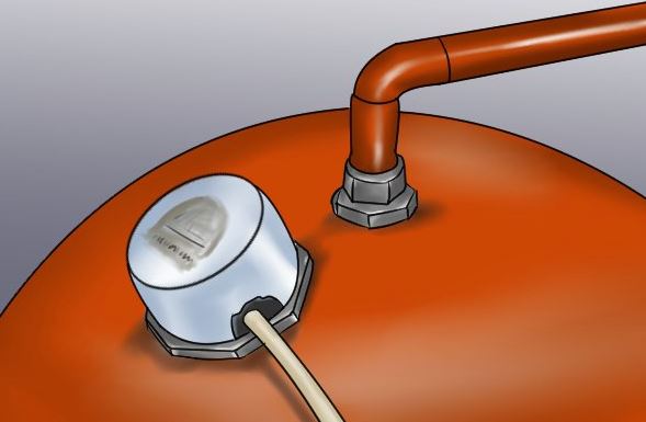

First of all, an immersion heater has nothing to do with the boiler. It is a totally separate item that heats up the hot water cylinder (generally as a back up in the case of failure of the main heating system) electrically using a 3Kw (13A) electric heating element. It should never be wired to a Nest. The Nest is designed to handle a maximum of 3A. If you were to put 13A through it you will damage it.

The Nest is really designed for heating systems with motorised valves (you don't mention any, so I assume you don't have them) that can control of the water flow to the heating and hot water, as well as having internal microswitches that allow both to control the boiler independently. Pumps on their own do not have that facility.

Yes I appreciate that the immersion heater can be heated separately from the boiler. I was just mentioning that there is a thermostat on the water tank that appears to be wired into the water grundfos. I was suspecting that this link would need to be removed.
I have wired up a few switches in the past, with good effect, so don't think I'm totally clueless. As I said the ch is working fine. It's just the call for hot water doesn't fire the boiler, and I'm not surprised as it appears the live to the grundfos is connected to the upstairs thermostat.

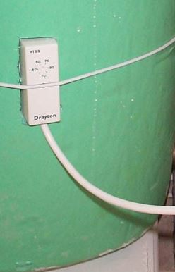

....and a hot water cylinder thermostat, which is a switch that controls the temperature of water stored in a hot water cylinder that is heated by a boiler.
So from what you say below, I'm now assuming that your original reference to an "immersion heater" was an error, and you actually meant a cylinder thermostat.
Regarding the above, the Nest provides time and temperature control of the central heating, but only time control of the hot water, so a hot water cylinder thermostat is still required to give control of the hot water temperature.
If I understand your post correctly, it appears that you maybe seriously considering removing a working cylinder thermostat leaving your hot water cycling continually without any temperature control and just wasting fuel.

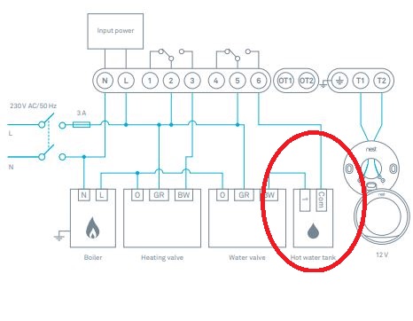

It features quite prominently in the Nest installation manual. S-Plan shown below.

Thanks for help. I tidied up the wiring and realise the link between 2 and 5 was broken. Replaced this wire. Now have cylinder thermostat in 6 as above, Essentially I have copied the old wiring from the Horstmann to the heatlink allowing for the different terminals.
Now everything seems to work. Can have heating on independent of hot water and vice versa, or both simultaneously.
