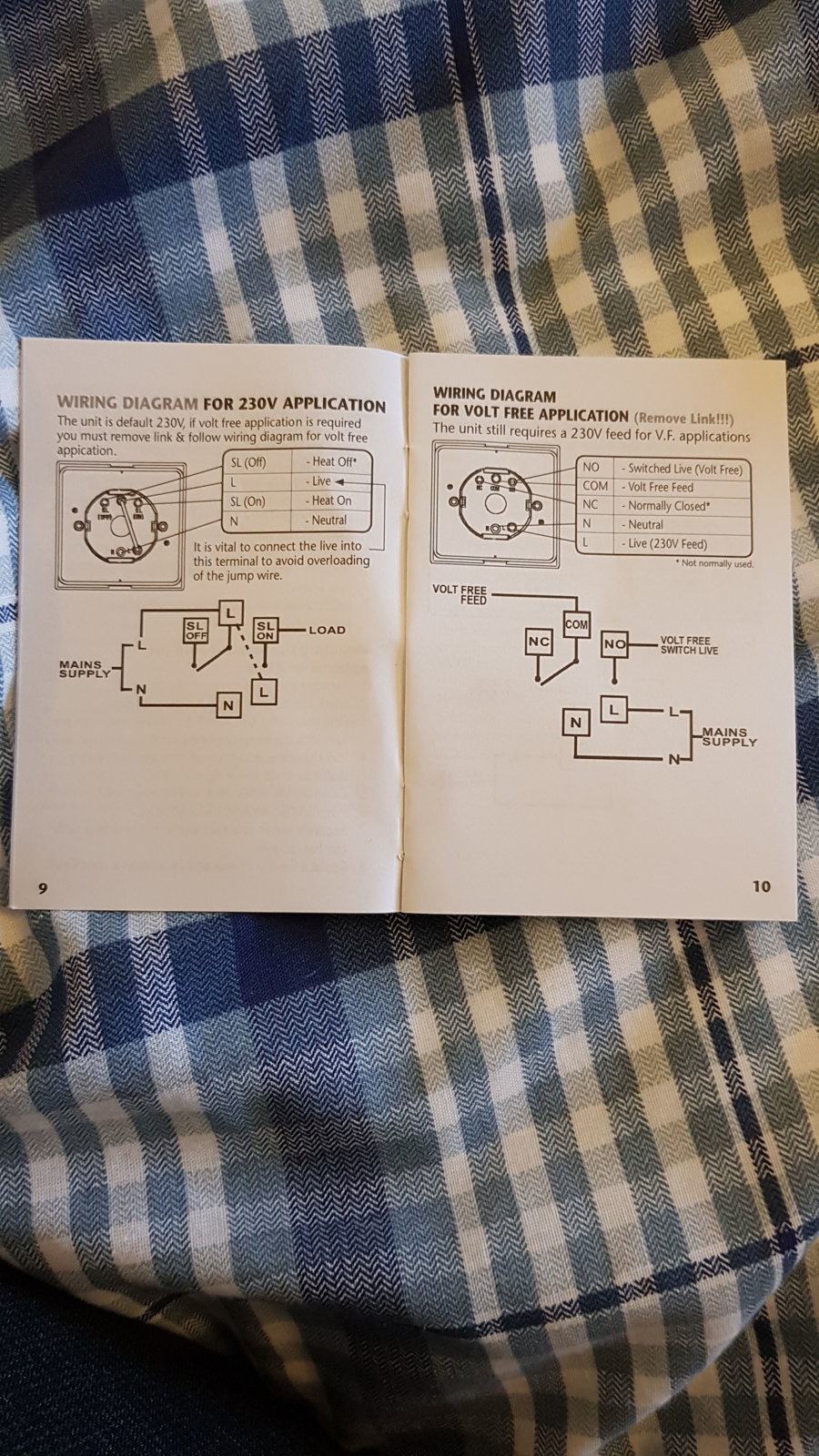

Hi all
Firstly my apologies for asking a question which has roba my been answered a million times, however when trying to find an answer that relates to yours, all the different wire colours start to blend together lol.
I am replacing the old dial room thermostat for a digital wireless jobbie so I can move stat downstairs to regulate the heating system better.

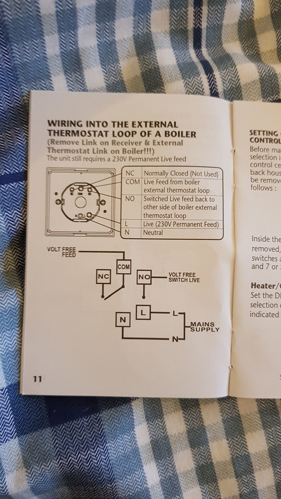

Could someone please confirm which wires go into the new positions, and also which wiring diagram to follow, the 230v application, or wiring to the external thermostat loop of a boiler.....
Thanks in advance all

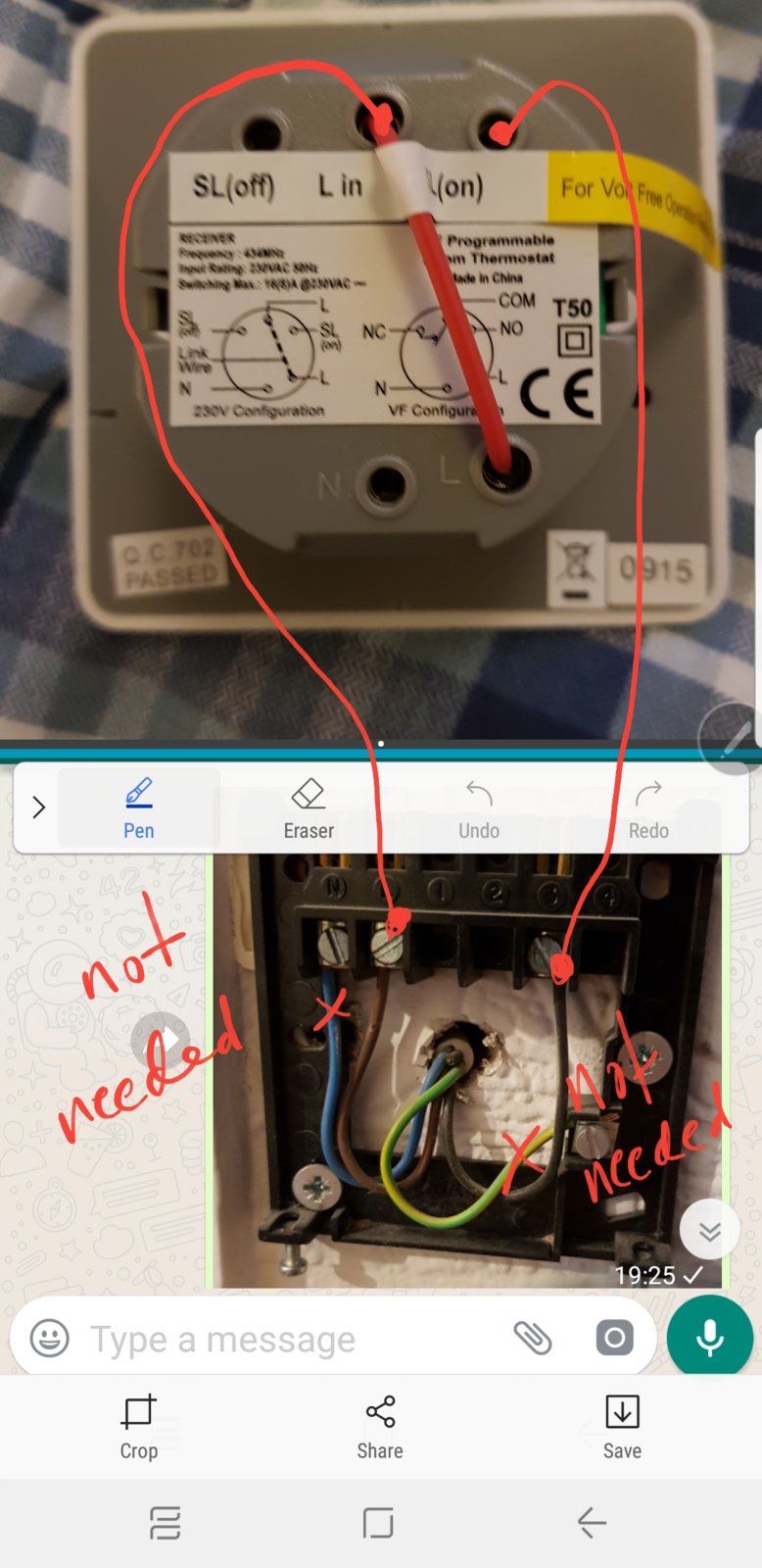

Is this right? Trying to get my head around this

nope you are miles off, start by saying what your existing Set up is and what you want to replace it with and @stem will tell you what to do

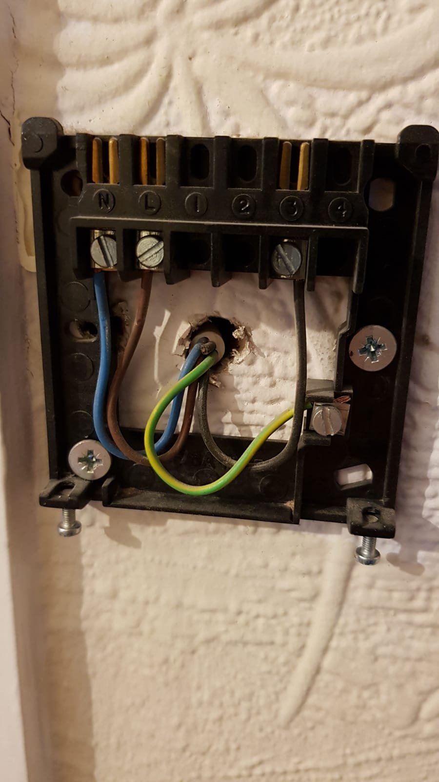

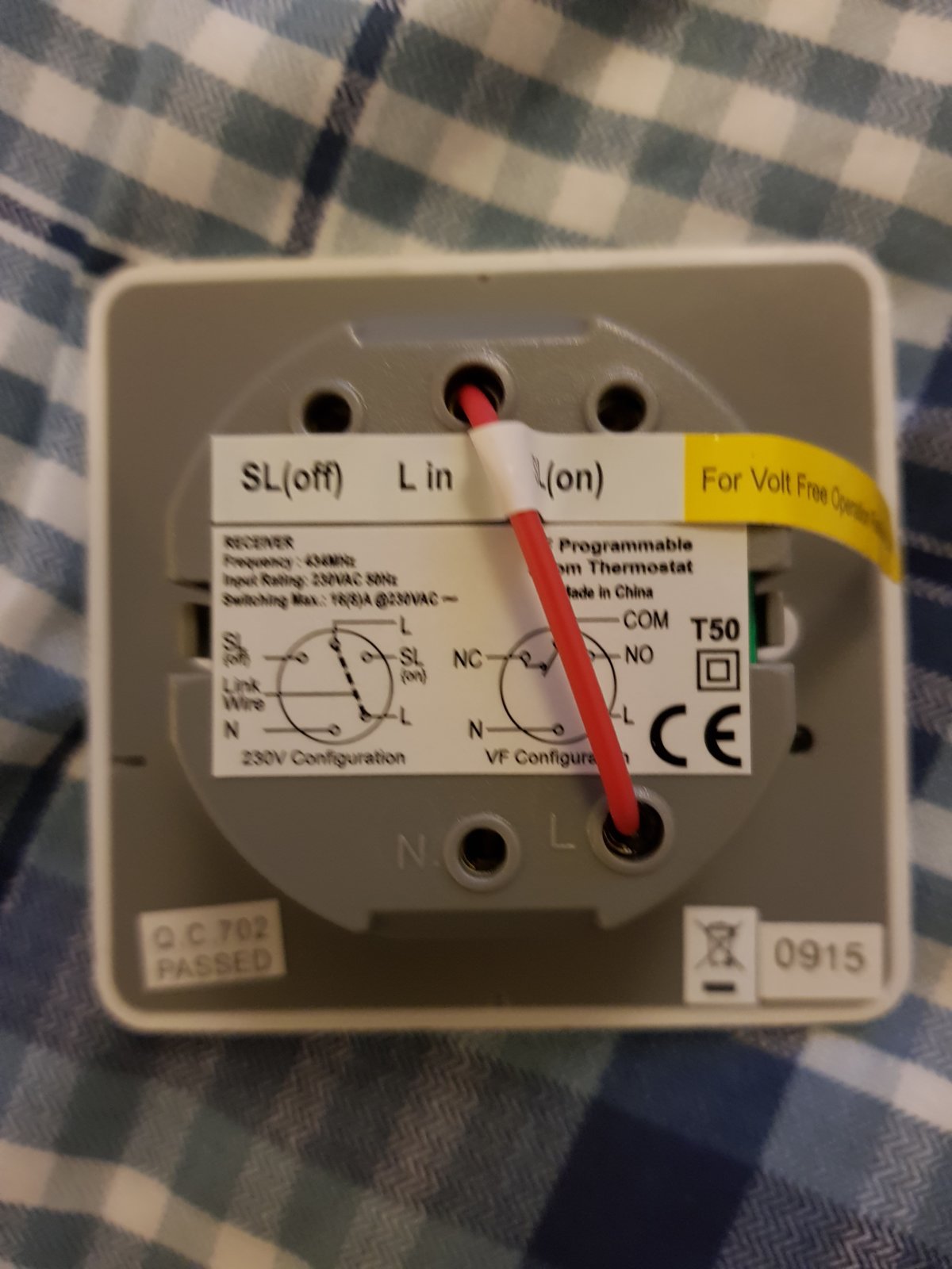

Leave link in place L to L, N to N and 3 to SL normally open or heat on.

So my sketch is right with the exception of adding the neutral into the neutral then?
I read that neutral wasn't needed....but seems strange if there's a slot there for it

You need the Neutral connected. Use the 230V diagram. It needs the N + L to power the stat. It then uses the link wire to send the Live down to the stat's Live to power the stat, without the Neutral the stat won't power up. When calling for heat it switches the L (switched live) on the top over to the black wire sending the power to the boiler.

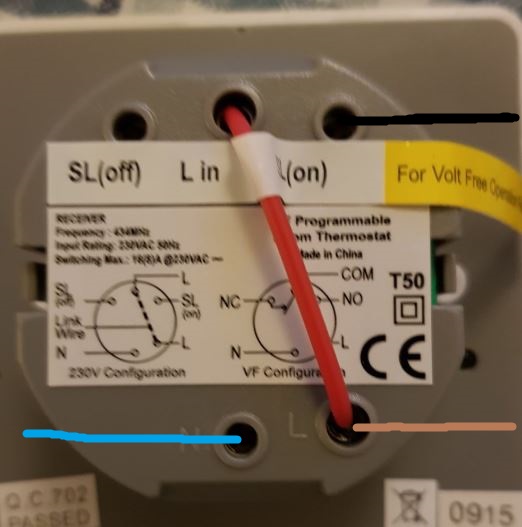

I can't tell what colour the existing wire in terminal 3 is, so I've shown it black.

And terminal 3 is black with a yellow stripe running through it

@StuB78 - the live from the wall wiring goes to (L in) - not into the L terminal at the bottom - This is to stop the link wire from being overloaded in case the live draw to the boiler exceeds the link wire capacity..- It specifically mentions that in the 230V instructions!!
The brown live from the wall wiring goes to the L in at the top - the link wire then sends current to the bottom L terminal to power the stat
The blue goes to the N terminal at the bottom for the stat
The black wire will go into SL (on) to go to the boiler
In the UK, the boiler's fused spur will have a 3A fuse fitted, so there's no chance of overloading the link. It's probably thicker than the black supply wire that will be going to it anyway. @StuB78, if you want to wire the black wire to 'Lin' instead of 'L' as Madrab says, then that's fine. From an electrical circuit point of view, as both terminals are connected together anyway it's the same thing.
Wasn't a ping at the advice @stem, should have pointed that out ... apologies ... certainly agree that the link should easily take the current across it, it's more a point of if there's any issues and/or there isn't a 3A fuse in there ..... as long as the MI has been followed ..... then it sits with them.
