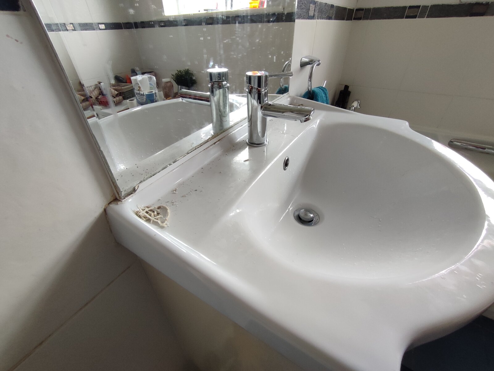

Any ideas on how to remove this basin?

It doesn't seem to be fixed to the wall, but it does seem firmly fixed to this mirror! I'm afraid I'll take the mirror with it if I try and pull it out with too much force, and I'd like to avoid that.
Does it have a pedestal ? If not will be screws under outer edge and/or glued with silicon to wall. Patience and a long blade required .
It's on a vanity unit, no pedestal.
I'm 99% certain the basin isn't screwed to the wall. I really hope it's not siliconed! The mirror blocks access from the top and the vanity has very poor access underneath (which is why I need to remove it to begin with!)
The mirror will need to be removed, then you will find it is siliconed to the vanity unit.
