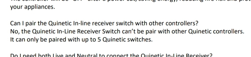

1) From the Quinetic Q&A sheet.
2) Doesn't look like they are WiFi units.
Other than ripping them out and replacing with normal switches I have no experience of these sort of devices. So I'm not in a position to comment on compatibility etc.

Also TimboTwo, it looks like you are saying I cannot pair a built in receiver switch with a built in receiver switch if I read that right which makes things very frustrating but I've had an idea that may work to get round this problem.
See if you think this would be a solution, there is more than one way with this but I'll pick one method, what if for the 2nd and first floor I used the 3 core and earth cables to extend the 1st floor switch line to the 2nd floor switch so that I have 2 switch lines at the 2nd floor switch. Then I fit a 2 gang Quinetic switch with receiver built in on the 2nd floor. On the 1st floor I fit an ordinary Quinetic 2 gang switch which I pair with the 2nd floor one. I would now have 2nd and 1st floor lighting controlled by Quinetics correct? (Note nothing would actually be wired to the ordinary Quinetic switch on the 1st floor, the switch would just sit in front of the existing wiring).
Now at the other end of the 1st floor landing I fit another ordinary Quinetic switch and pair one side with the 1st floor lighting and the other with the ground floor lighting Quinetic (with built in receiver) switch to be fitted on the ground floor. On the ground floor I use a 1 gang(with built in receiver) switch in place of the 2 gang switch which will control the ground floor lights and then get another 1 gang ordinary Quinetic switch which can just be stuck on the wall next to the built in receiver one and this one will pair with the first floor lighting.
In this way if you count I have a total of 3 gang built in receiver switches, basically 2 on the top floor and one on the ground floor. The 2 x 2 gang switches on the first floor are just ordinary Quinetic switches and are paired to suit and not wired to anything. Obviously now instead of having a 2 gang switch on the ground floor I have had to resort to 2 1 gang switches.
As I type it I realise it takes a bit of reading but hopefully you get what I am saying and can possibly improve on the idea.
